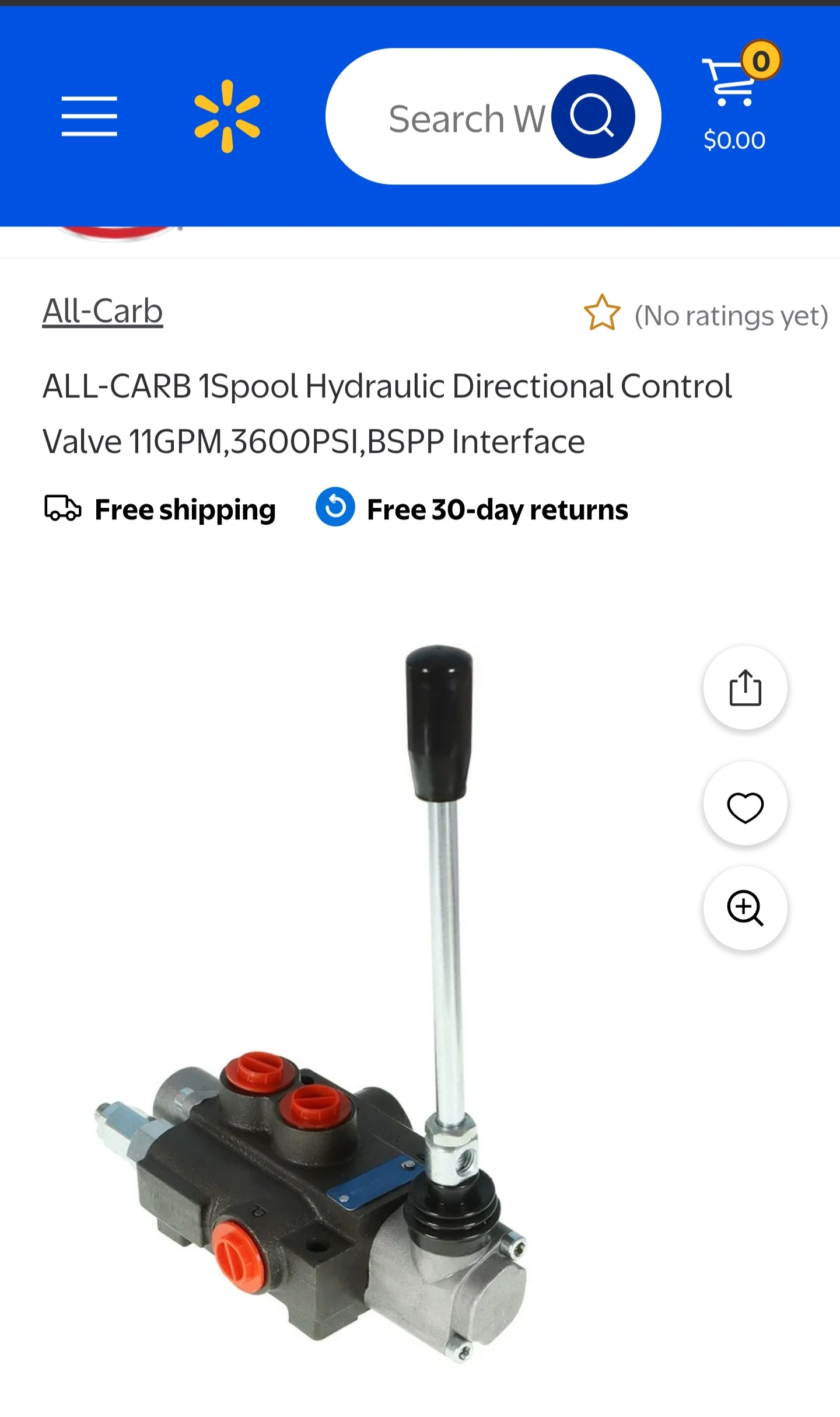

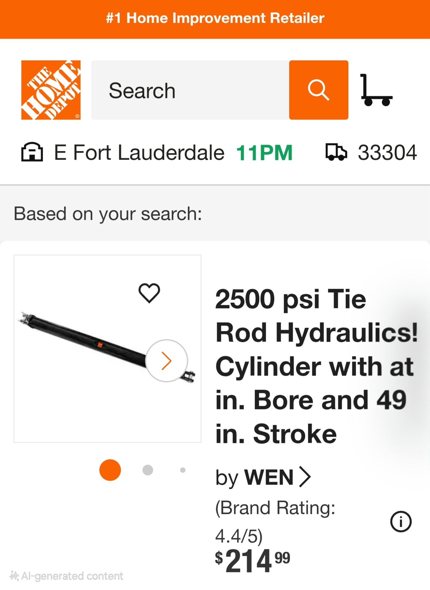

Soooo, I thought how about that sickle mower and ADDING a hydraulic lift so I could raise it as I approached saplings and blockages. First, my Kubota has no rear hydraulics but as I recall there are 1 or 2 capped off hyd lines behind the FEL hydraulic controls....maybe they can be extended to the rear. I found a single lever hyd control on-line AND I see many hydraulic cylinders available to raise/lower the cutter. The geometry is beyond me so a machine shop would have to be involved.

You could put a hydraulic cylinder on the mower to lift it, however it would not let it float.The best solution will probably be a cable setup that allows the sickle to float up and the hydraulic cylinder will pull on the cable. Also most 3pt sickles go over center and fold back on themselves. You will most likely want to prevent this from happening as you will have to get off the tractor to unfold it.

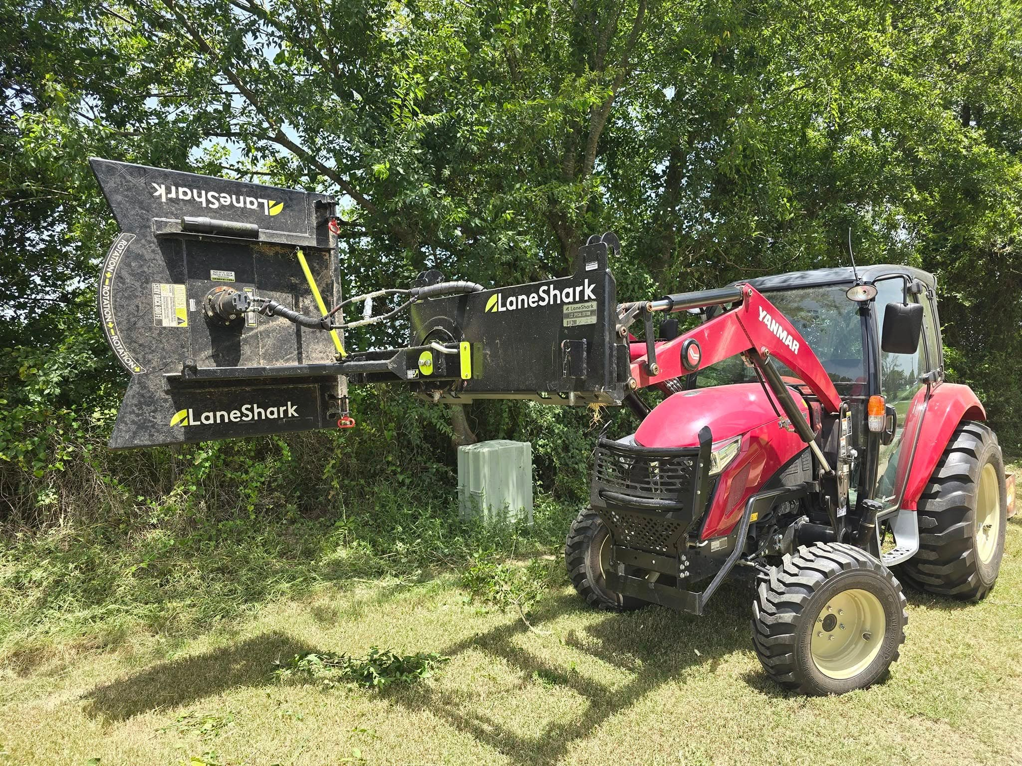

Some examples of units that might work for you.
Searching on craigslist and facebook marketplace for "skidsteer sickle" will normally also yield results.

3.) add a valve with a power beyond sleeve before the loader valve and feed the loader valve from the new valve. This requires a strong knowledge of the hydraulic system. The valve you have in a photo does not have power beyond and will not work.

So I provided you some bad information for your application. I am guessing your L3010 has a pinned on bucket that is not a skidsteer quick attach. If so then the idea of a skidsteer sickle will not work since it sounds like your fabrication skills are limited.
Will a "Skidsteer" unit attach/work on a 3pt tractor?
You might be able to find a rear sickle like the JD SB31 that only raises to 90 degrees. If a 3pt implement is how you decide to go.
