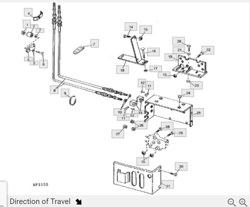

Looking to convert my lever controls on John Deere 2240 with 146 loader to joystick style. Anyone can guide me in the right direction on where to find info or parts to do so. Thanks

On the JD 245 Loader on my JD 2030 the valve mounts in a box on the loader mounting frame. The box has holes to mount the cables (outer) opposite the valve spools.
You could probably fabricate a mount for the cables to connect to your current valve.
