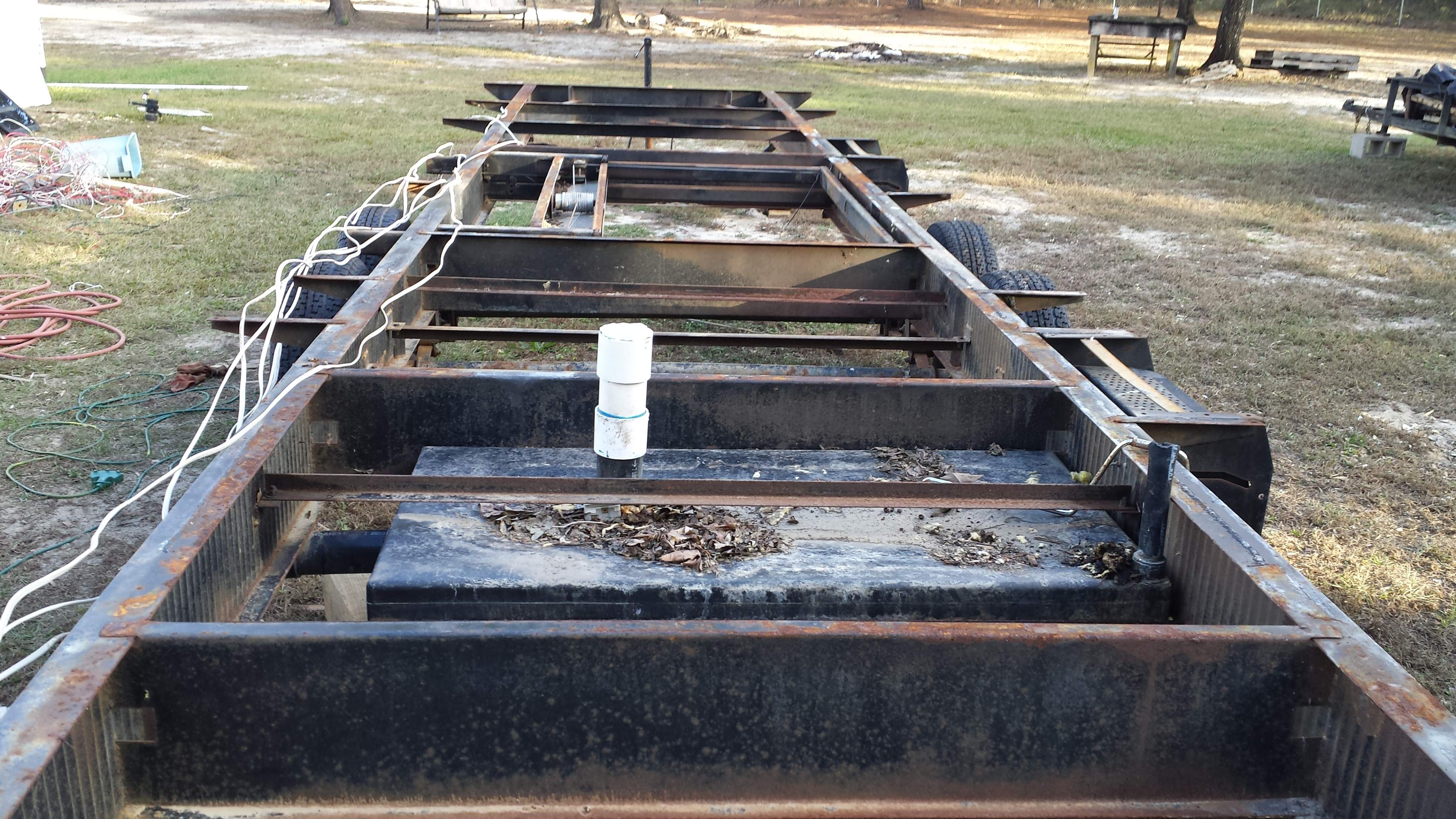

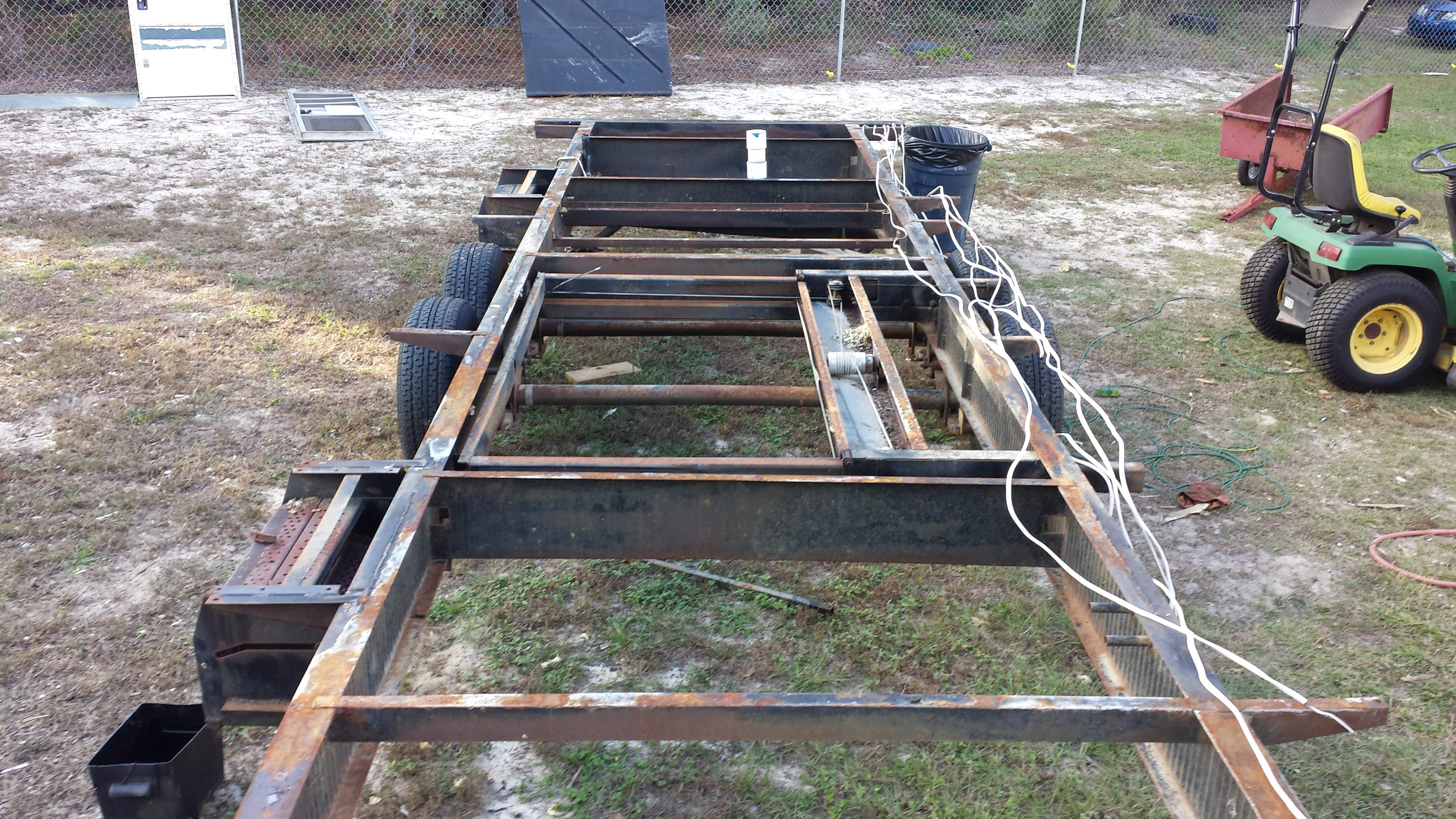

Ok, need expert advise. I've acquired a 31' travel trailer that had extensive water damage. I have stripped it down to the frame. It has 10" I-beam main beams, 4500lb axles with brakes on both and should fit the bill nicely for a tractor hauler, GVW is around 9k. I intend to weld up a square tubing frame on top after I add some reinforcement between the rails. So here is where I wanted some advice. Was thinking 2x2 3/16 or 1/4 for the framework, with rectangle on the outer perimeter that would act as board retention as well. Where the crossbeams extend beyond the main beams I plan to put a 45 degree reinforcement down to the bottom of the I-beams. I'm also planning to dovetail the last 5 feet by cutting a wedge out and heating and bending the beam, then cutting the angle and adding reinforcement as needed. For the angle was thinking 11 degrees or so. Am I on target for the size of the square tubing? Welding will be done either with a Lincoln tombstone or 180 wire feeder. Including the required pictures. Thanks everyone.

My only worry would be that many trailers and mobile homes seem to get part of their stiffness from the superstructure, since they often have lightweight metal in the frames, lighter than their size would suggest. I've seen some MH frames with about 10-12 inch I-beams that were less that 1/8 inch thick, and bare MH frames that won't even support their own weight without a sagging tail.
I've also seen some build with common structural steel shapes that looked much stronger.

You may want to add up the weights of the new steel and your intended load to make sure your not going to overload your donor chassis.
Other than that the axel placement looks like its pretty far back ( you will be limited as to how the weight of your load is placed in relation to the axels) which is going to stress that long front section of frame more than what the camper did and add a lot of tongue weight.

Most if all home built trailers like this end up way to heavy. I would start by weighing what you have, I bet it's nearly 2000# already. Then add in the steel and lumber and you will find its going to be tough to keep it under weight.
Axle placement is also important. On a utility trailer you want 65% of the deck forward of the axle center.

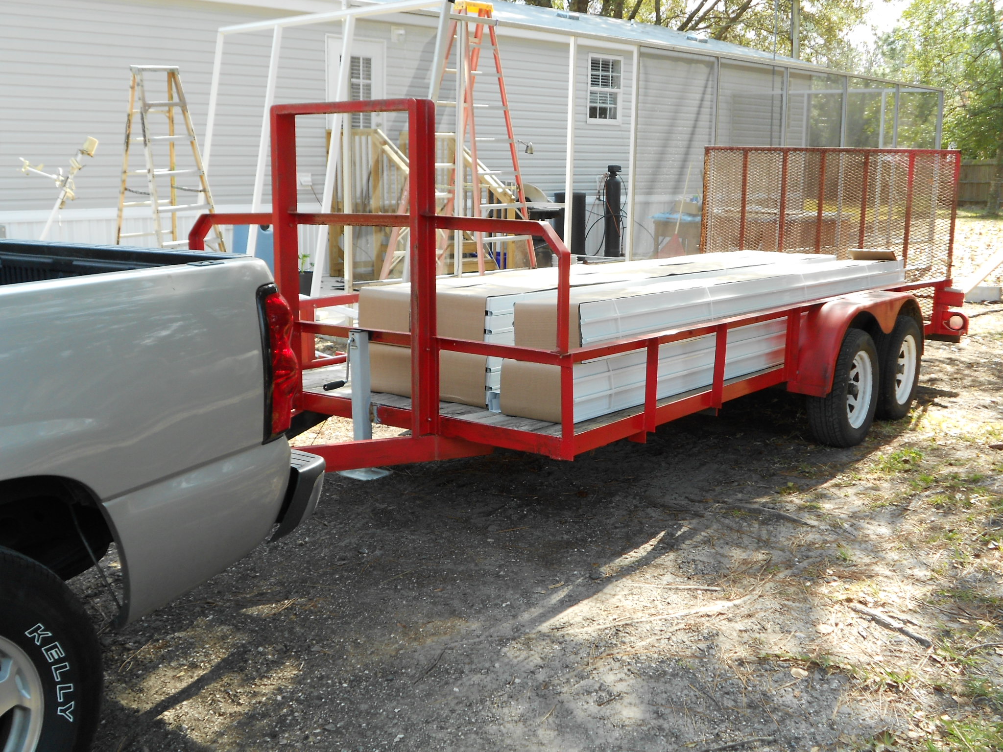

I have built dozens of trailers, Repaired semi trailers for over 30 years, supervised 3 shops.
What seems like a good idea really is not going to turn out too well for a number of reasons.
Just for starters, have you priced steel lately?
I bought the 16' trailer in the pic for $700. needing repair and spent less than $100. more on it including building the bulkhead for hauling appliances and tall stuff.
I can haul around 5000 lbs on this one which will handle my 3510 Branson with FEL and Backhoe.
It has electric brakes and tows like a dream!!
I see these trailers all the time on CL for under $1000. How much are you going to have just in materials?
I love a project but I think you are trying to make apple cider out of orange juice.
Sorry to be so negative but I have seen it tried/done before.
Stimw, I think your Branson 3510 with a loader is almost 5000 lbs, plus your backhoe, so you are pushing your maximum if those are 3500 lb axles. With an 8620 backhoe and filled tires, a Branson 3510TLB can push close to 7000 lbs. Trailer looks good.

I have also built a few trailers and repaired some too. I bought an old car hauler made from a travel trailer frame and converted it to a tractor hauler. I bought the car hauler for $200 and by the time I had bought lights, paint, some steel, and new tires I had $700 in it. That included getting the deck material for free. The bad news was that I had 15 to 20 hours of labor in it and when it was all done it still was pretty weak in the back and especially the corners due to the light weight tubing it was made from. I sold it for $1300 (it was big) and bought a nice factory made car hauler that pulls better and looks much better too.
My advice would be for you to sell the trailer frame as is for $200, find some easier way to make another $1000 and buy a trailer made for what you are going to use it for.
If you do decide to keep it, I would cut off the pieces that stick out the sides and make it as wide as the main beams. Also you should not need to put any tubing on top of the beams, just add stringers between them made from 3" junior channel.
