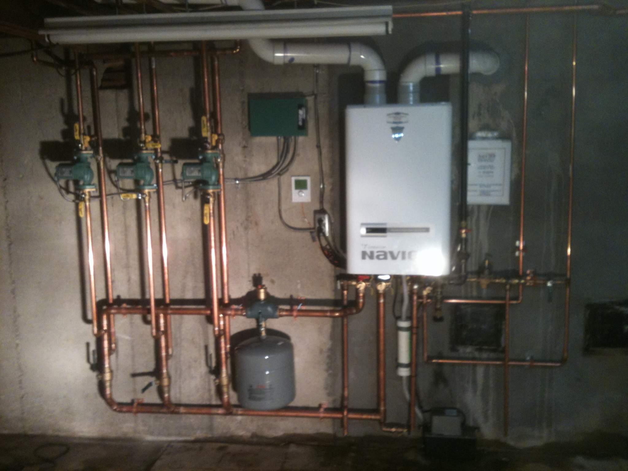

This past fall I needed to replace the 25 or 30 year old oil burner with a new unit. I decided on a high efficiency condensing gas boiler, it only cost a little bit more than the price a new oil burner and replacing the the original tank which was over 50 years old.
Boy do I like this unit, it mounts to the wall so it takes up very little space plus there is no oil tank in the basement any more.This unit makes hot water for the baseboard heating system and it makes domestic hot water.
Last winter it was costing me about 500 a month to heat 1200 square feet with oil, I just got my gas bill for the month of December, $117.76. Granted, this winter has not been quite as cold as last year but I am still very impressed.

That's an interesting installation. Are those separate pumps for each zone, and are they controlled by separate thermostats?
We had a gas-fired hot water system in our previous home. But there was only one pump with the zones controlled by separate thermostats and valves.
What is the name of the boiler? I can't make it out due to the glare.

The house has three heating zones so there are three circulating pumps, each zone is controlled by its own thermostat.
The unit is made by Navien
