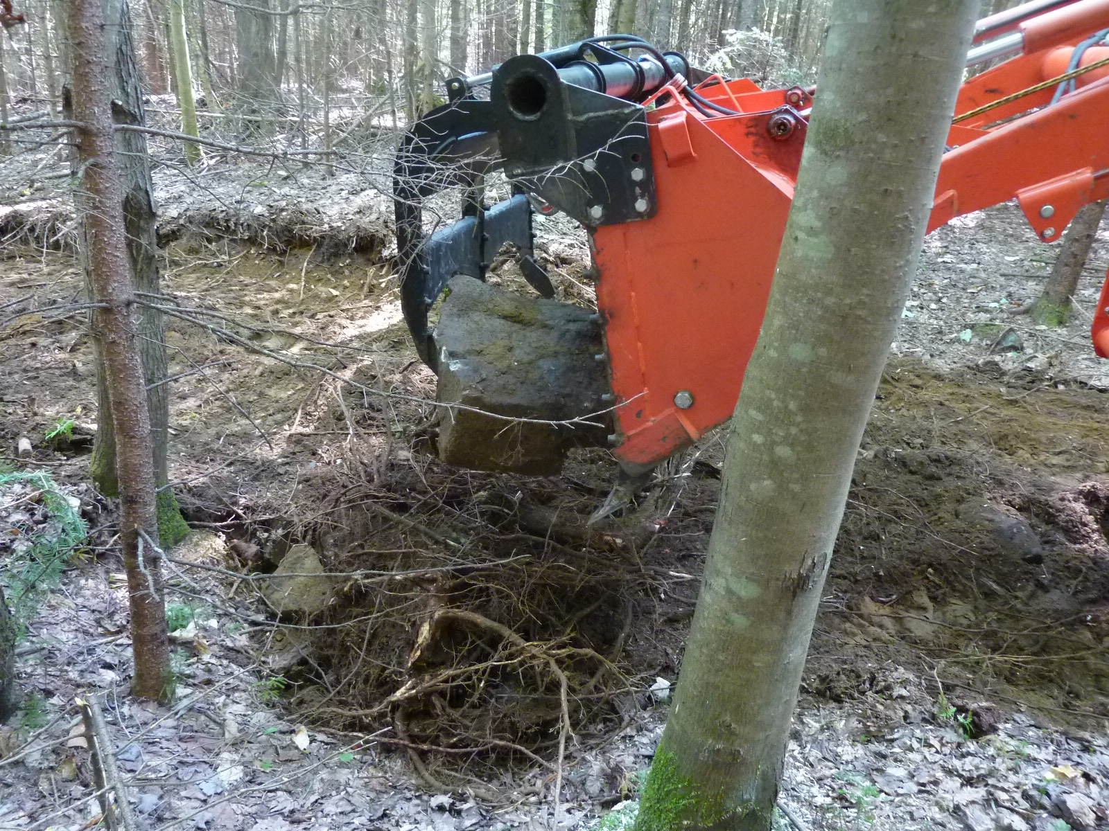

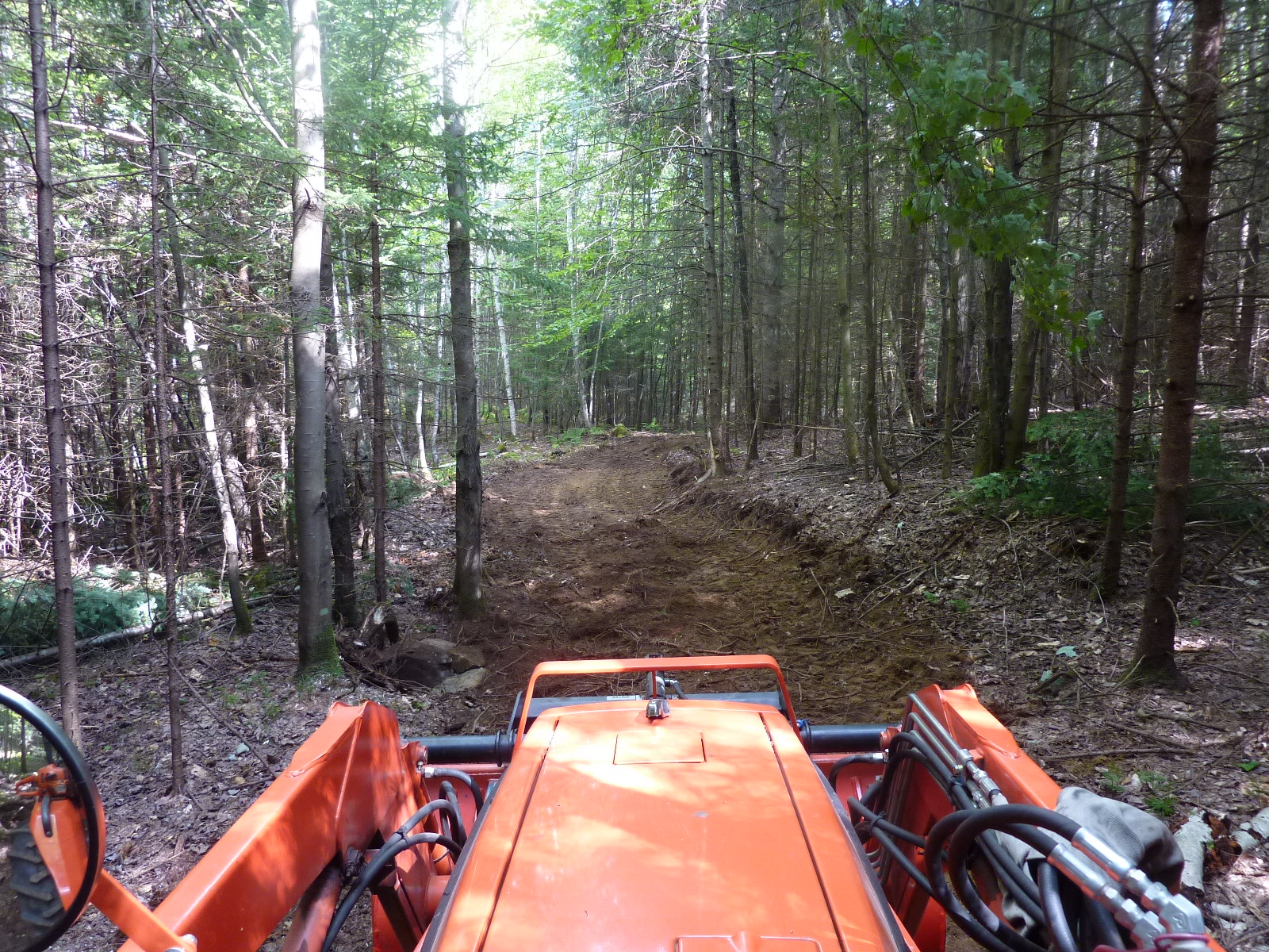

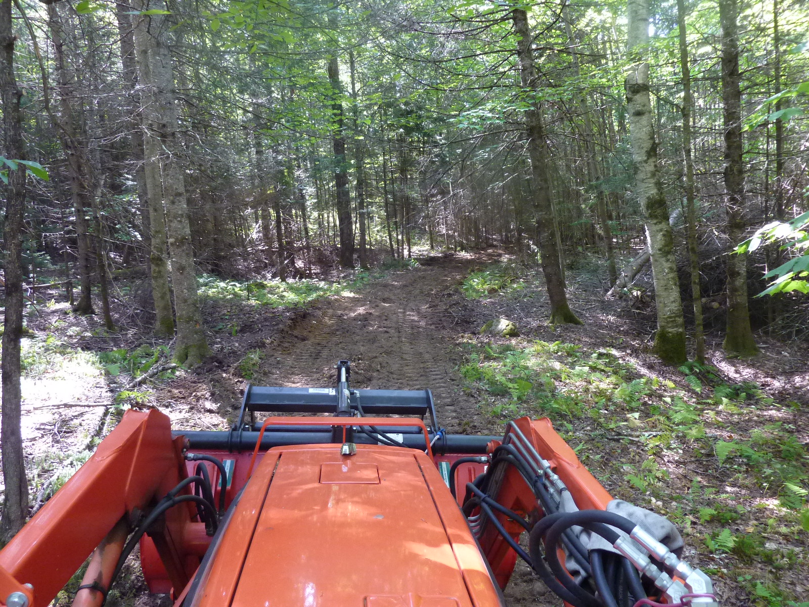

I spent most of the weekend doing this. This will be the second of two main skid roads for this winter.

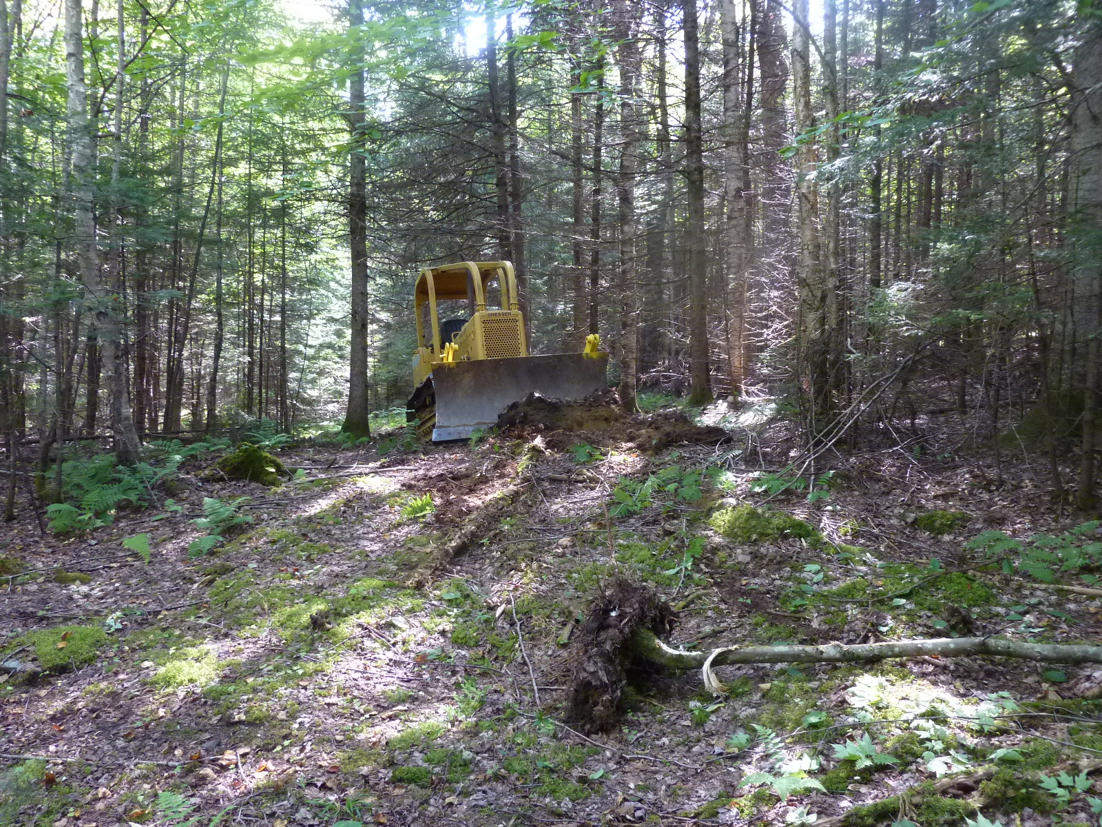

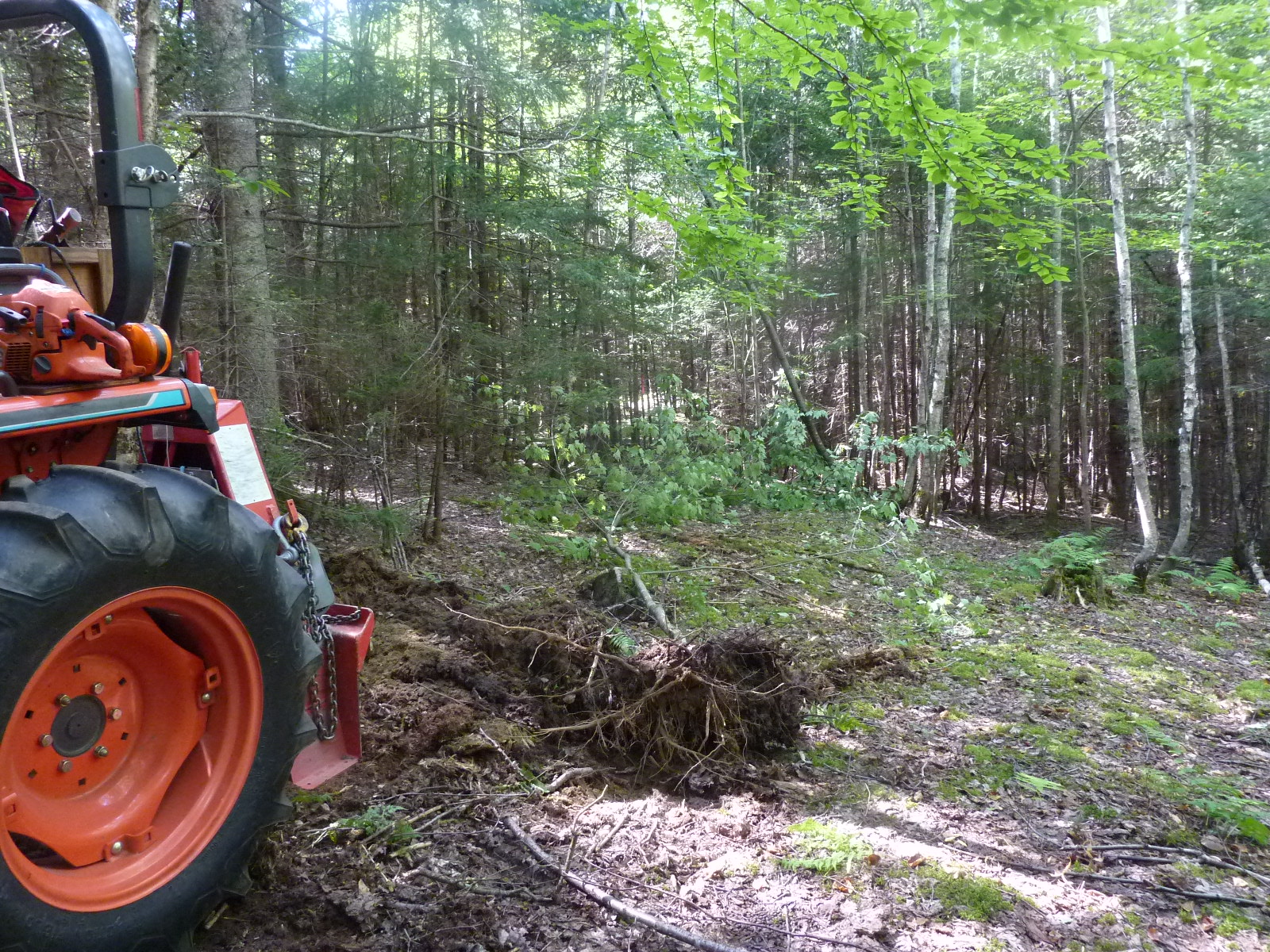

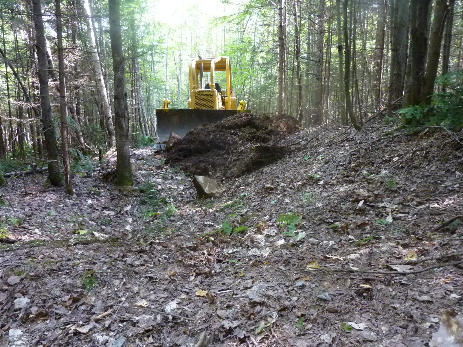

I played leap frog with the dozer and tractor thru the woods. The old skidder trail was grown in some. I cut it by hand and dragged the smaller stuff into to the woods. For the bigger stuff I set a snatch block back in the woods and used the winch to pull the trees off the trail. I don't like to pioneer with the dozer because I end up with a big twisted mess of logs, trees, stumps, roots, rocks, and dirt in front of the blade with no where to put it. Here is a section I cleared before and after photos.
After I had a swath cleared I used the dozer push out the rocks and any solid stumps and make a flat road. Some places were easy and some not so easy.
When I had a OK road I would get the tractor and move some rocks into low spots just off the edge of the road to sure it up.
Here are some shots moving along the road.

The dozer is a 1991 Dresser TD7G with a six way blade. It has a 70 hp air aspirated 239 Cummins and weighs about 15,000 lbs. I bought it pretty cheap with a under carriage in very poor condition but otherwise in good shape. Spent a year getting it ready for the woods.
The new trail is about 1/4 mile long. Shaped like an open horse shoe.

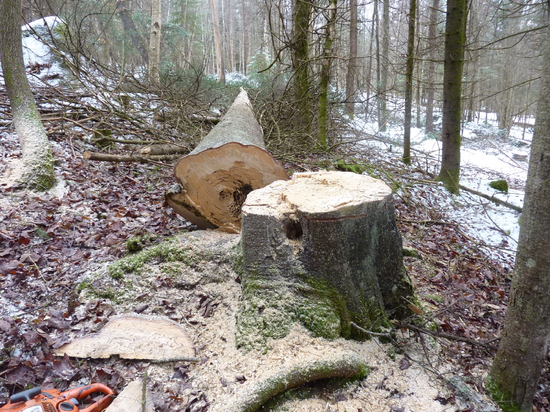

A big old fir - notice the pileated wood pecker hole. A sure sign of rot.
The rot is quite severe on this one.
After it is limbed.

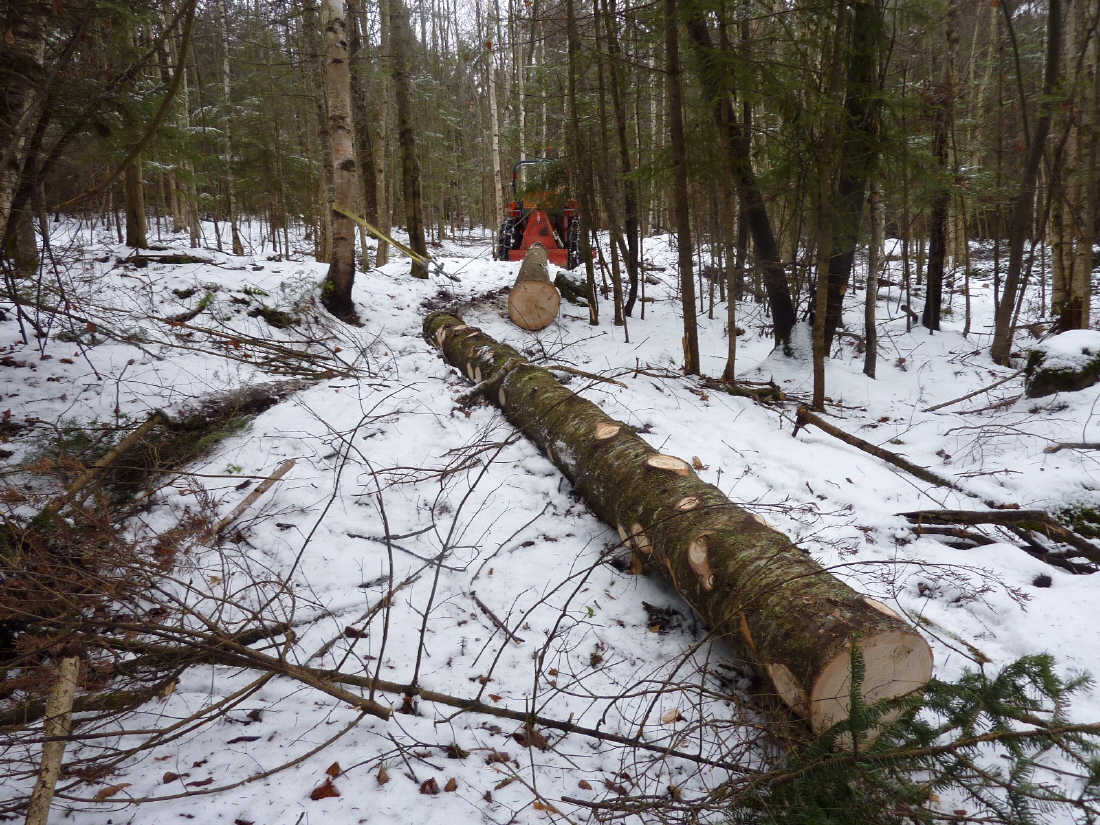

Then I start cutting the butt off to find solid wood. Made two cuts on this one and lost about 5 feet off the bottom log.
Then I winched it up to the trail. This one came easiest by cutting it in the middle and choking up both pieces at the cut. Also needed a snatch block.

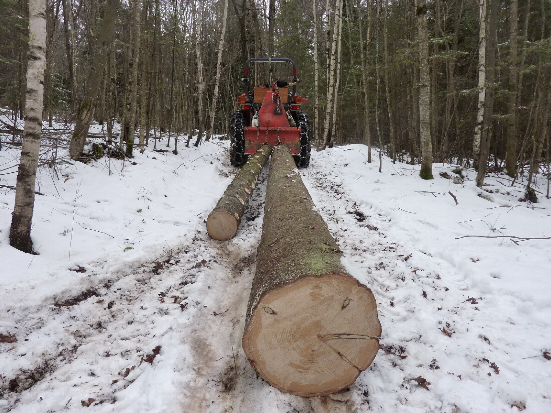

Skidding it up to the landing. You are looking at the big end and the small end. The mill takes 10', 12', 14' or 16' logs down to 6" on the small end.

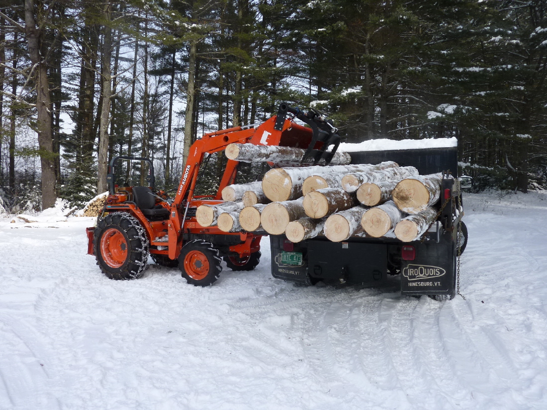

Up on the landing I buck the logs into 10 and 12 footers mostly and load the truck with about 500 board feet worth about $150 delivered to the mill.
