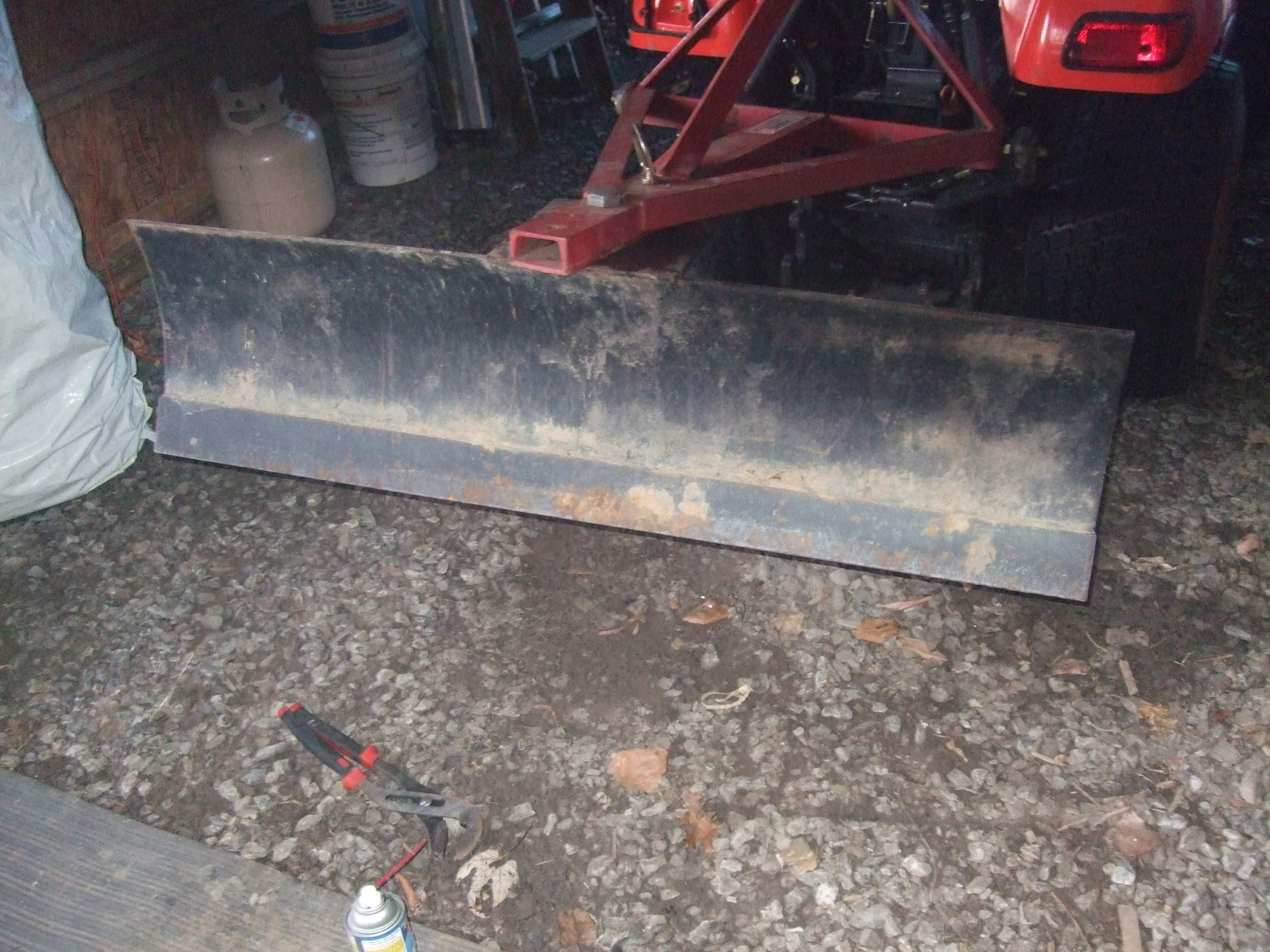

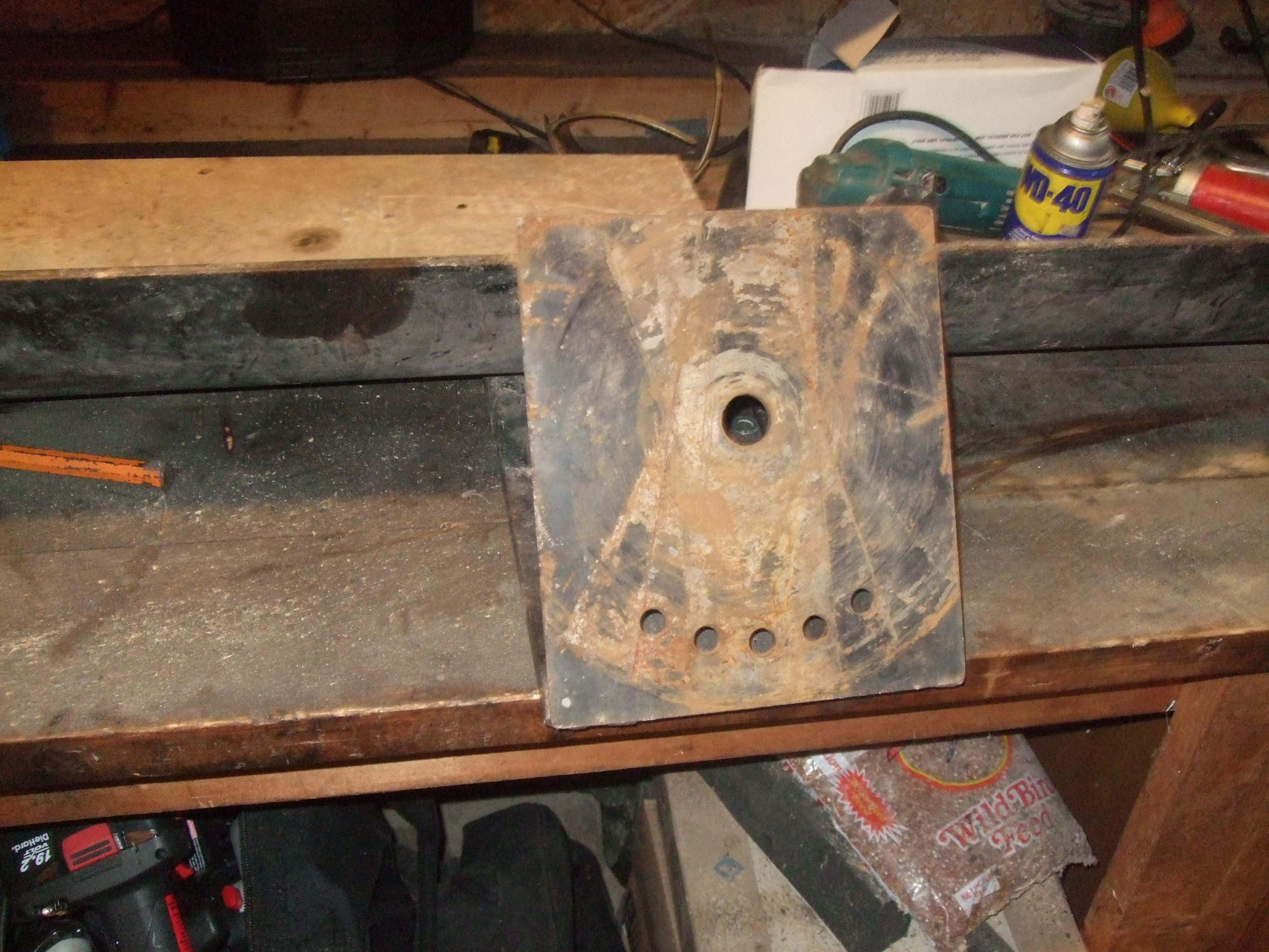

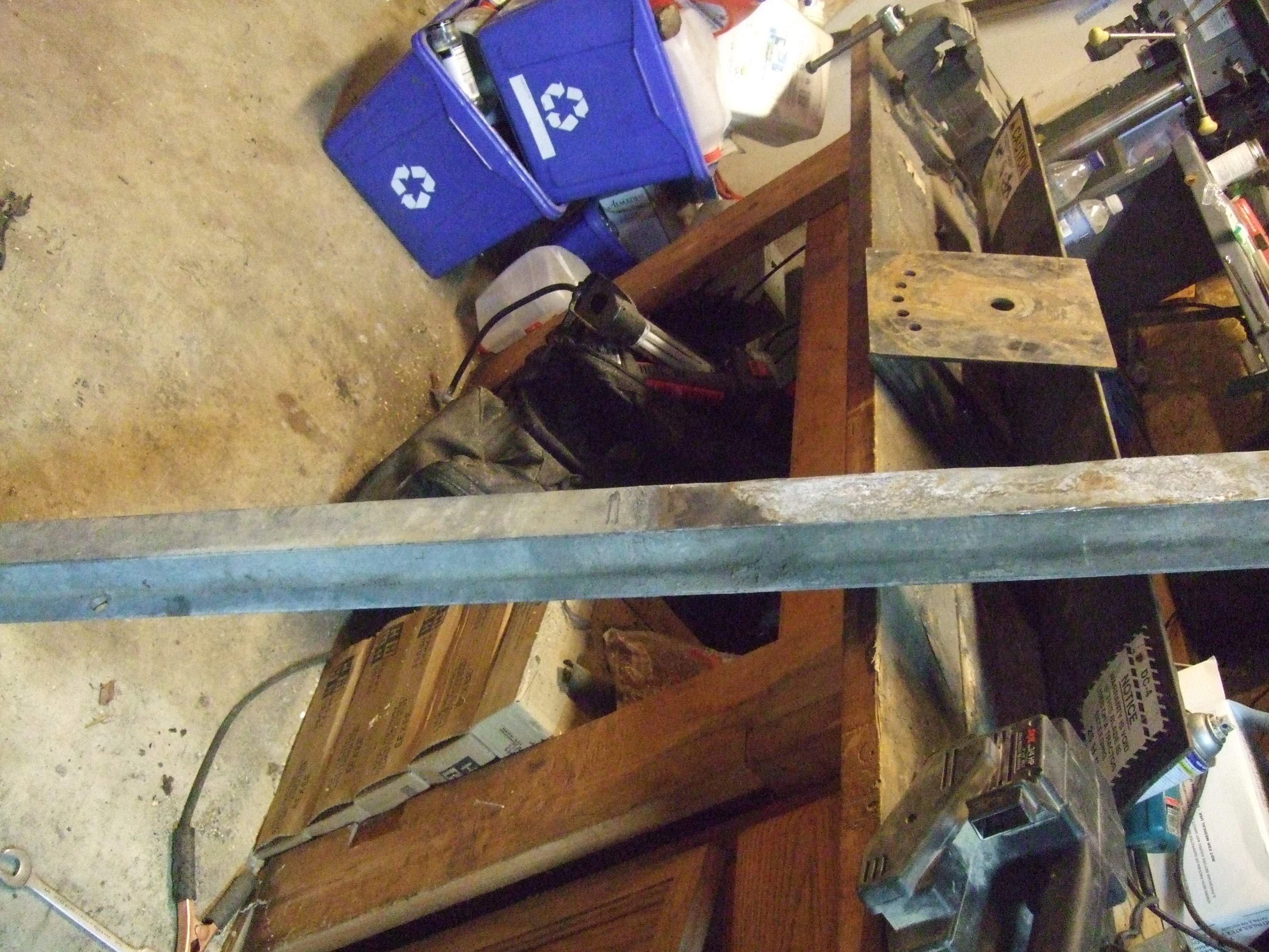

i currently have a 4 ft backblade for my bx. I would like to have a landscape rake as well. When i looked at my backblade, i see a single bolt i could remove and add a single I beam and was thinking of adding tines to the I beam to have landscape rake. I figure this would give me the best of two tools without buying another implement and take up so much space. Has anyone done this ? I have a scrap I beam about 5 ft long and a scrap metal plate i can use for this. All i need to purchase is tines and i am looking for a cheap souce of tines replacement. Any ideas and thoughts ?

will post pics tomarrow. Whats the diff between italy and china tines . i noticed there is a shape difference too.
   / convert a backblade to landscape rake on BX
here are the pics of the backblade/landscape project.
