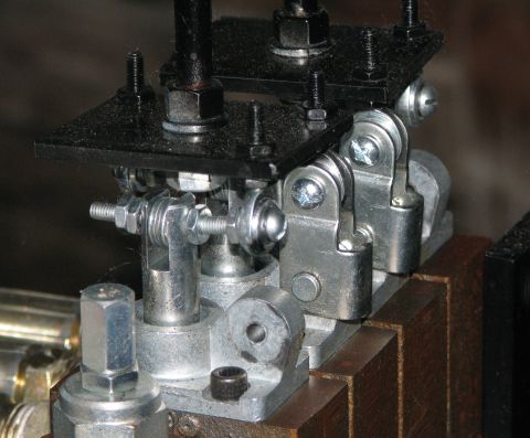

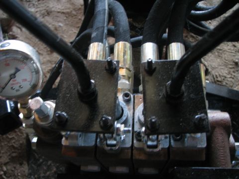

   / Convert 2 lever FEL to 1? #8
One of the TBN members made a joystick for his valves.
Here are some pictures, just don't remember who did this.
