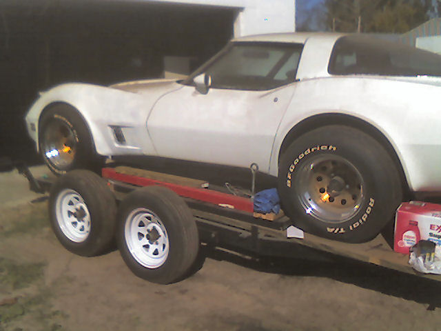

When I was looking for a 18 foot tilt trailer I could not find what I wanted. I bought some steel, torsion axles and all the other stuff and I made just what I wanted and I love it
here is a picture of it with my for sale car on it
Jim
