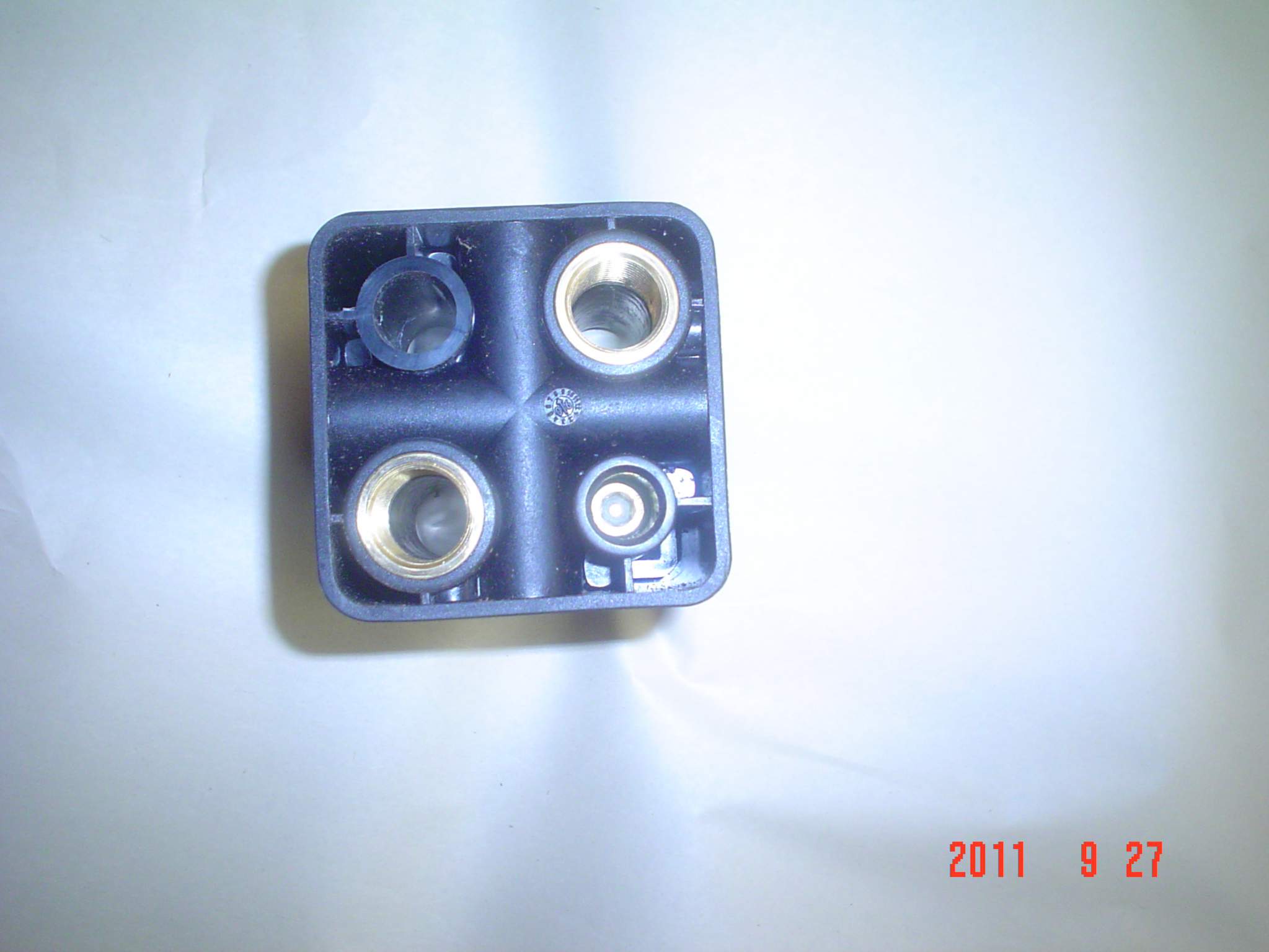

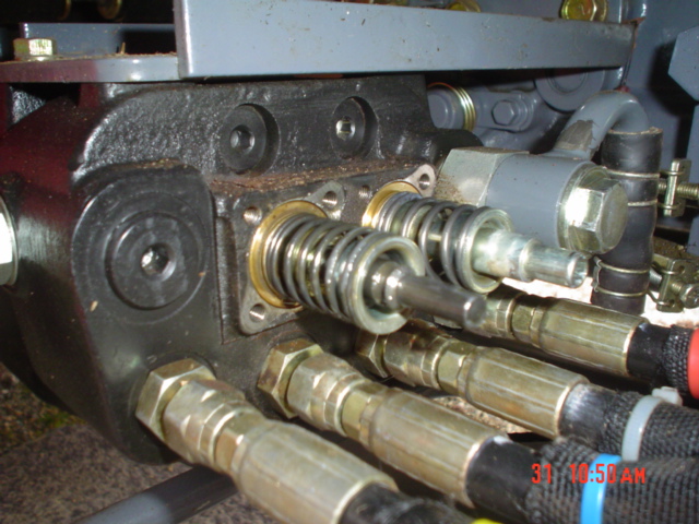

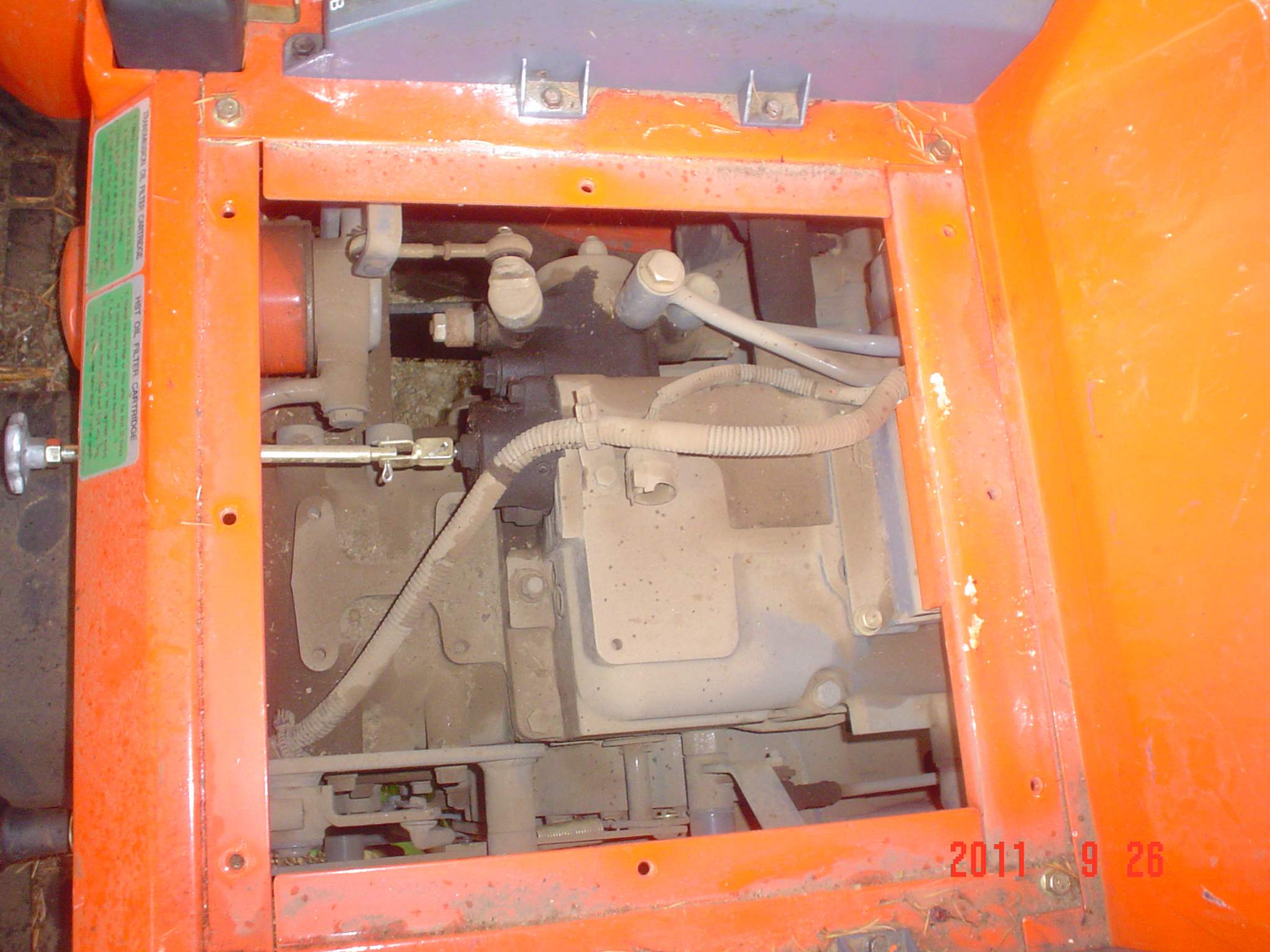

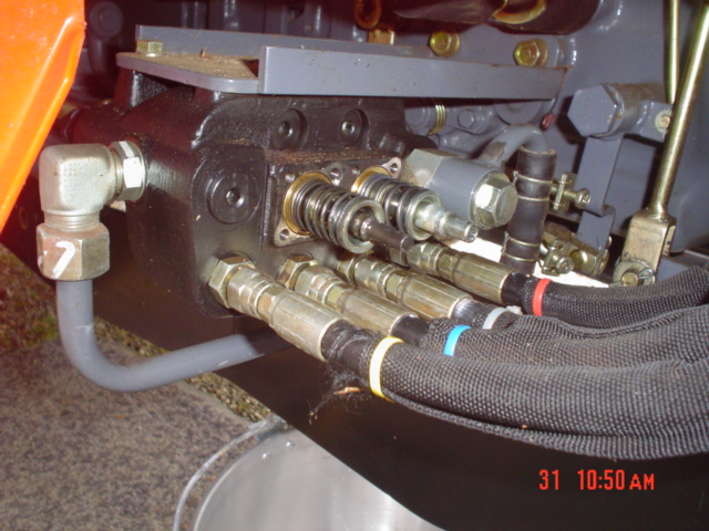

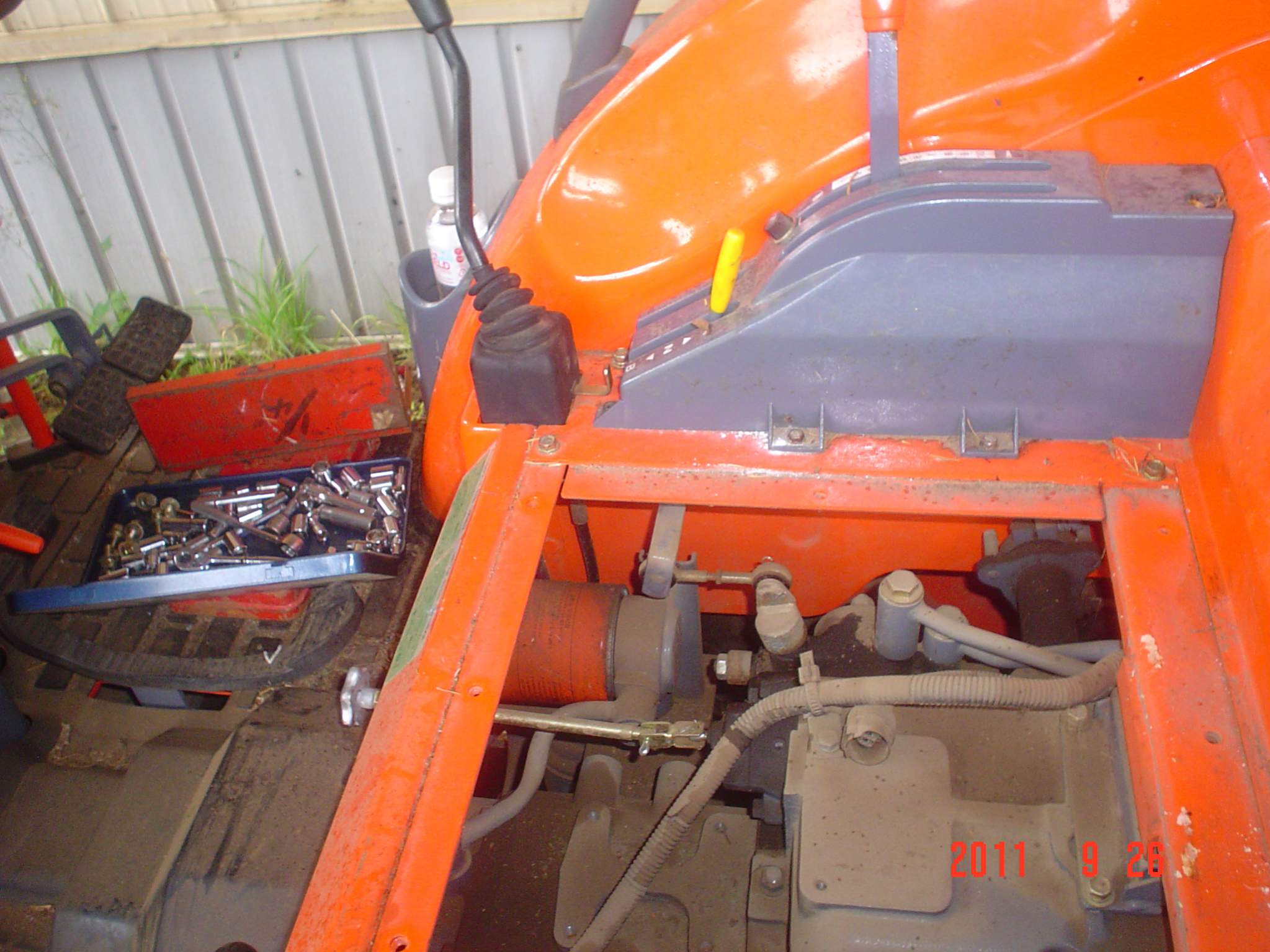

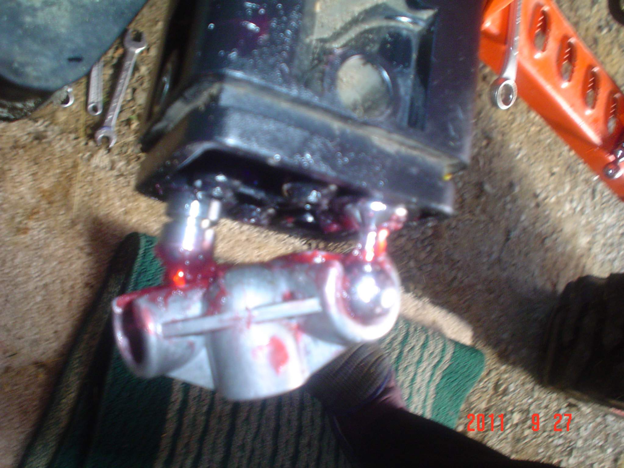

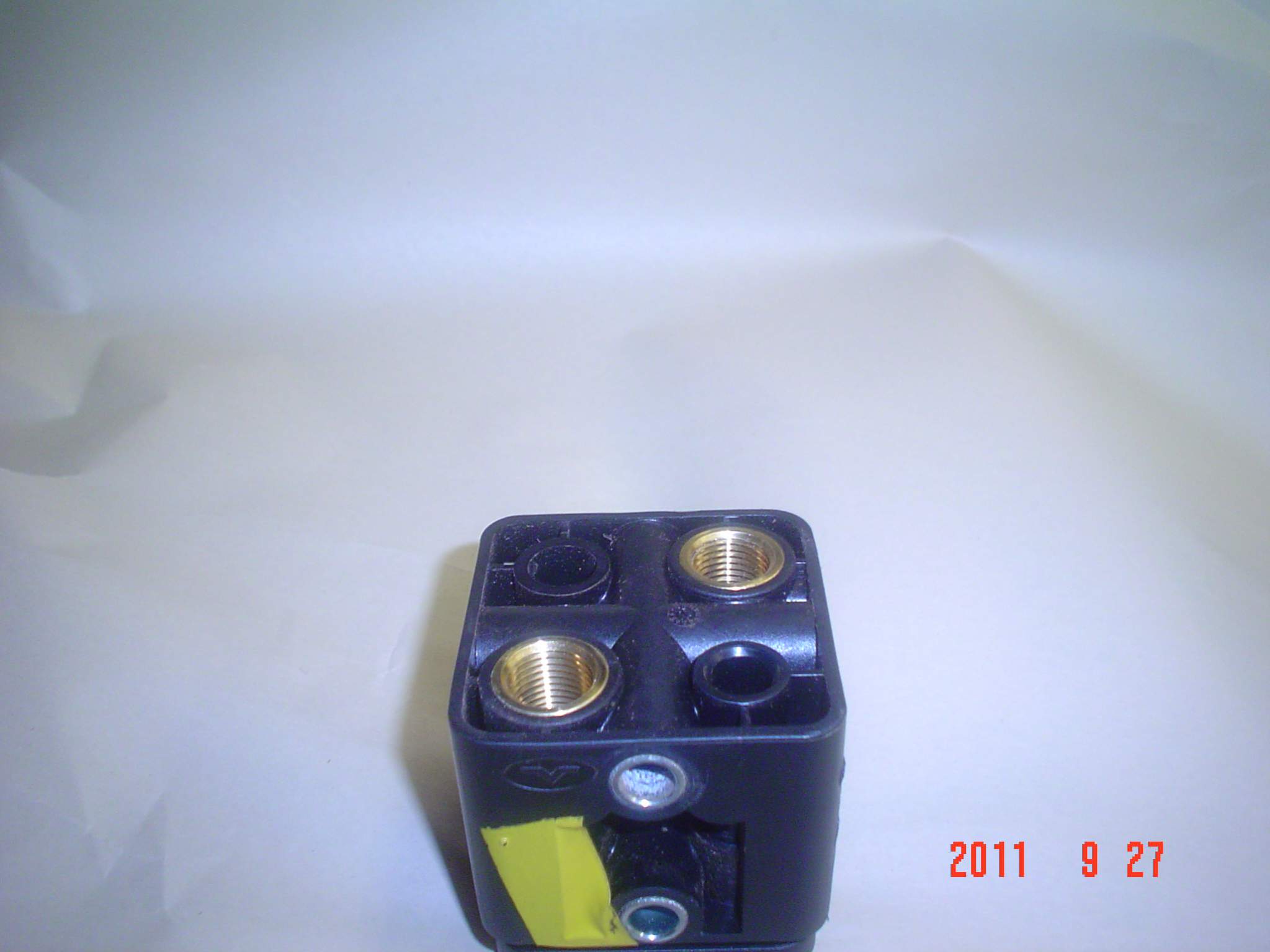

I have replaced mine and posted pics of what I did. I will see if I can find the link for you. It is also interesting how the ball fit back in, again see the pics as it may save you some time and gray hair.
   / Control Cable Conundrum #5
Here are a few pics, can only send a few at a time. Will post more.

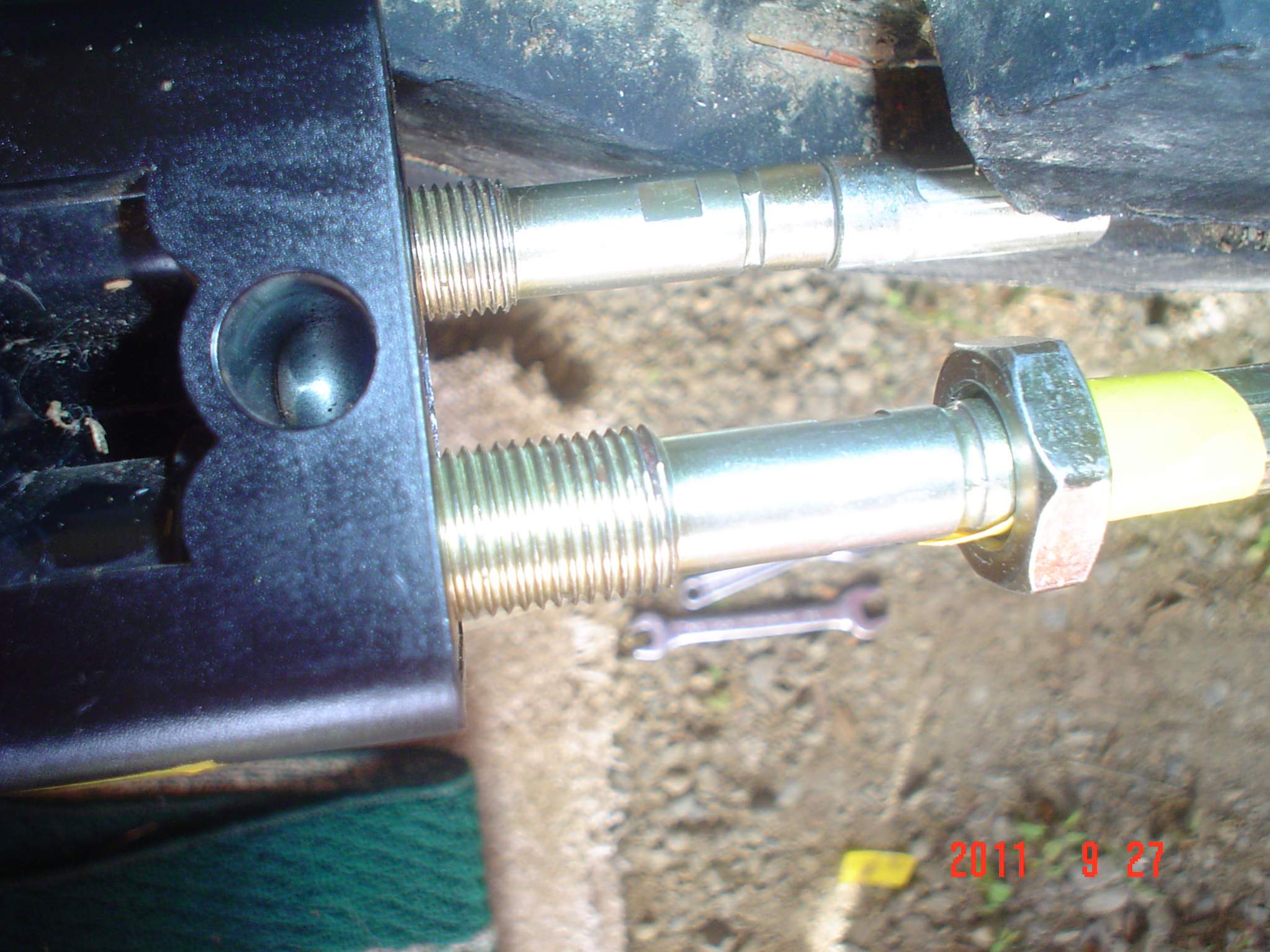

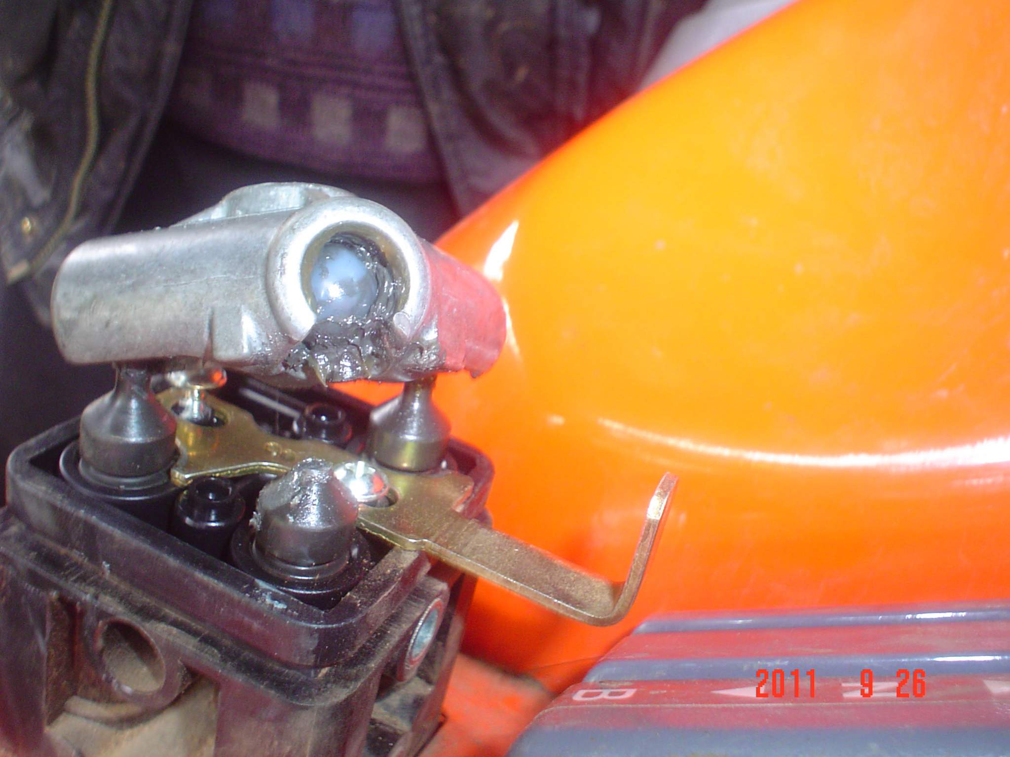

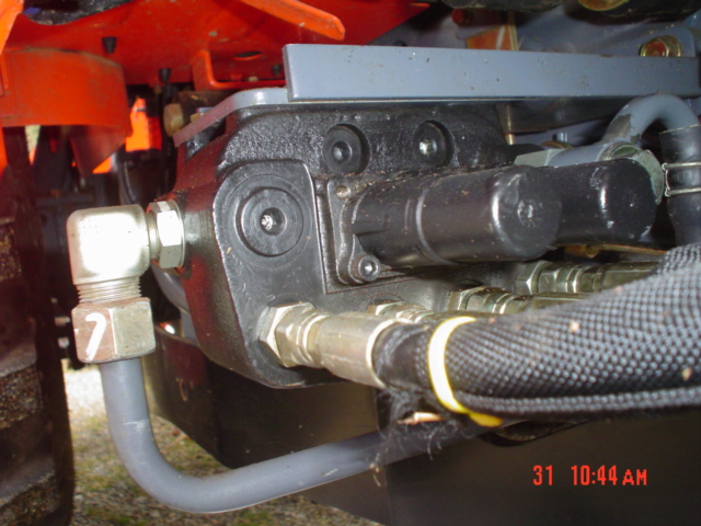

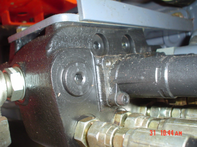

Here are a few more pics. In the last pic you can see where my ball has broken off.

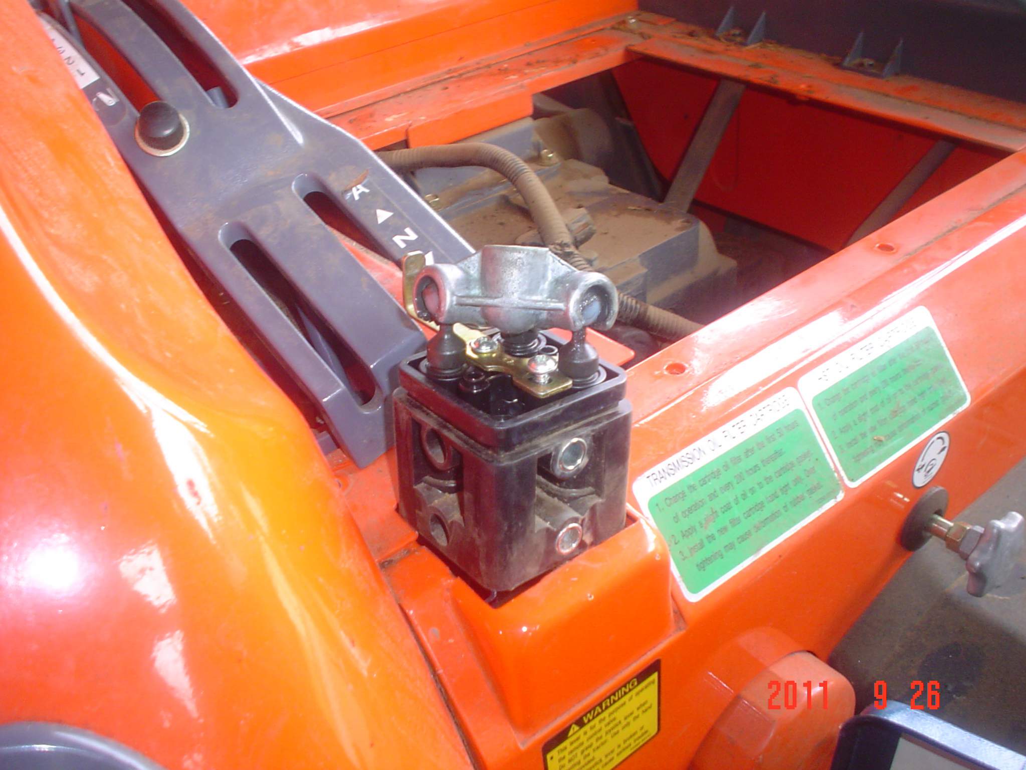

These pics and the previous ones are from my CK35. Hope this helps. The trick to getting the balls in :eek: is you have to have the holder angled.

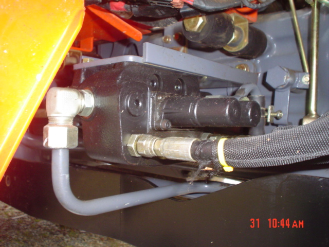

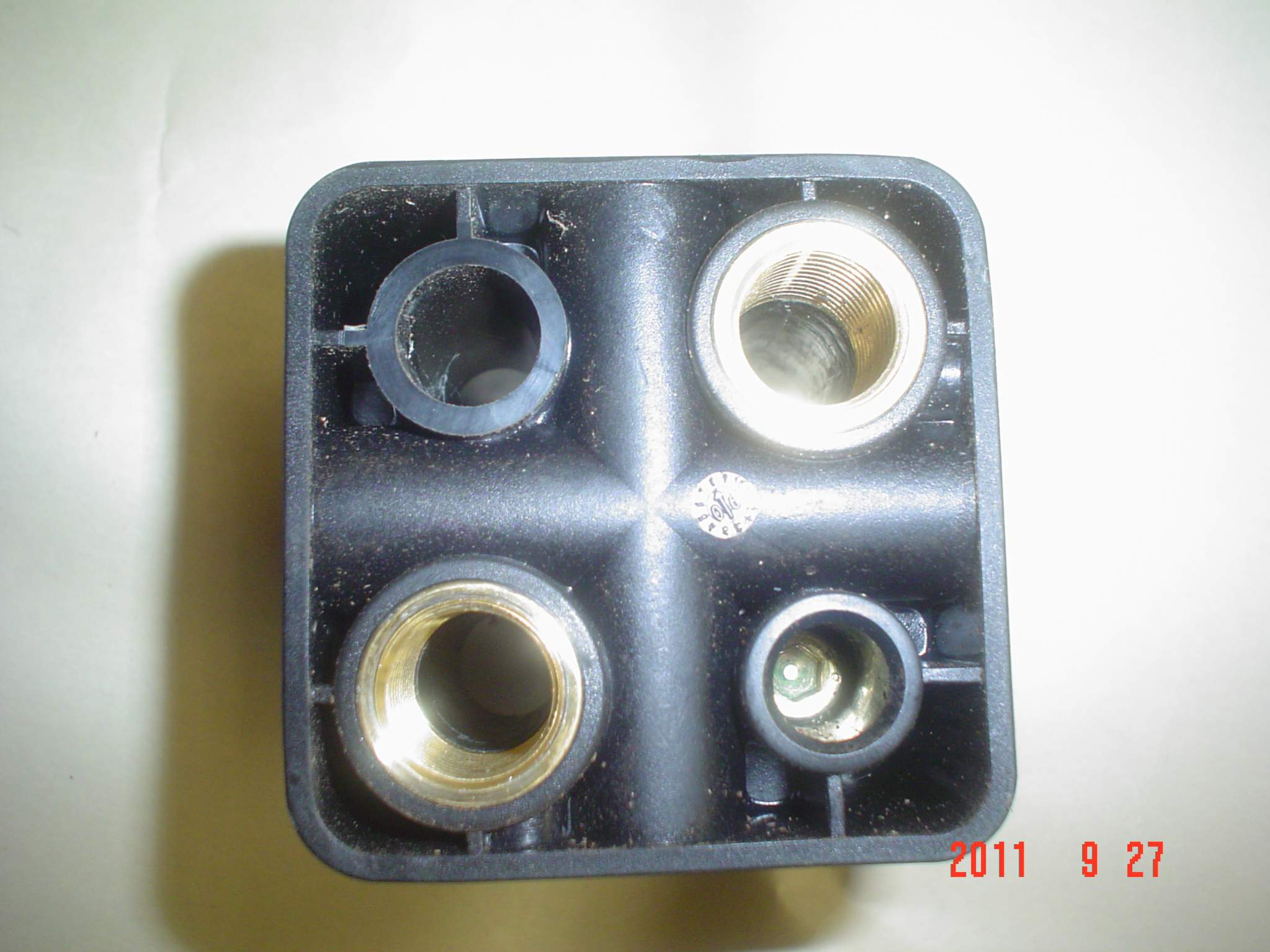

These are pics of the lower end.

This is what I posted about 2 years ago. Page 47 of this Forum.
Installed Cinematic Kit for my Joystick
Well it turned out one of the 3 plastic balls had broken off. Took the seat off and loosened the Grey control cover nest to the seat as well as the steel plate this cover is bolted to. Raised the rubber boot at the bottom of the joystick enough so I could unscrew the joystick. Then unbolted the the 2 bolts holding the joystick control box to the tractor. Then pushed the joystick box with the two cable still attached below the tractor. I was able to work on it as you can pull it in front of the back tire. Took the two cables off and then took out the three ballshafts. Found it a bit tricky getting the new ones back in, ended up screwing one of the cable all the way up and the other almost all the way out, this was the only way to fit the 3 ball/joystick housing onto the 2nd ball. Then had to screw the 2nd cable all the way up so the 3 ball/joystick housing was as far away as possible from the black square housing, only then could you put the 3 ball/shaft in. Took me over an hour just to figure out this one step. Made sure the new steel balls had lots of grease. Then reassembled it and works great.
Thanx Mousefield- you da mouse! The pictures make the difference :) So the cables do have to come off BOTH ends! When they say "Remove the cables," it means off the TRACTOR, not just off the joystick control box.
Just talked to a Kioti mechanic. He advised that the control cables don't have to be unthreaded from the base of the joystick control block. Rather, the ball-head control pistons can be unscrewed from the cables with the cable ends remaining in place. I had thought of this technique, but didn't see a spot on the pistons that would take a wrench. But that also assumes the cables wouldn't twist inside the sheathing.
I think the problem on my CK30 was made worse by the joystick boot being torn up - there was a lot of grit inside where there should only be nice clean grease.
