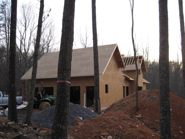

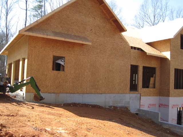

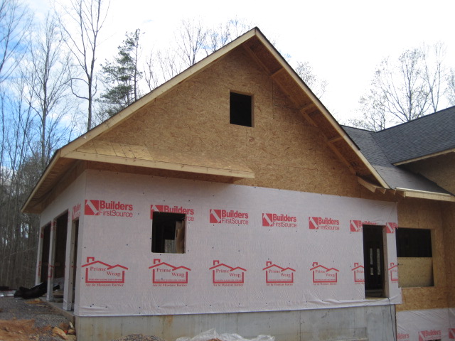

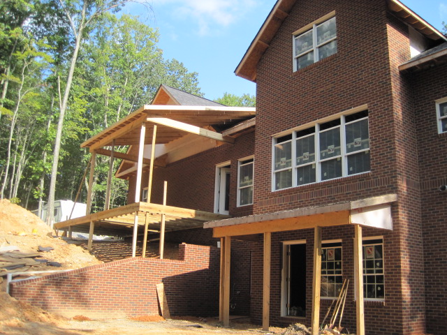

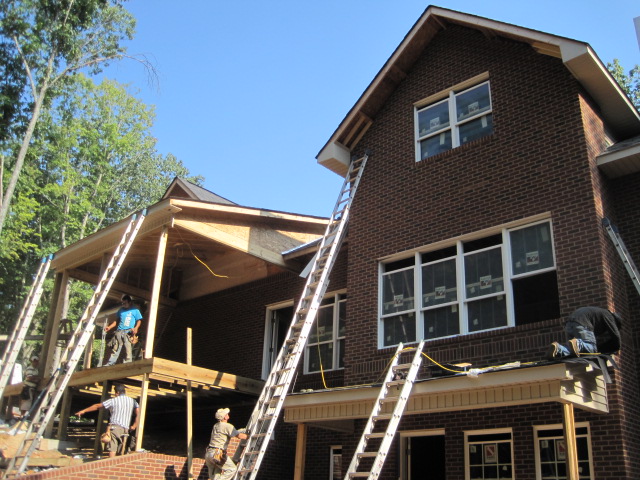

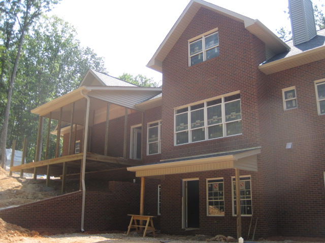

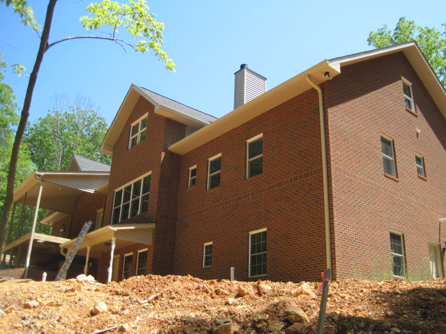

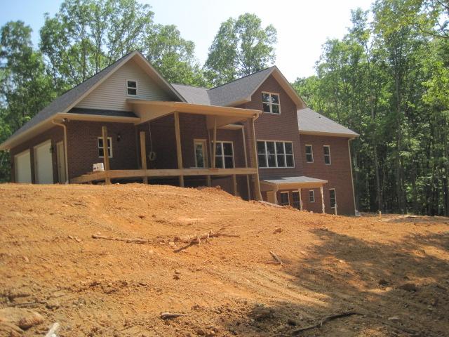

You could build a shed roof over your deck similar to the shed roof over our back porch. You would also need to change the side of the roof on your existing addition that is closest to the deck. You would need to raise that side of the roof so that it is level with the the original gable roof.
My only question would be if a shallow pitch shed roof will handle the snow that your area gets?
What you are considering is similar to our house. If you take our upstairs back porch and move it to the right, our layout would be similar to yours. The gable roof our our garage would be the roof over your existing room addition. The back porch would be your exising deck/new addition.
attachment.php

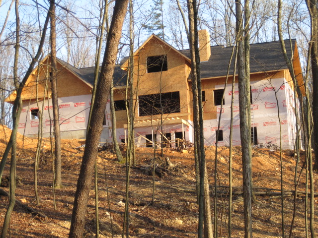

We had the same questions you are having regarding how to build the roof for our back porch. We originally considered a gable roof for the back porch but there wasn't a good way for the porch's gable roof to meet the garage's gable roof.
I have attached some pictures of our house before and after the porch's shed roof was added so you can better see how the porch's shed roof meets the rest of the roof.
If it will handle the snow, I think the shed roof is the way to go in your situation. If the shed roof can't handle the snow, then you are faced with putting gable roof over the deck beside the gable roof over your existing addition. You would then need a "mini"-shed roof between the two gables to keep water from collecting at the level line where the two gable roofs would meet without the mini-shed roof between them.

I would second the new roof concept, getting trusses premade would make it a big, but not gargantuan job. You would have a much better performing, looking, place when you got done. The difficulty is that the current roof peak elevation isn't enough to get you good drainage all the way out onto the new addition.

Do you want the eaves of the new addition to be higher than your existing eaves? If not, I don't see how the height of the existing eaves factors in. The new addition with a shed roof will give the new room the same ceiling height as the existing room where the sliding glass door is.
