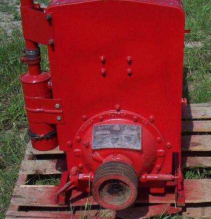

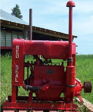

How big?? I have an original 1948 hand crank, y-112 four cyl. power unit. I have not started it in a while but it ran excellent and used little to no oil. I totally give it a face lift. I did not do anything to the motor itself due to its soundness. PM me for more

   / continental L head 4 cylinder engine
Its an F400, but I don't know the hp rating.

   / continental L head 4 cylinder engine #6
F400 is the series. There should be a tag on the left side of the block above the dipstick to indicate which F model you have. Many parts are still available but not many are interchangeable between the models so you need the number off the tag.
No there is no numbers tag above the dipstick....the only numbers
are the casting numbers of F400 A 421/S CWC. I gave these
numbers to Foley marine & industrial engines and they said they
have all the parts for this engine, so I assume that was a good number
for them.
