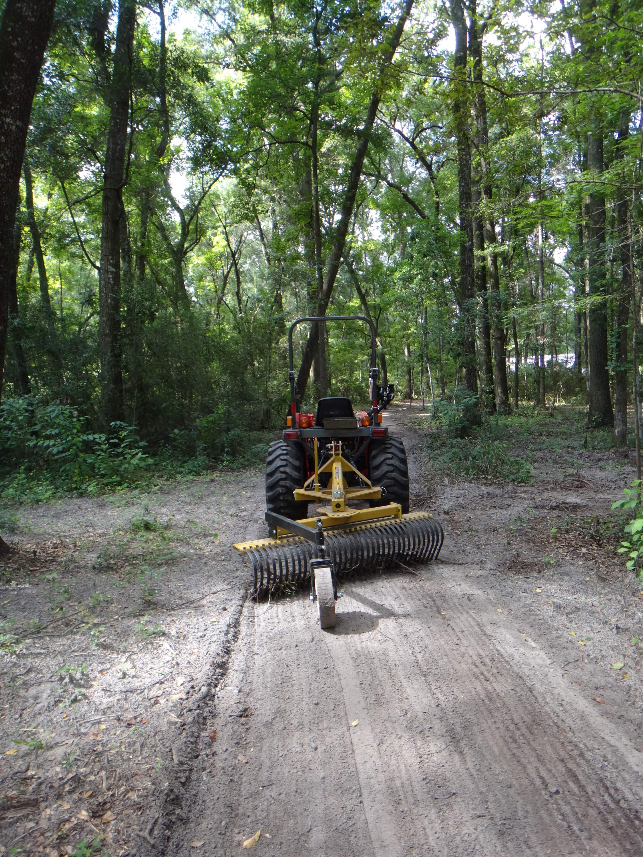

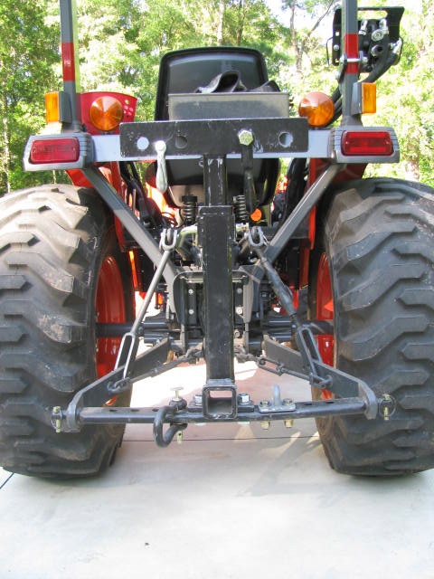

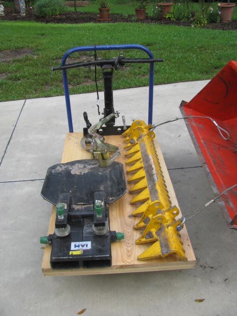

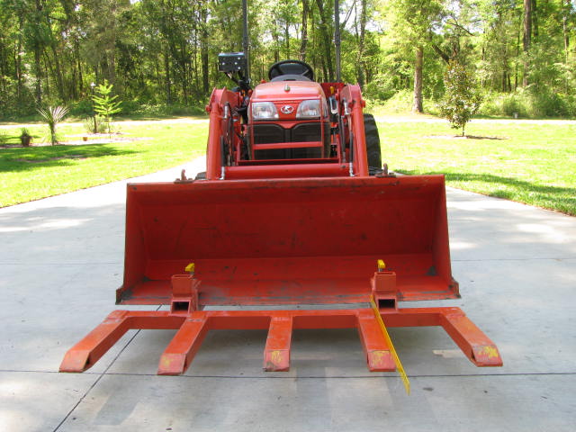

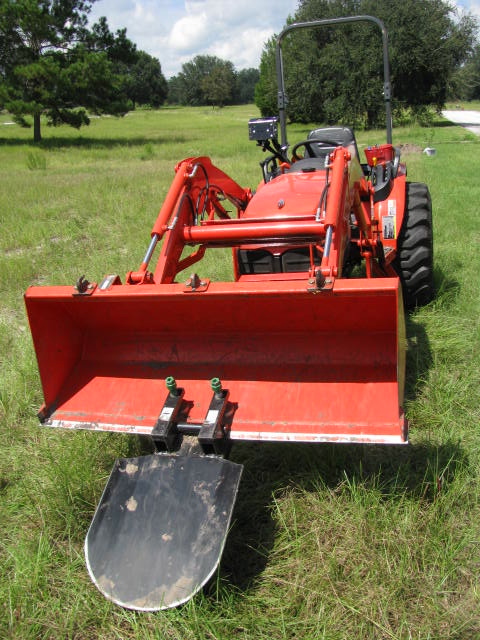

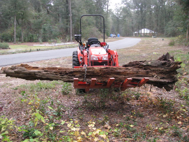

I took delivery on new B3300SU February 12, 2011. I have 330 satisfactory hours on it. Mine has R4 Industrial Tires, the default choice with FEL, and one hydraulic remote at the rear which I have never used. This is my second tractor. My first tractor was a loaned JD/Yanmar 750/20-hp that I had the use of for a year. During that time I determined 2,000 pounds was about the weight I wanted, but 20-hp was not enough power for my needs; hence the B3300SU. I work mostly in woods. The weight, 14" ground clearance and maneuverability of the B3300SU were factors in my decision to buy. I was attracted to the B3300SU PACKAGE, factory equipped by Kubota with about everything the first time tractor buyer needs at a good price.

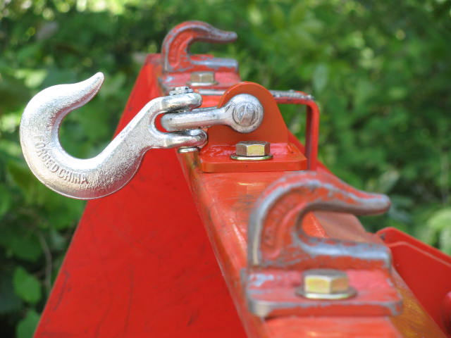

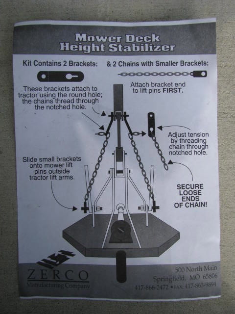

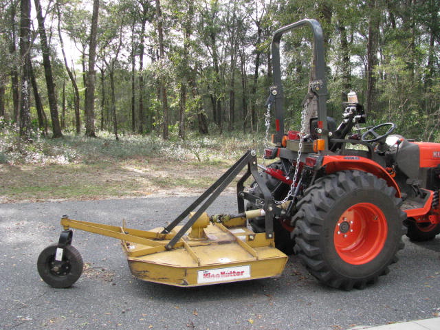

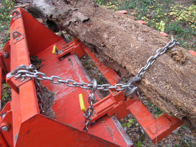

(Plan on adding 5/16" bucket chain grab hooks and I recommend Stabilworks pin-adjustable rigid 3-Pt. stabilizers to replace factory turnbuckle check chains.)
Center mount drawbars are obsolescent. It has only been 50 years since Harry Ferguson's comprehensive patents on the 3-Pt. hitch expired and FERGUSON 3-Pt. became the standard for tractors world wide. Before Ferguson's patents expired a lot of non-Ford, non-Ferguson equipment pinned onto the center drawbar. Today only a very few implements pin, such as TOWED (as opposed to MOUNTED) Cultipackers and TOWED Disc Harrows. So you probably will have no use for a center drawbar on a B3300SU.
Cross-drawbars, which mount through the lower link "eyes" of the 3-Pt. hitch, are much more common; C-D has pinning holes equally spaced along entire length. I use my cross-drawbar, with accoutrements, primarily for skidding logs.
See if you can restrain your backhoe hallucination. Taking a backhoe on/off is difficult and awkward. After a few cycles most owners either leave them on all the time, tying up the three-point hitch, or take them off and leave them in the garage. If 85+% of T-B-N writers have FELs, perhaps 10% have backhoes and half of the 10% with backhoes wish they had allocated the backhoe $$$$ toward four $ implements.
The 3-Pt. Hitch is hydraulically operated. It lifts implements. Gravity, not hydraulics, drops implements down. The 3-Pt. Hitch has a Power Take Off (PTO), which powers some implements, such as the Bush Hog's rotating blade.
The Ferguson three point hitch is what makes tractors so versatile. Consider a bucket toothbar or a bucket spade prior to a backhoe, for occasional digging.
I am not aware of any tractor brand that offers Position Control, another Ferguson innovation, on a tractor of less than 2,800 pounds weight. I believe that is because light tractors are usually sold with mid-mount-mowers rather than Rotary Cutters/Bush Hogs. Position Control is first needed to hold a Rotary Cutter. On a B3300SU you mount a set of $30 Zerco Check Chains from the ROPS to the front of the cutter to give simple, functional Position Control. Zercos have been sold for this use since introduction of the Ford 9N in 1939.
The 1/4" valve is marginally useful when using a rear blade or landscape rake, where making fine adjustments up/down on the move can be useful. I have the impression that few Kubota owners ever explore this feature. I do not use 1/4"-ing when mounting implements. Cussing seems to work better for me.

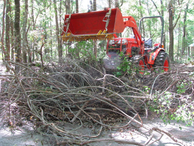

The single most useful tractor option is a front end loader. (FEL) With Ken's bolt-on-grab-hooks, you can carry one tree trunk at a time cleanly, off the ground. Debris Forks make FEL trunk transport easier. FEL bucket is ideal for moving firewood billets. It will also scoop and move dirt!

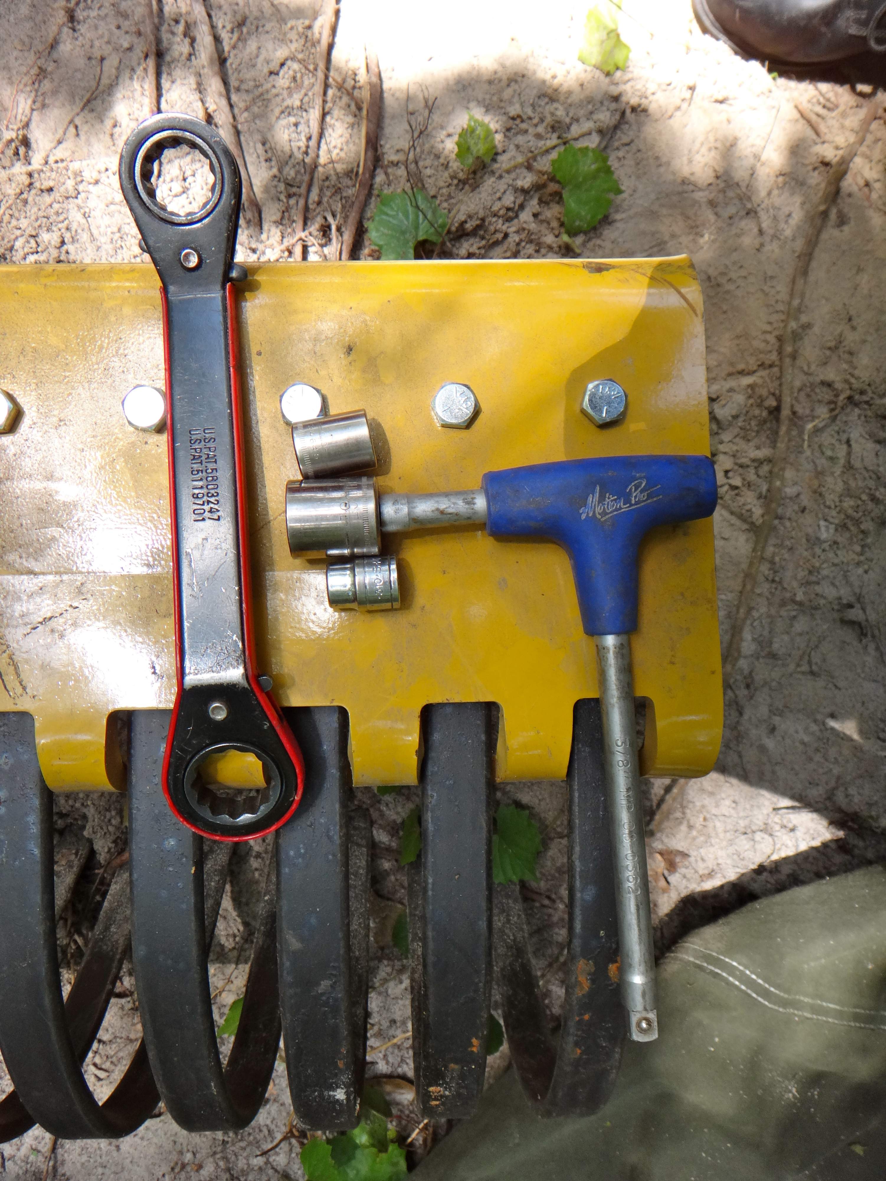

The last photo shows the tools I keep in limited space within under-seat tool box on the tractor: L-shape socket/3/8" handle + 10mm, 14mm, 19mm sockets and 7/8" + 3/4" ratcheting box end wrench.
I can't help you much with SNOW, that awful 4-letter word. I am a great fan of the Ratchet Rake. You might check out RR's Snow Edge at following link:

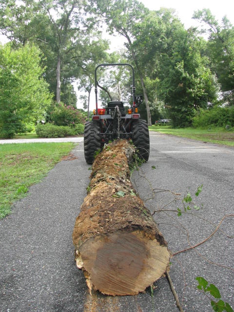

Cross-Drawbars are widely available. Your Kabota dealer will have them. Mine came from Tractor Supply Company. They are heavy, so it is practical to buy locally. You will also need some form of lock, to keep the C-D from spinning; available in numerous variations.
For skidding logs I would consider a Log Hog from Northern Tool.
Ignore the dangerous chain being dragged in the Log Hog video.......
My aluminum clamp-on Debris Forks came from Payne's Forks.
