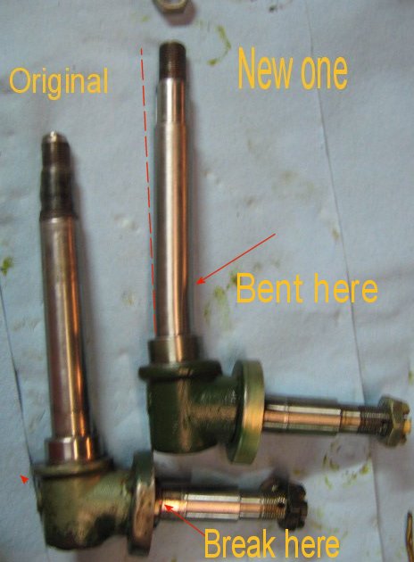

on the 4th trip I notice the wheel on the new spinle look like it was closer to the tie-rod/steering-rod ball joint, I got off the tractor to make a quick comparison of the other side, I found I could slip my hand between the tire and the ball joint on the one side, on the side with the new spindle I could barely get my finger between, I had been only using the tractor about 2 1/2 to 3 hours,
yup! the New spindle had in fact bent, Not broke... and not bent at the wheel hub where the old one had broke but at the part that goes up into the axle beam tube,
( the upright part) of the spindle, Picture will show it, I shouldn't and won't go into the issue of trying to get another replacement, I'll just say the New spindles do not have as strong of quality steel as the old original 30+ year old ones do,
OK now to the point of topic, after my experience with the new spindle I don't waont to be throwing anymore of my money away if I am to expect this to happen even if I were to use the heavy duty spindles, Remeber the new spindle didn't bend at the typical area where the old ones break from, and as far as I know this has not been the area of the part that has been made stronger, With the heavier duty ones only thicker material is added at to the spindle where the hub mounts too,

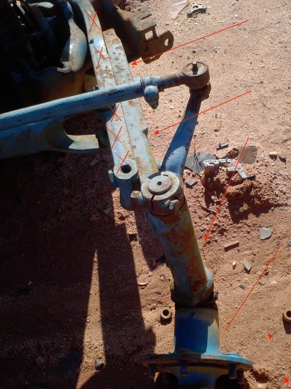

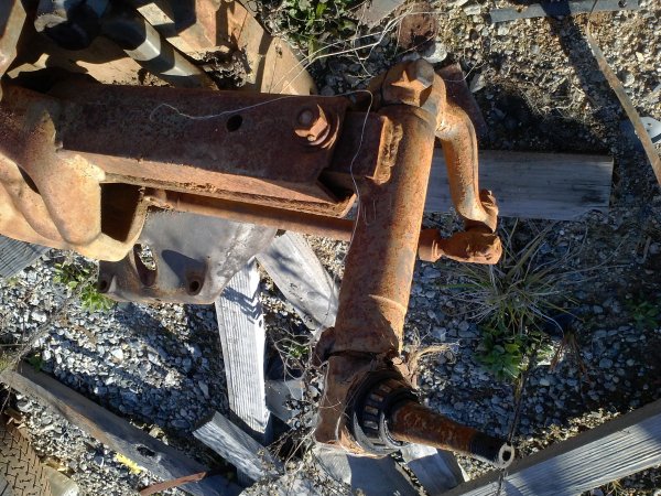

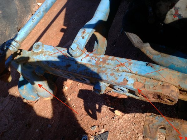

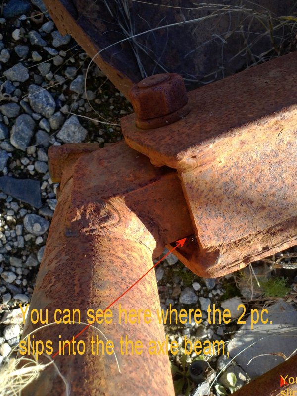

And this why I'm...."Contemplating a front axle/Spindle change out" from another make of tractor, I've looked at a few tractors in the local salvage yard, with front axle's that I think I can use to build a stronger one for my Yanmar, Is anyone familiar with the fors 8 & 9 n's ? They have extendible 2 pc axles, I'm thinking if I got the part of the extendible part of the axle I could either bolt it onto my existing axle beam, or cut the ends of it and slip the one from the ford into the beam and weld it together,
I have pictures of 2 different tractor applications, But I need to transfer from my cellphone to computer before I can post them,
Now if theres a good chance of making this work I can score oneof these axles for 100.00 hub to hub,

Picture of the new bent spindle, and the axle's I'm thinking about,

Actually is a good Idea.... I could put a search out for a larger Yanmar tractor front axle, But I am on a budget, No real hurry as I have repaired the new spindle by heating and straighten it, I have removed the FEL until I can build/buy a stronger axle,
