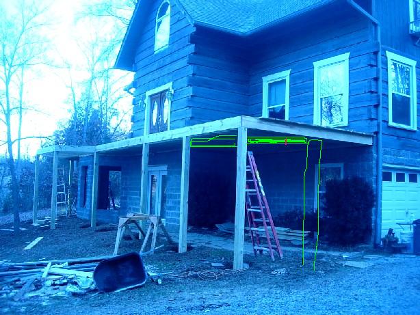

We've got a guy who's building a deck and adding a small area to the house.
Attached is a picture (sorry for the BLUE, seems I had camera on "indoor lighting")
Anyways...
I've tried to draw in the item of my question.
Today, they added another post (the skeleton in yellow). In addition to this post and per the blueprints, they added "two 2x12 dropped girder" and this section is the left/right yellow (pardon the great draw job I did!)
This girder is two 2x12's that on the house side, go into a slot that they cut into the block wall so it's got great support. On the post side, it's currently nailed to the post and they'll probably add the hanger later on. At least, that's how they did the other joists.
Here's the crux of my question...
They took a SINGLE 2x12x18 (this span is right at 18') and in essence, took another 2x12x15 and a 2x12x3 and married the 15' and the 3' boards onto the single 18' board to give them "two" 18 footers.
I don't know but my logic says that this is NOT two 18 footers since there is a break in one of them...I'm ONLY going to have the full strength of a single 18 footer and maybe some additional strength by the added parts but I will NOT have the strength of TWO 18 footers.
Is my logic correct or am I being too ****?
I'm ready to call the builder and have him yank those down but don't want to put my foot in my mouth as I'm so wanton to do.
Any thoughts would be appreciated.

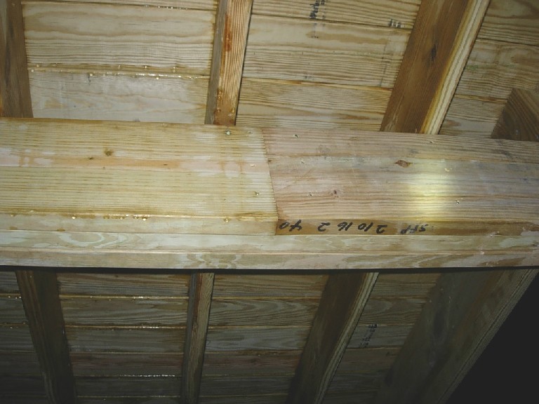

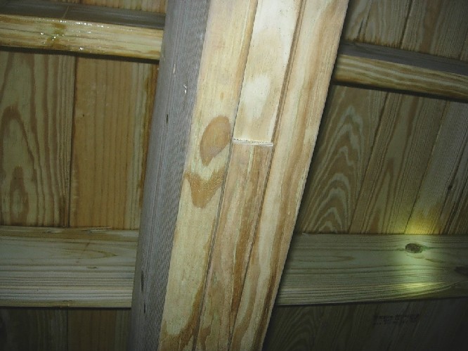

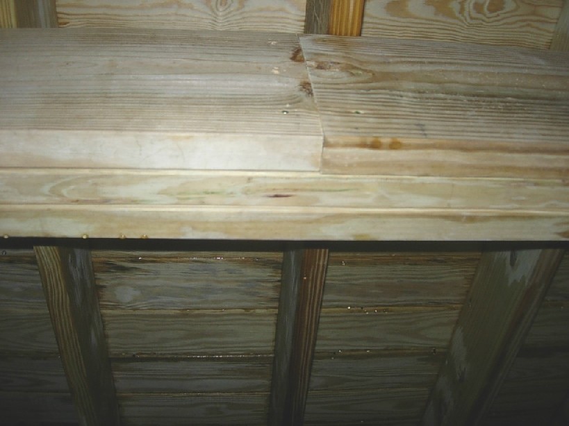

EACH of the three "beams" is made up of two boards, not a single one of them is a continuous board. The plans call for two 2x12's and this is made up of three 2x10's and not ONE of the three 2x10's is 18' long. Virtually each one is made up of two boards to sum to the right length.
I'm thinking I like this less and less....
I'm hoping someone here can calm me down and explain why this "is" ok (as contrasted to "might" be ok)!!

   / Construction question (deck) #8
You can do that as long as the breaks are off set, but be warned it can weaken it. I have something similiar on my deck but at each break i put a kicker under it just for piece of mind, usually you see this type of beam used vertically not horizontally. I figure a few kicker beams is cheaper than an entire new deck or a law suit

   / Construction question (deck) #10
Typically, builders prefer to install built up beams because shorter sections of wood are easier to handle than longer ones. I have no clue whether a triple 2x10 beam has the strength of a doubled 2x12. The number of nails used, their spacing, and the size of the nails can affect the strength of the built up beam. I think you need to continue asking your question until you get a satisfactory answer and before you pay for this work.
Kind of strange that they'd be going back and adding another post with the built up beam after everything else is up.
While you are asking questions, did the builder install flashing between the upper deck surface and the side of the house? (circled area). Looks like water splashing off the upper deck surface and water running down the side of the house could create some issues, especially with wood siding/timber exterior if this is not flashed well.
