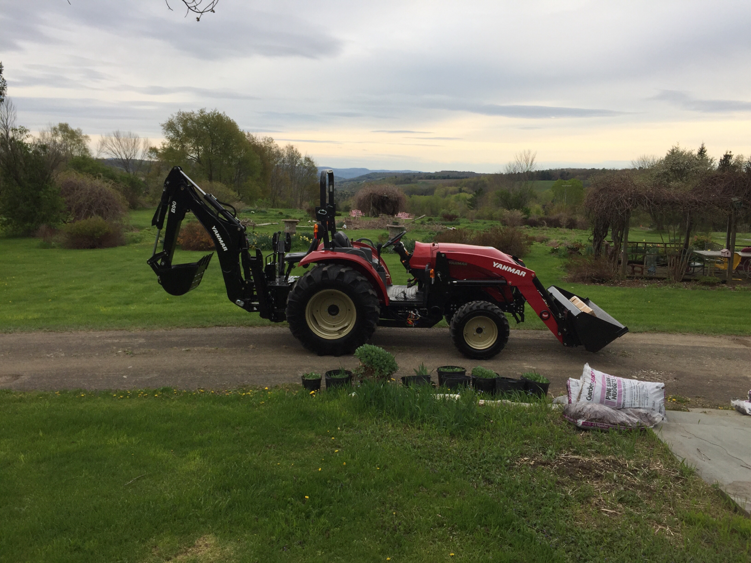

We just bought a YT347 open cab and love it. I think my wife has more hours on it than i do. Controls seem pretty durable. I was concerned about the whining noise coming from the transmission but I've heard that is normal. With the tier IV emissions you wouldn't even know you're running a diesel.
   / Considering a Yanmar - any feedback? #7
We just bought a YT347 open cab and love it. I think my wife has more hours on it than i do. Controls seem pretty durable. I was concerned about the whining noise coming from the transmission but I've head that is normal. With the tier IV emissions you wouldn't even know your running a diesel.
David, new tractor means you must post pics! We're all here waiting to see your new YT347.
   / Considering a Yanmar - any feedback? #8
   / Considering a Yanmar - any feedback? #9
DavidL61,
Thank you for your business. And thank you for the photo of your YT347 in those beautiful surroundings.
