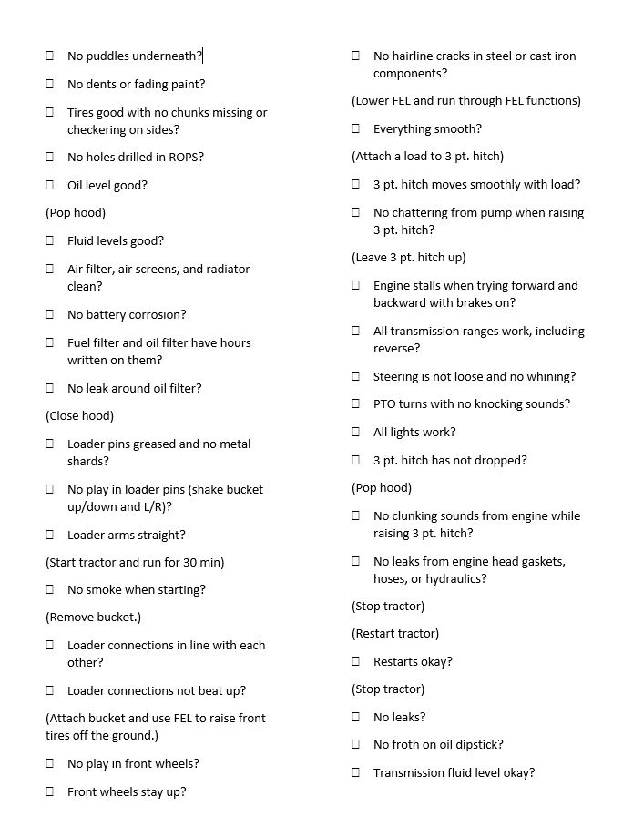

Sounds like a fair price. The 4720 is a good tractor with no hidden problem areas. I would ask a bit more about the oil leak. If it is that easy to fix, why haven't they fixed it? Maybe the repair should be completed by either you or him before the deal is consummated. If the oil filter block gasket is indeed what it is, it is probably as easy fix. If it is something like a rear crankshaft seal, it isn't.
Some random things to look at when buying any used tractor: Check the loader pivots for wear. You should be able to lift the front end off the ground with the loader. Leave the front end up and check the front end for slop (Steering, wheel bearings, drive mechanisms and pivots). If there is any, be concerned. The tractor should start easy when cold and run smooth. The three point should stay where you set it. (Check it preferably with a load on it). Make sure the 4 wheel drive actually works. Run the PTO, preferably with a load. The radiator fluid should be clean. I also like to look at how the owner cares for everything else he owns.
   / Considering a used Branson 4720H? #3
I’d ask for service records and have a tractor mechanic go over it. You can learn a good deal from there.

I'm going to check out the Branson tractor tomorrow morning. Here's a checklist that I've put together from different sources on the Internet. Any thoughts or comments on my list?
