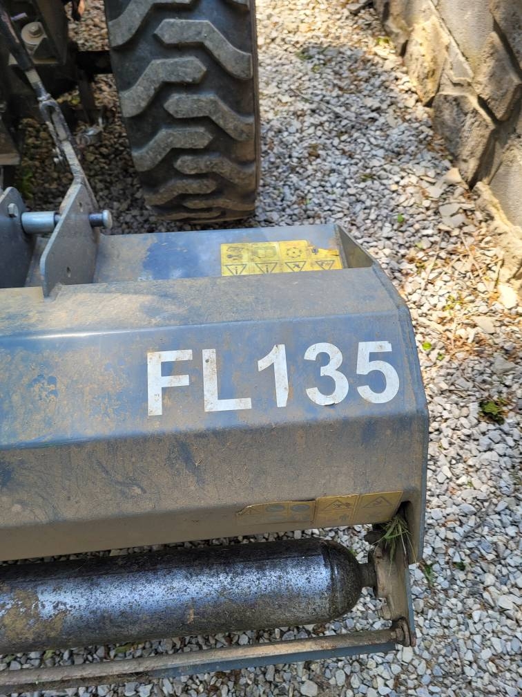

I am in the market for a small tractor whose primary job will be mowing with a flail mower. Also I will use it for light loader work and with pallet forks. I have larger tractors and a TLB for the big stuff.
My question is mostly directed at someone that’s owns a T264. Are you using it for similar tasks and are you satisfied with it? Have you had any issues with it?
The flail that I am looking at is a Titan (now Ironcraft) FL135 52in. Does anyone have any experience with these?

Little fl135 does fine with a max26. Just watch for bolts loosening
