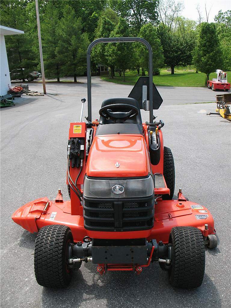

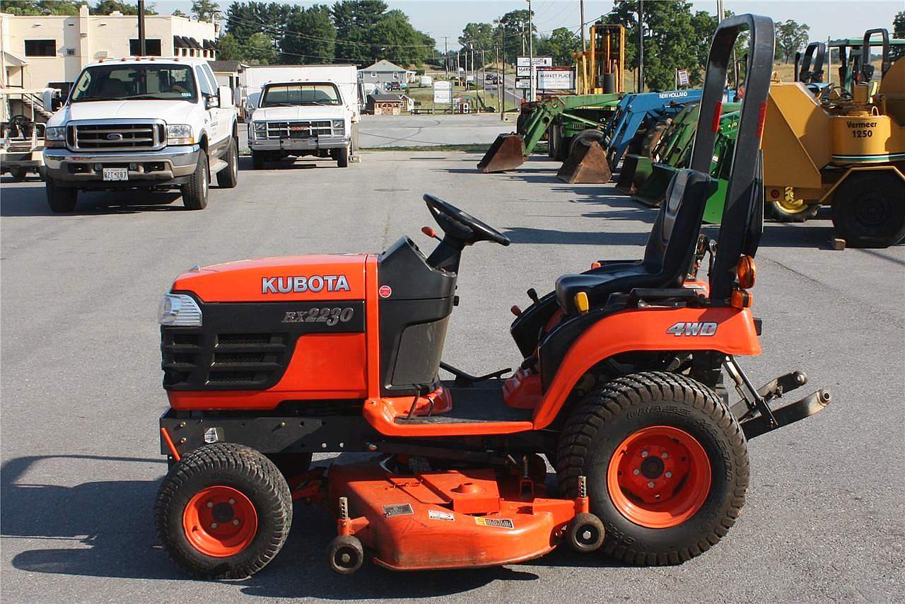

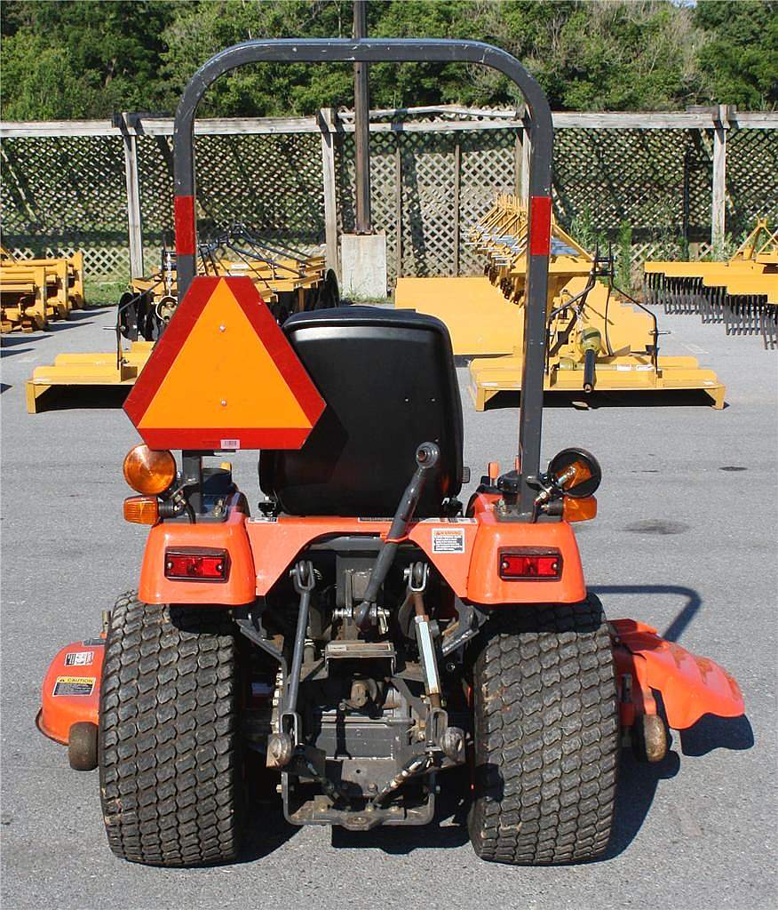

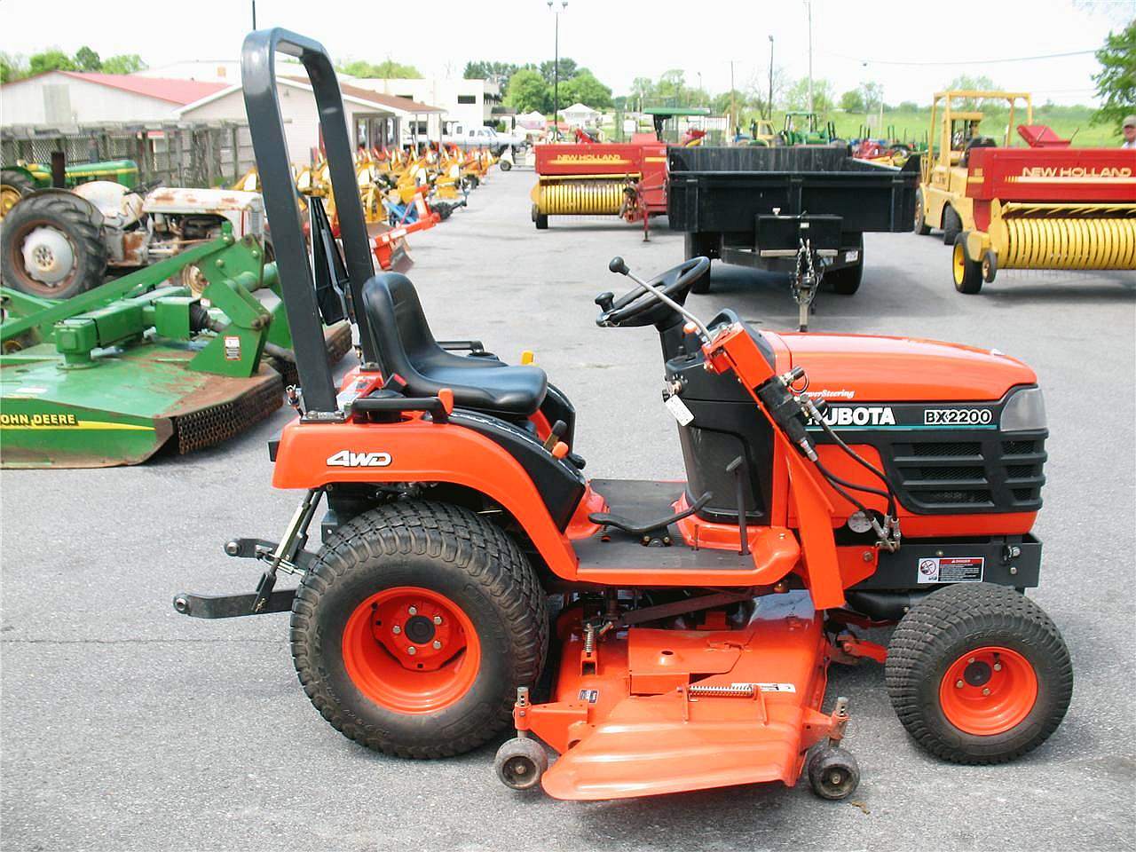

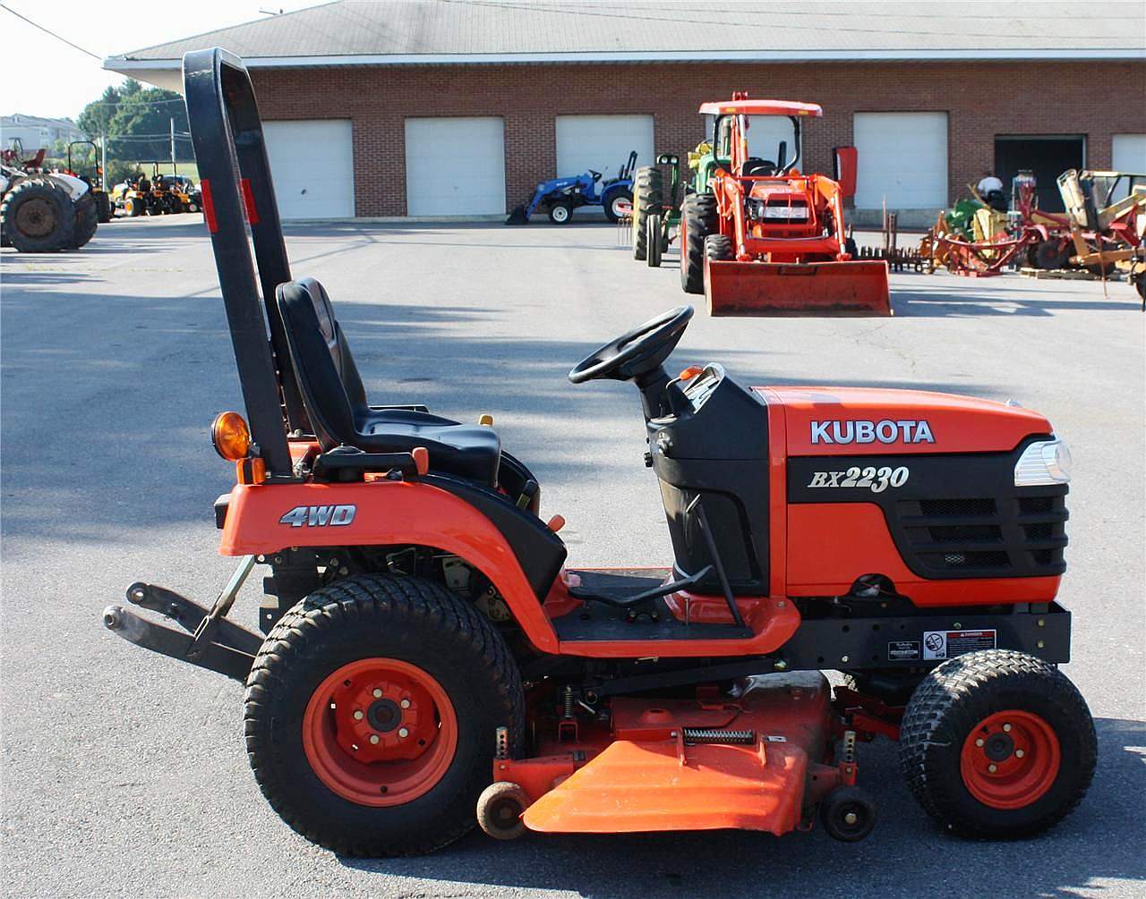

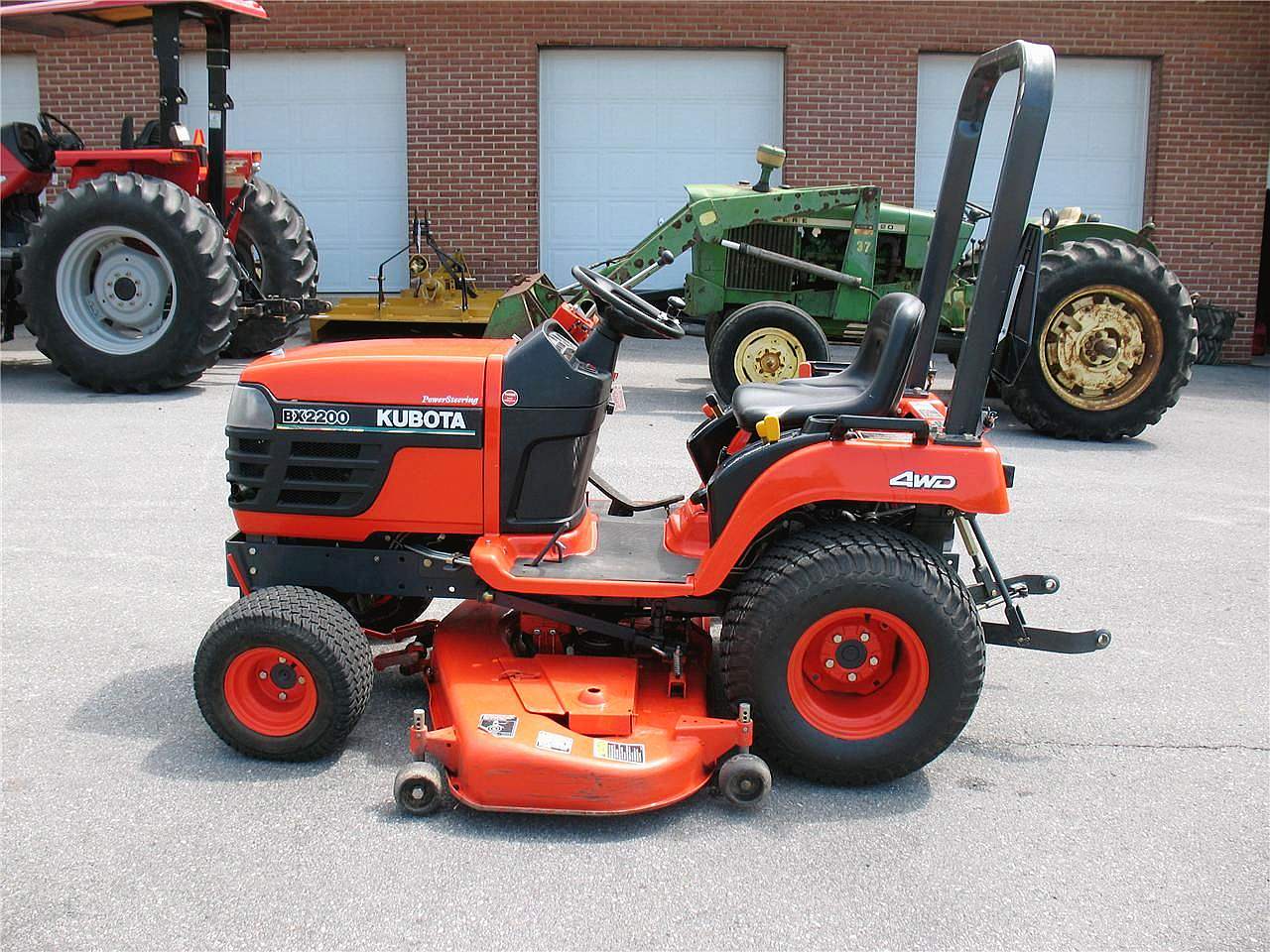

Hi All,

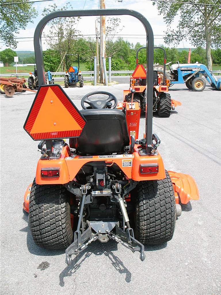

My family and i are looking for a new SCUT for mowing. We have about 5 and 1/2 mowable acres. My deere 4320 is a little too much for mowing and tilling our small garden. Plus, i don't have an iMatch or a quick change system, so i would be a pain switching between a RFM and the old brush hog. I would plan to eventually purchase a tiller. Our terrain is hilly so 4WD is a must. I have been doing research on the BX vs. the competitors and i think the BX is an all around better tractor. I am only fifteen years old so i have been saving since winter, working all summer so far, and plan to sell our deere lawn tractor. On our way home from Charlotte today we saw a Kubota dealer in Maryland and stopped to see what they had. They had some nice used BX's. I had wish a bought a camera with me, but there were already on tractor house.com. The first is a 2004 BX2230 w/ 414 hours and a RCK60 MMM for $7,500. The other was a 2002 BX2200 with 670 hours and a RCK60 MMM for $6,900. They both seem to be in great shape. Was there any big difference between theses tractors? I know that there is a $600 price difference but the BX2230 has 200 less hours than the BX2200. Has anybody had both of them? Whats a better deal?:confused:
Sorry I don't know how to post more than 4 pictures so the pics of the BX2200 will in another post.

They both are great tractors, but i woud definately prefer the BX2230, considering the pricing that you recieved and the improvements of the model line. The BX2230 is a very good Kubota tractor.

200 hours and 2 years is worth paying the $600 difference in my opinion. I've had a BX2200, my first Kubota and it is a workhorse and there will be very little difference between either one of them other than the age and hours. Shop around with these figures and you may be able to save some more money.

I believe one of the main changes from the BX2200 to the BX2230 was the loader design. With the BX2200, you would disconnect the FEL, but the control valve and stick would stay with the tractor. With the BX2230, the valve and stick were mounted on the FEL frame and came off with the FEL. And, sure enough, you can see the control valve and stick on the right side of the BX2200 in that picture! But the rest of the loader seems to be missing... no mounting brackets, etc. I would want to know the story behind that. Seems a bit wierd that it originally had a loader and it was taken off.
But without the loader joystick on the BX2200, how would you operate a plow or snowblower?

I had a BX22, and one of the reasons I traded it was that the hydraulic controls came off with the loader. Yes, you can dismont the loader controls, and mount them back on the tractor, but it is kind of a greasy dance to do alone. Some of that series tractor was sold without a loader, and so the mast, etc. has to be purchased separately if you want to use front mounted attachments, and they aren't cheap. I think that the foot pedal for the hydro was improved between the BX2200, and BX2230 series too. Others, and myself had problems with the tractor not stopping sometimes when you took your foot off the hydro. The issue was "sometimes" since it could be a bit irritating to stop one time, and not the next.
There were some who did not like the "improvement" for just the reason you mentioned, but I guess most buyers did not need a front attachment other than the FEL. I have a rear blade for my BX, which does OK in our mild mid-Atlantic winters.
