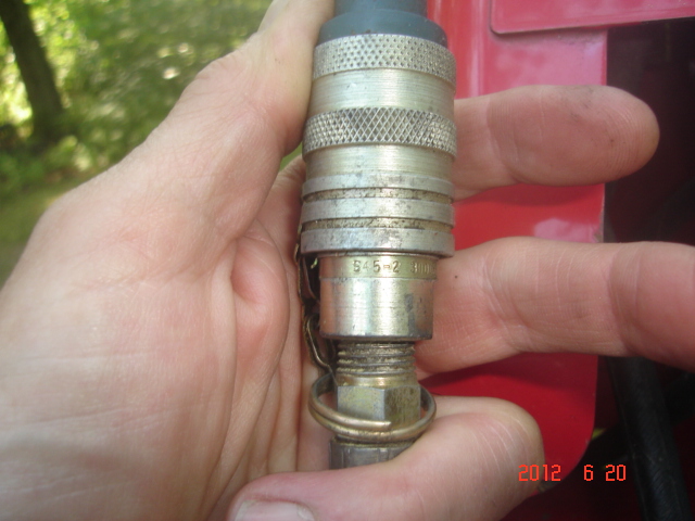

Ditto what Brandi said. Most any area of reasonable size/population will have a hydraulics shop. Could be a function of local auto parts stores as well.
That's what I did when I made three 24" extensions for the BH hydro lines -- best move I ever made! My 2310 came with Safeway S45-2 connectors.
   / Connectors on backhoe hydraulic lines? #4
Below is the Safeway Couplers S40 Series information I have gathered and ordered for my MF GC2410:
Female Half: S45-2
Male Half: S41-2
Complete Coupler (Male + Female): S40-2
KC
And Loctite Sealant #545
