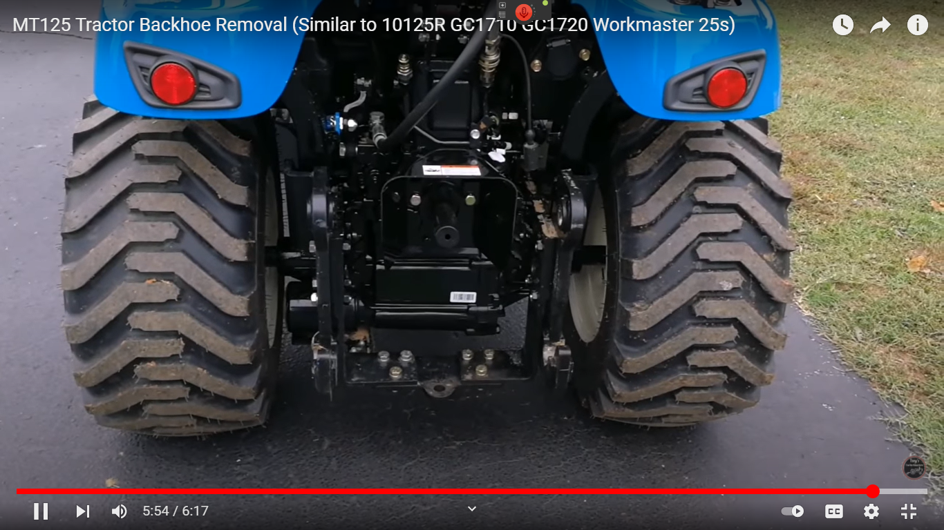

Hi everyone, this is my first post and I am new to this forum. I have just purchased a new LS M -125 tractor with a loader and backhoe. I want to install a top like for my box blade. Once I removed the backhoe I have three lines. One of those lines gets reconnected back to a another line that was disconnected for the backhoe. I believe this line is called the power beyond line. My question is how do I make use of these lines to connect to a control valve for a top link? I have not yet purchased the control or the ram.

It's pretty complicated but simple at the same time..... You will have to get an open center valve block so that the power beyond "flows through" completing the circuit. You will also need to get the hoses/ fittings, and a place to mount them that would be convenient to operate.
When I had my MT125, I priced out the factory kit and buying the individual parts. The kit makes it very easy to do, but costs twice as much (that was 3 years ago). Not sure what the kit costs now... did you call a dealer?

No I haven't yet. I want to get the parts and do myself at a lesser cost.

I don't think I have to remove the subframe to attach 3 point brackets. Yes that is the filter. The 3 hydraulic lines that I need are there to connect to the backhoe.

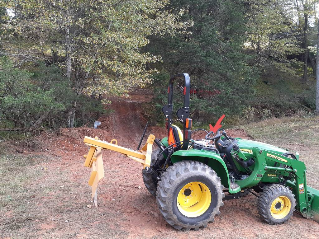

On my John Deere I bought an open center spool valve and mounted it on right side on arm rest cover beside PTO switch. Hoses I measured and had a local NAPA store make with ends I needed. The power beyond I just unplug and plug into the valve. Other valve hoses go to top link.
I got a grapple and plumbed that in with solenoid valve and switch on joystick handle.
Those hoses zip tied to brush guard.
Those hoses zip tied to brush guard.View attachment 743524
How many lines connect to the open center valve that you installed?
