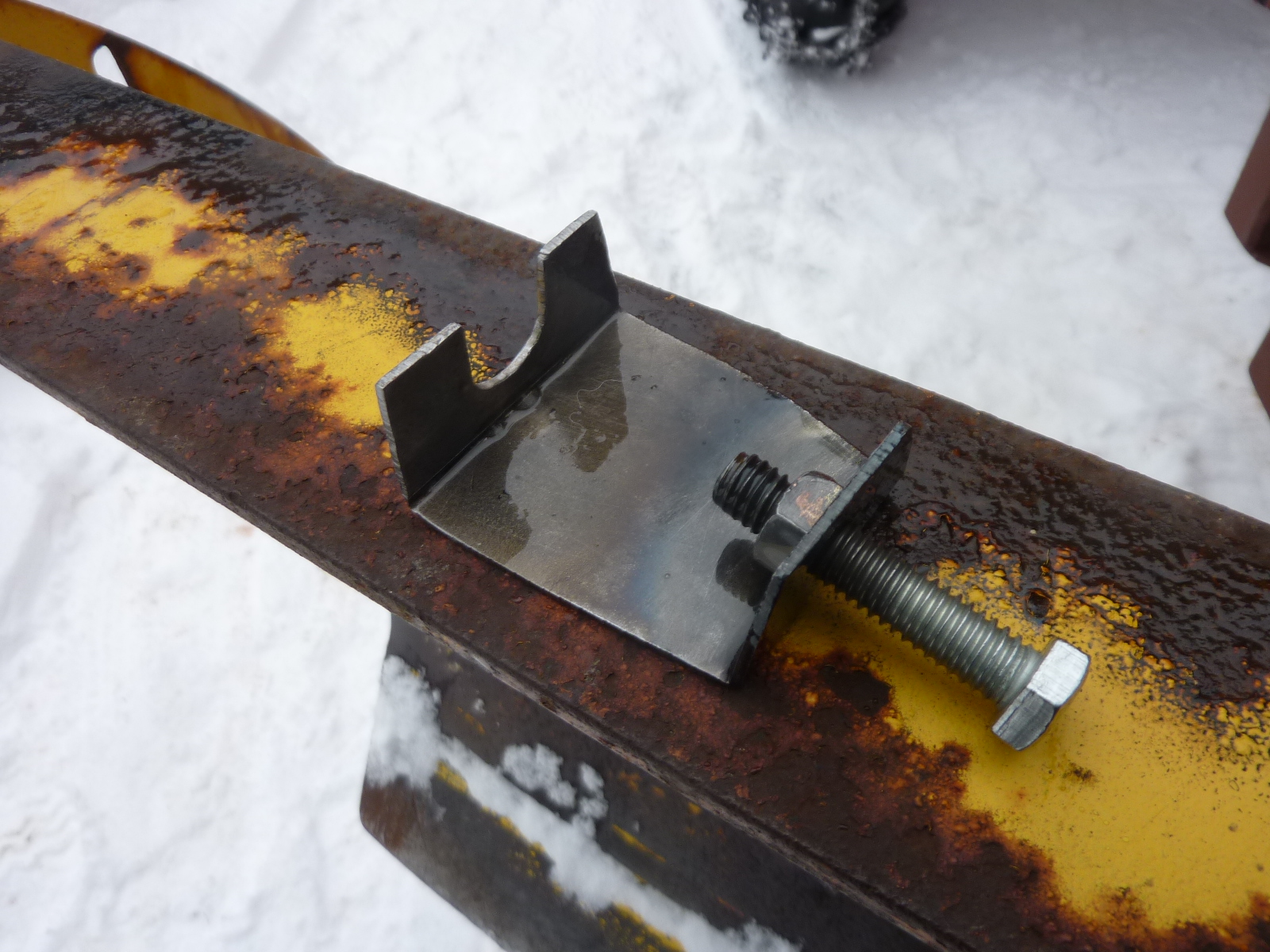

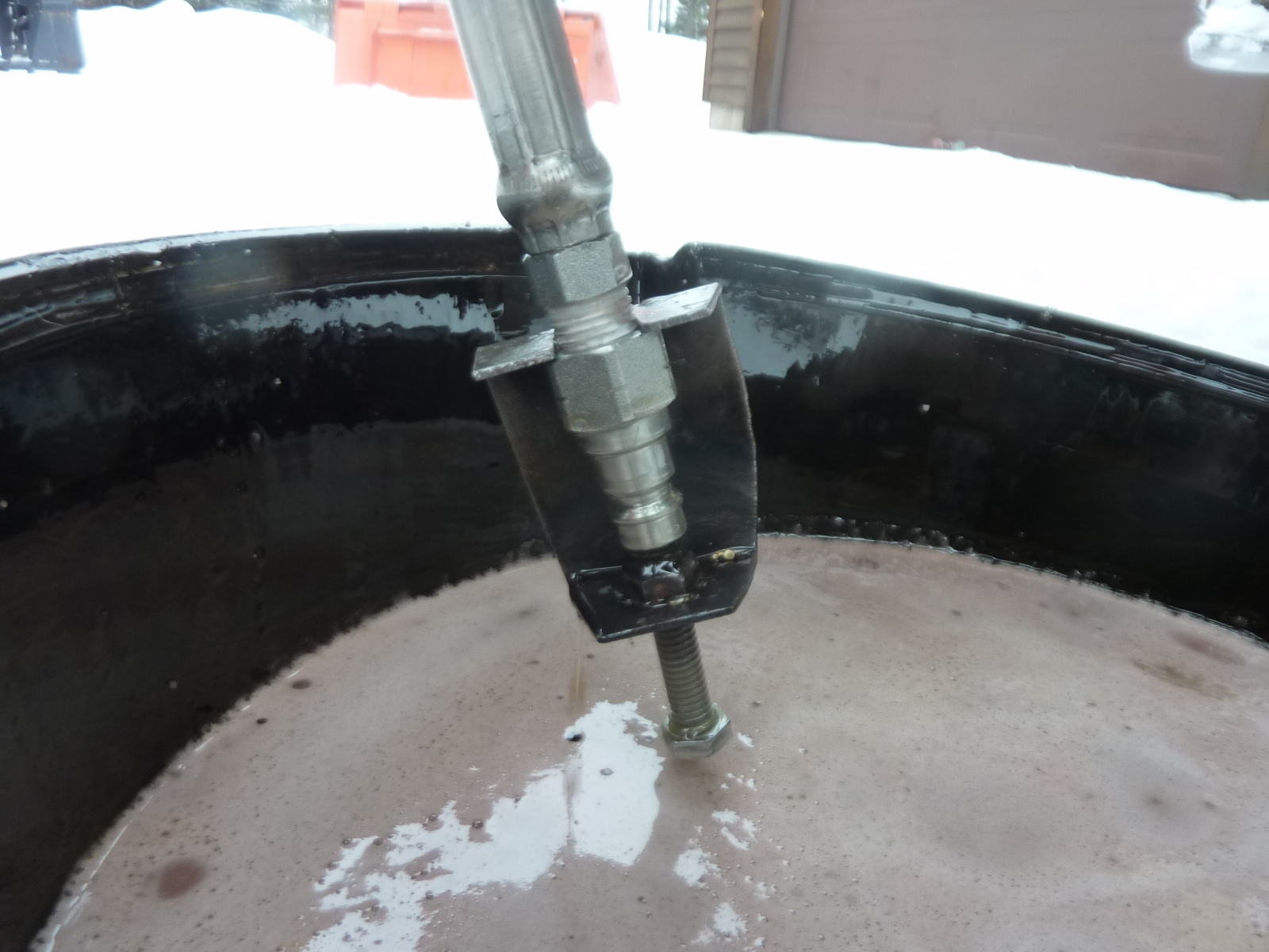

You could make one of these screw clamps to fit your coupler instead of using a hammer. Just a nut brazed to a bent piece of sheet metal with a half circle cut out of it and a bolt
gg

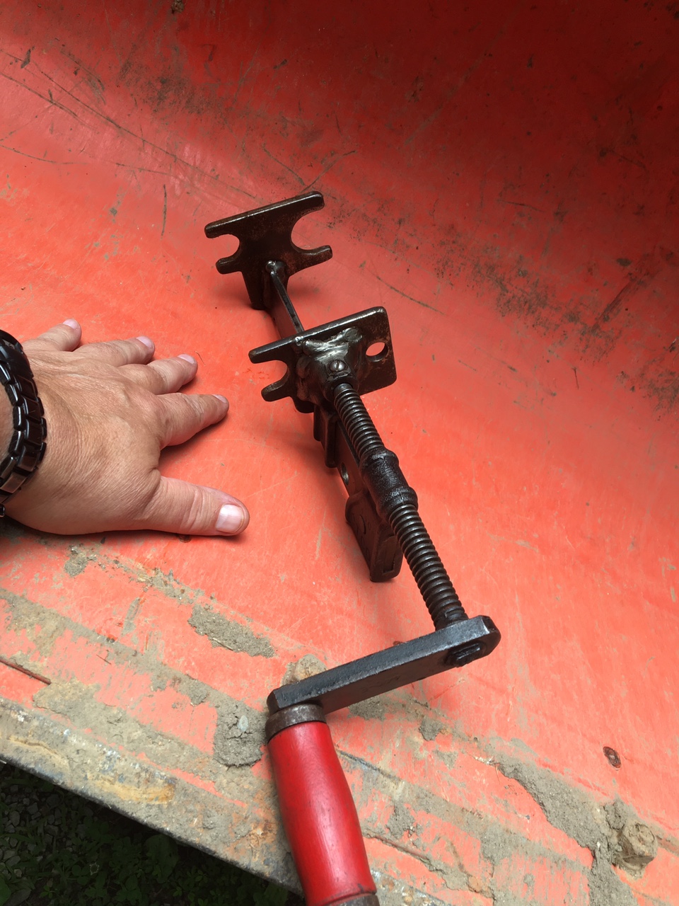

Best advice has been given for not having to loosen a fitting or punch a QD. Works 90% of the time. For a B20 backhoe QDs and flat faced connectors on the other loaders made this clamp to squeeze the couplers together.
Made from a broken piece from a bar clamp. Doesn’t take much pressure but more than I can do without a tool.
   / Connecting 3'rd function hydraulics on M59 #9
That's cool! Got a pic of it in use?
Thanks!!!
