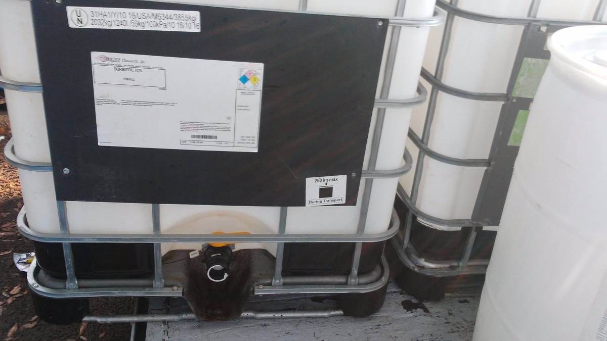

I have about 100 trees I plan to plant in remote spots on my property. I have grown them for two seasons in my nursery and they are about 3-4 feet tall. My experience has been that by planting in September the plants need minimal irrigation, but not zero irrigation. I usually just turn a hose on low volume and run it for about 15-30 minutes at the base of each.
In order to use a hose for these I'd have to run over 1000 feet of hose to some of them. I am thinking of using IBC totes on my forks and just setting one on the ground next to each grove of plants and let the water gravity-feed each plant from a hose connected to the IBC tote.
I have never seen an IBC tote up close. Is there an easy way to connect a garden hose? Do I need to epoxy a hose bib into the opening? Any ideas welcome.

Never used any myself but the totes I've seen are usually fitted with a ball valve. You should be able to find a reducer/adapter to fit and use as you want. Here is a site listing some IBC Tote valves.

If the tote doesn't have an existing place to connect, get a bulkhead fitting in the size you want and connect your own valve.
Just drill a hole and use a stiff wire to feed the inside part of the fitting into place, then screw the outside nut on. There's a gasket for the inside, so you should be able to keep the inside piece from spinning.

They usually have a valve and NPT male connection (2”). A couple of adapters from Homer and a hose bib you’re good to go. Just made one myself for refilling my buckthorn sprayer.

I use IBC totes for irrigation on my gardens. Most of the IBC totes have a valve with a 2" quick connect fitting. Some have a valve with a 2" NPT thread. You can get adapters to connect them a garden hose on FleaBay or Amazon.

We plant a lot of trees for shelterbelts. I started out setting two totes on a hay rack and then dragging hoses around to the trees. All the totes I've seen have a valve or a provision for one.
My current set up uses a 3/4" electric solenoid valve. I have a small loader with forks and I wired up a momentary push button switch. So now I can drive up to the tree, hit the switch for about 15 seconds, and drive on.
