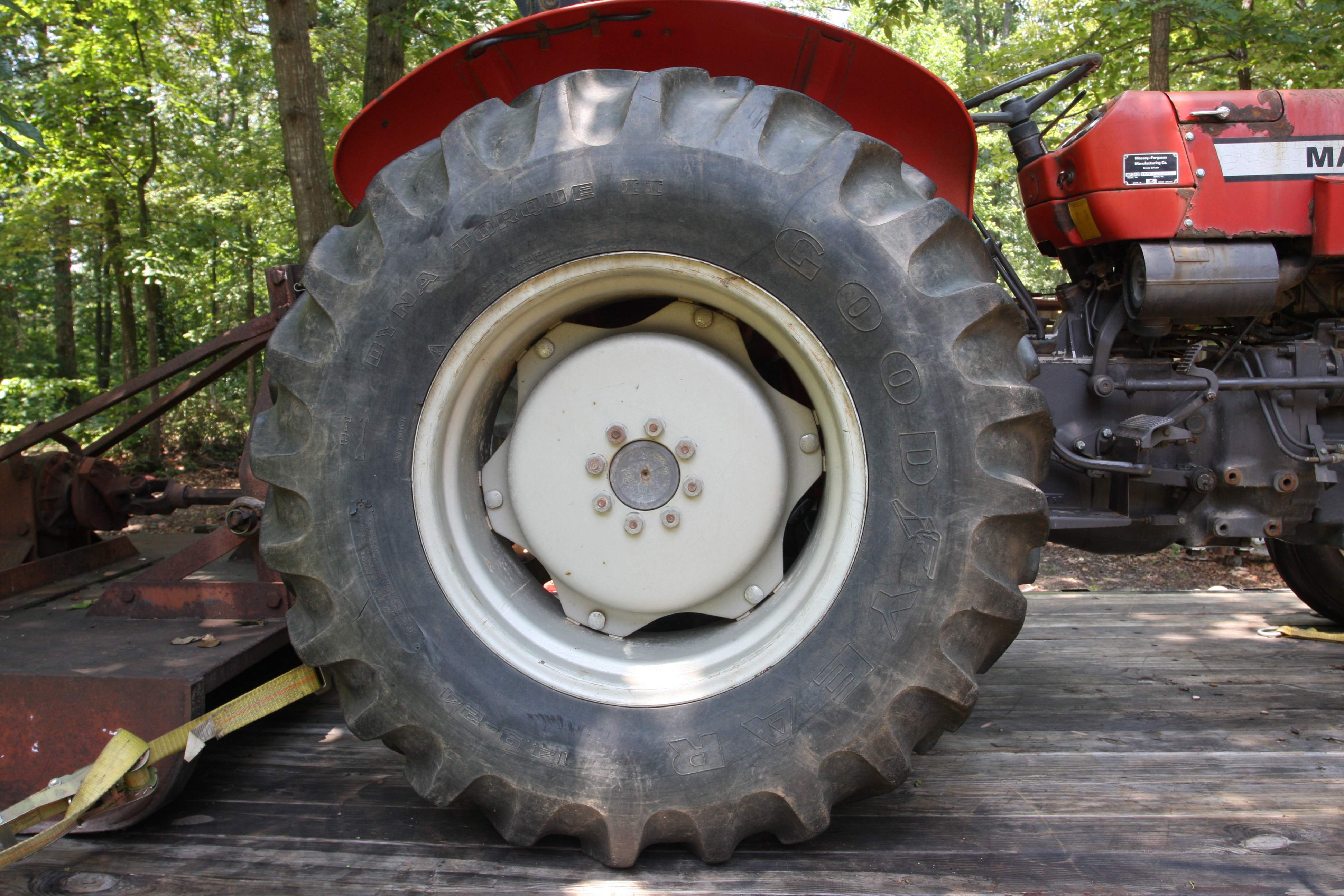

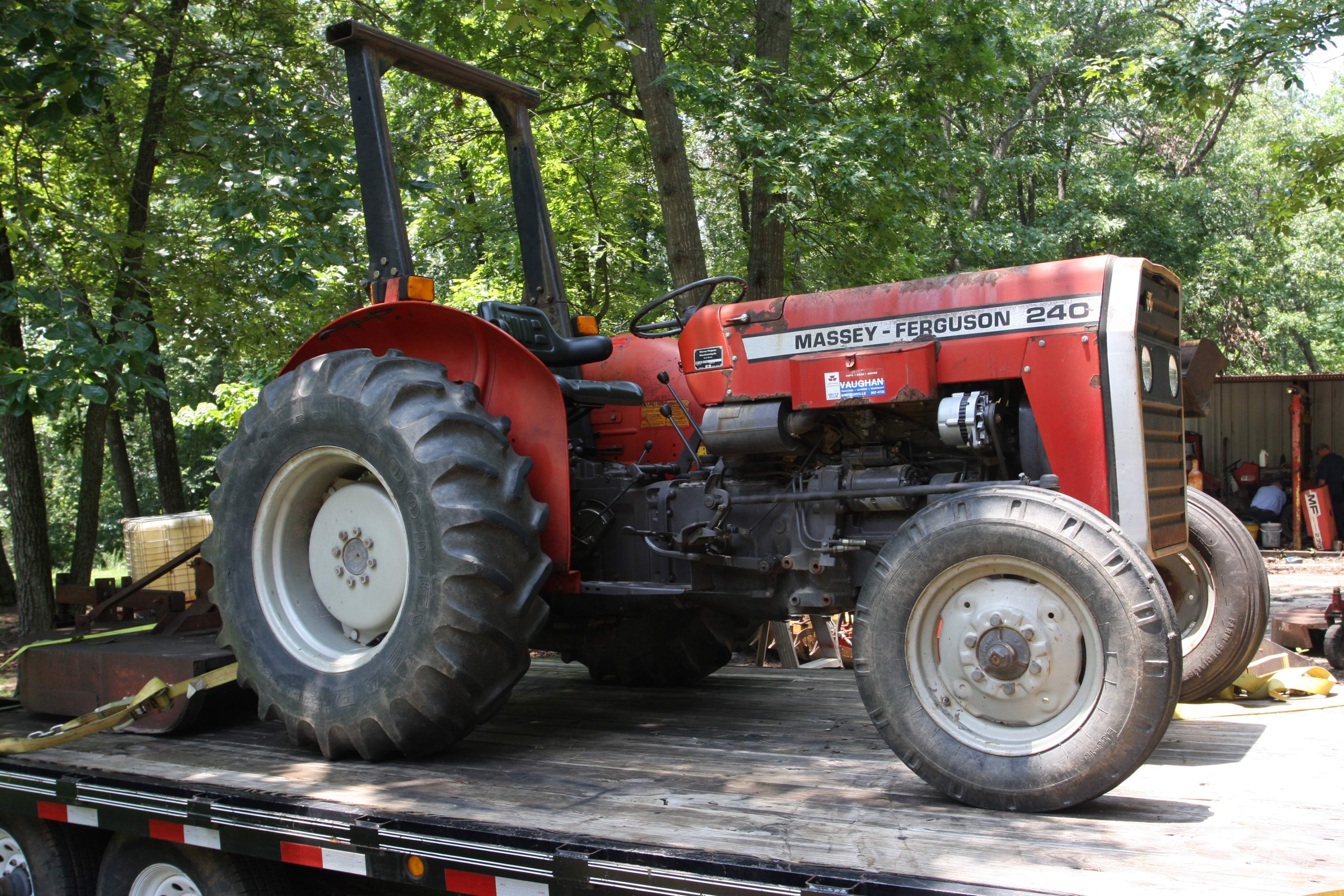

here are some pix. Do these tires look appropriate??

14.9x24 have a 22.4 inch load radius, 13.6x28 have a 23.6 inch load radius, slightly taller, and is size used on most tractors like yours. 24 inch is used more on industrial models, but some ag tractors did use them too. If your present wheels are good maybe sell or trade your new tires to get the size you need, would save finding wheels and centers to fit your new tires.
