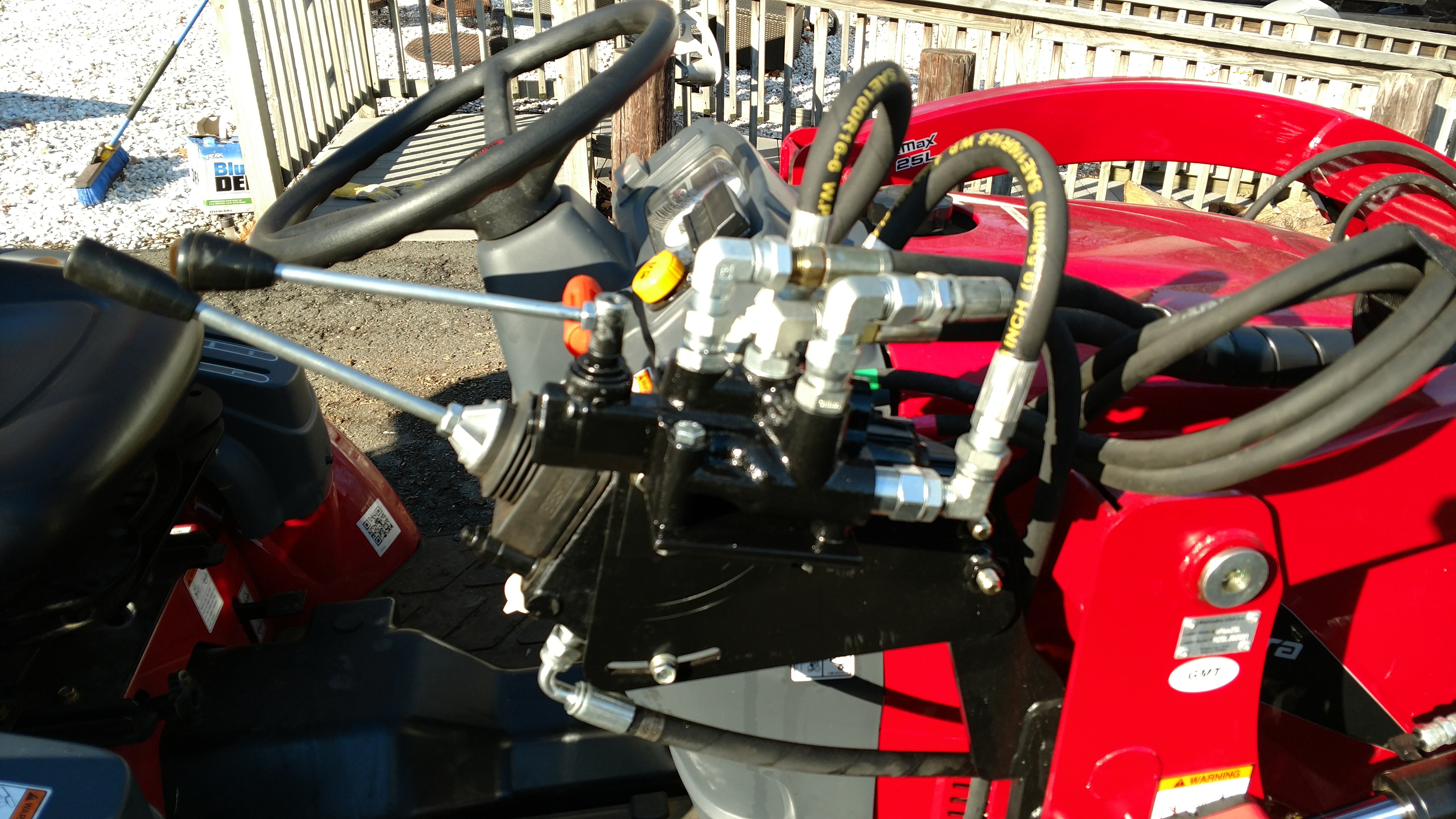

Hello All,
I am hoping someone may can help me understand what I actually need to add a grapple. I have a 2016 Mahindra 1533 and I ordered it with a backhoe. It's pretty straight forward if you do not have the backhoe I know. I am just a little confused on what I need (true 3rd function valve?) do I route my new hyd lines to the rear where my backhoe lines are plumbed? For the backhoe there are 3 connection behind the seat. If I recall 1PB, 1Pressure and a return.. I am going with the EA Grapple. I appreciate any advice.

Most valves have PB in and PB out. The idea would be to continue on with what is there- loader to BH to third function.
The true third function is an electric over hydraulic valve and the kit that EA sells has a good valve but is not rated for continuous use. If you need a valve rated for continuous use check out the one from CA Attachments. Idaho Implement and others sell that brand.
EA has a few videos that walk you through the install of the third function. CA's is below. If you have more questions I have called CA and had very good results. I hear EA is good as well.
One Touch Kit for Tractor Loaders - Installation - YouTube
This will be a good project but not overly complex. The hose from the BH PB to the third function valve may be custom length since the normal PB for the third function would come off the loader control.

I am fairly certain the main difference is you lose the ability to curl while open or closing the grapple. That would be a feature I would like to keep that feature via 3rd function electric valve. I was really hoping since I had an available circuit in the rear for my bh connections I may be able to use that but how to control. I am getting clearer as I read. I'm not Scientology clear yet, but I'm at least able to talk a bit better to EA or CA about my setup. I appreciate you guys taking the time to help a newbie out.

How is the backhoe circuit set up? is it a rear remote that the backhoe hooks to that is controlled via a lever? Or is it just a set of ports that have continuous flow and you have to loop the hoses back to eachother when the hoe is off.
If its a remote that already has a valve, that is your control. But rear remote controls are not always in the most convenient spot for loader work. Most people want a push button on the joystick. Thus the 3rd function or diverter. Which is the valve itself, controlled with the bushbutton.
If all you are looking for is a source for hydraulics for that valve, just pull it off the power beyond of the loader, and tie into the system that way.
