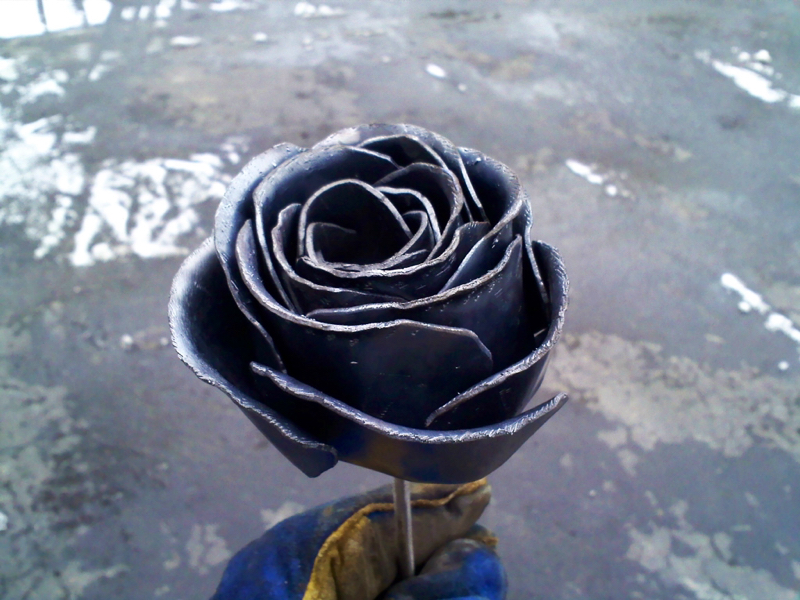

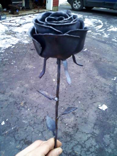

Here is a picture of some delicate pieces: torch welded, hammered flat on an anvil, & polished. Most of this same kind of work can also be done with TIG, it's just a matter of hooking a bead to something and then stringing it out with style. A torch is quieter though.

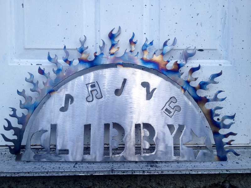

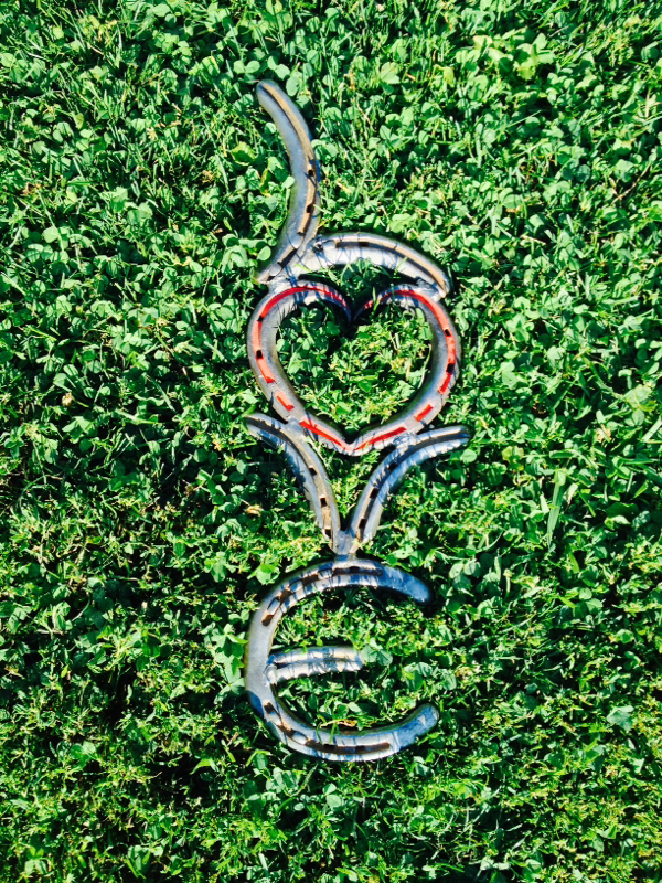

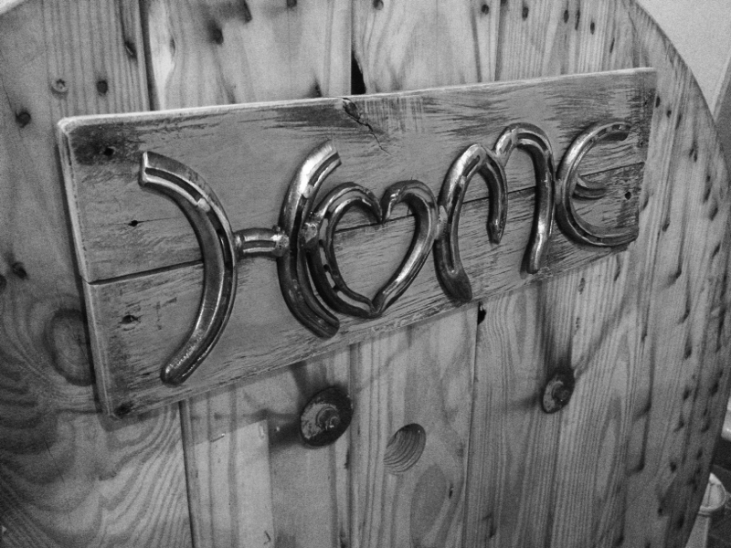

Beautiful work, rScotty! I've got a long way to go before I get to that! Here's some of the stuff I've done. I don't get nearly as much time to make stuff, but thoroughly enjoy the time I do get!
