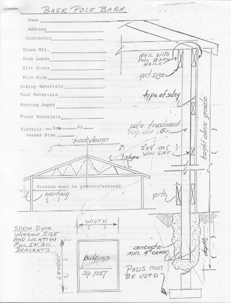

This has been touched on before but I wanted a central discussion on the topic. I set the first five posts of my pole barn last night and I want to get the holes filled as soon as possible. Some of you have said to use no concrete at all around the posts because it will make them rot sooner. Some of you have said to pour a 6" or so collar of concrete around the base and then back fill the rest of the hole with dirt or stone.
I submitted my pole barn plans to the township which stated that I would be setting the posts on concrete cookies and then pouring concrete around the posts. I did not state how high I would pour the concrete around the posts or the diameter of the cookie to be used. The only addition/correction the that building inspector who reviewed my plans made was to state that the cookie had to be a minimum of 14" in diameter. He did not state anything about the concrete around the posts. Now in reviewing all the documents I got from the township I found a sheet that they gave me which is a cross section of one wall of a pole barn (see attachment). They make you fill this out and submit it with your plans. As you can see on this sheet it shows concrete filled all the way up to grade and it says "concrete min. 4" cover".
Before I read on TBN about the possible problems with concrete around posts I was planning on filling them up fairly high. I have a very high water table here for half of the year and thought that concrete against the posts was better than water. After reading about the subject on TBN I was convinced to just pour a 6" or 8" collar of concrete around the posts and back fill them with sand. Now it looks as if I may have to fill them all the way up. I will try to get clarification from my township today but I wanted to hear your opinions again of the subject in case the inspector leaves the decision up to me.
Please post any links with solid information on this subject along with your opinions if you can. I am really interested in seeing some evidence about the concrete making the posts rot sooner or causing problems with heaving from frost.

Great subject! I've been wondering the same thing myself. I just bought a book on pole buildings "Monte Burche's Pole Building Projects" copyright 1993. It says the poles can be wholly or partially embedded in concrete and they say to round the top of the concrete off so water will run away from the pole. I talked to the guy the local building codes office and he said there are no codes covering it and there are varying opinions on whether to use concrete or not. One opinion is that the concrete leaves no way for water to drain away from the pole if it does get in between the concrete and the pole. So, if was sealed off good at the top it would be OK. He said some people use gravel to backfill the poles so moisture can drain away easier. He said around here most people just backfill with the dirt. He agreed with me on the opinion that there is not much advantage to concrete since it's going to meet up with dirt eventually anyway, all the concrete is going to do is increase the dia of the pole at the bottom.
My opinion is that unless you're going to pour a concrete floor at the same time and tie the concrete for the poles in with the concrete floor using rebar, then there's no reason to use concrete. So, I don't plan to use concrete on the pole barn I'm planning to build this fall. I'm planning to just put the dirt back in, or might go with the gravel idea, I'm not sure yet. It seems like the gravel wouldn't pack as well though. One idea I though of is to put a layer of gravel or maybe some sand about 6 inches thick, then put the dirt back in. That would give the water a place to drain out at the bottom of the pole, while still have the clay packed around the rest of the pole.
Hopefully this thread will help me out too!
One more thing I just thought of is this. The pressure on the pole is straight down (unless the builder didn’t get it plumb), so what is the advantage of concrete around it? The footer on the bottom is the important thing – it’s purpose is to keep the pole from sinking or settling vertically. Nothing is going to try to move the pole horizontally, unless someone drives into it in which case it would probably break before it moved, with or without concrete. I can see where if the footer at the bottom was a smooth surface and not level, then the bottom of the pole might want to slide one way or another. But, since the pole is in 3 feet of dirt, the dirt should be enough to keep it in place. At least it seems like it to me, but I’m not an expert!

Spencer - I'm a little disappointed how fast this thread died out! I bought some <A target="_blank" HREF=http://www.hometime.com/Admin/shopsite/p_7074.htm>plans</A> at a lumberyard this weekend that has plans for 5 sizes of pole barns, 24'x24' through 40'x64', with 8', 10', or 12' high walls. The plans are from a company called Garlinghouse. They show a footer at the bottom of the post, then a gap of a mix of sand and gravel, then a layer of concrete 18" long going all the way to the top, so it doesn't form a cup and leaves a place for the water to run out.

Danny,
That sounds like a logical way of doing it. I might have done it that way had you came across that earlier. I went down to the township offices to see what I "had" to do. The inspector wasn't in so one of the girls in the office called him on the two-way. He said that the concrete cookie was all that was neccessary.
I already had the posts sitting on the cookies and I had already put spikes through the posts about 4" to 6" from the bottom. I poured in about 10" of concrete, angled it away from the post on all sides, and let that cure overnite. I then put in about 6" of the 60/40 gravel-sand mixture and filled the rest with clean fill sand. I put in about 5 shovel fulls at a time and then tamped that down. Each tamped layer was about 3" thick so it took me all day just to do five posts. I was using a 2"x4" to tamp with on the first five holes. I stated the next two posts on Sunday and I switched over to using a landscape timber to tamp with. I didn't measure it but it is probably around 3"x5" (2.5"x4.5" actual). It sure does go a lot faster tamping with the landscape timber but I don't think I am getting it quite as compact as when I used the 2"x4".
