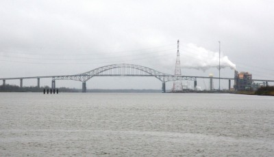

My first full time regular job was working as a concrete inspector for the Louisiana Highway dept. in 1965. They were building the Paris Road Bridge over the new man made Mississippi River Gulf Outlet. When we poured the foundation for the piers that sat in the Outlet, we had one concrete plant dedicated to just that job with 20 trucks rolling continuously and we worked 30 hours straight to finish the pour. I don't remember how many yards it was but it was huge.
Now they have blockaded off the Gulf Outlet after it was proven that it caused the main flooding in New Orleans after Katrina. Oh well, one more multi-billion dollar boondoggle.
