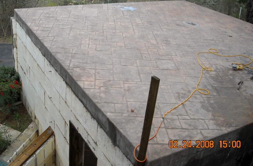

I'm in the need to build to build some additional explosive storage magazines and have some questions on concrete spans. The two current magazines I've built are as follows
1. 12'x20'. All poured concrete, walls, floor, and ceiling at 8" thick.
2. 14'x24' Concrete floor and ceiling at 8" thick. Walls were concrete block - dry stacked with surface bond.
My question is in regards to the concrete roof. Minimum thickness to meet ATF spec is 8" thick. I would like to make a larger magazine than in the past, preferably 20'x32' but 16'x32 would work as well. What I'm not sure about is how far I can safely clear span the concrete roof at 8" thick and the amount of rebar required to do it.
Below is a picture of the 14'x24' magazine we built a few years ago using block.
Jeremy

The first two buildings we did (12x20 & 14x24) were poured 8" thick with a rebar grid of 12" on center and placed 3" from bottom. These were poured 4 years ago and to-date there is not a single crack in the roof structure. I may just stick with the 14' span and increase the length of the building. This only places the inside span with 8" walls at just over 12'.

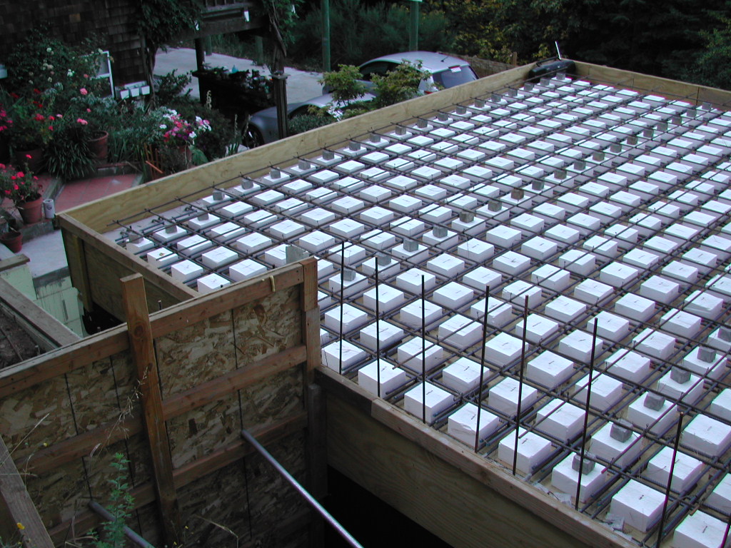

I designed this concrete roof last year. It is 8" thick with dual #5s at the
bottom of each "beam", both ways. The foam blocks are there to reduce
weight. I simplified the design to be a bunch of parallel T-shaped beams,
8" wide at the top and 4" wide at the bottom. The span is 20' both ways.
For max strength the bottom bars are 1" from the bottom form. Shoring
was done with 2x4s on end 18" OC both ways.

/ Concrete Questions? #16
Very nice!!!
/ Concrete Questions? #18
What coverage does the rebar require to meet your codes?:D
As I recall from the ACI 318, you can have as little as 3/4" of cover over
the bars, if the concrete is not exposed to soil, as in the outside wall of
a basement. This is an inside ceiling, so the 3/4" would apply, though
I specced 1", knowing the installers would not be very careful.
