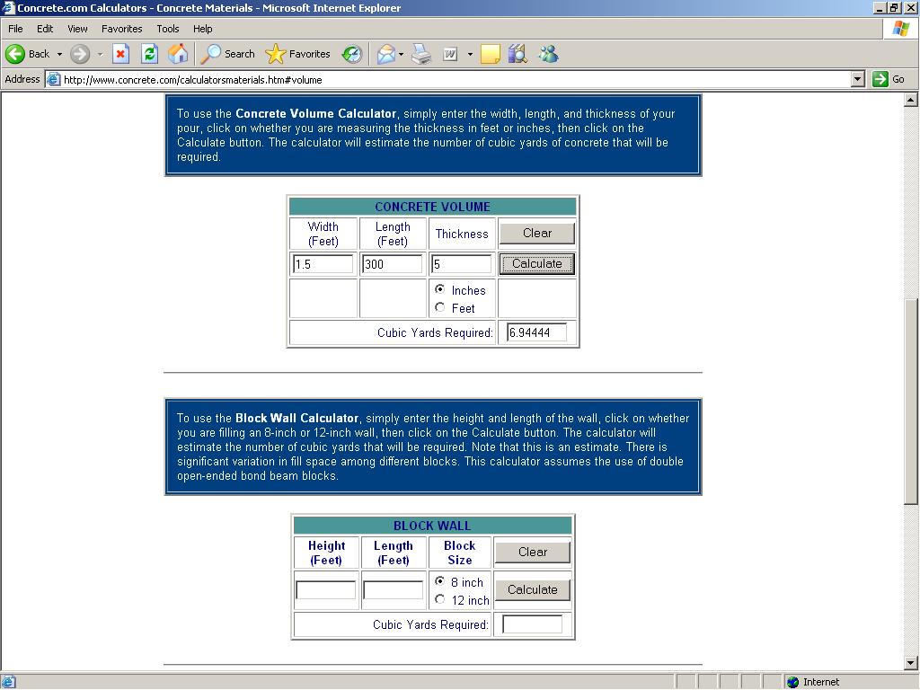

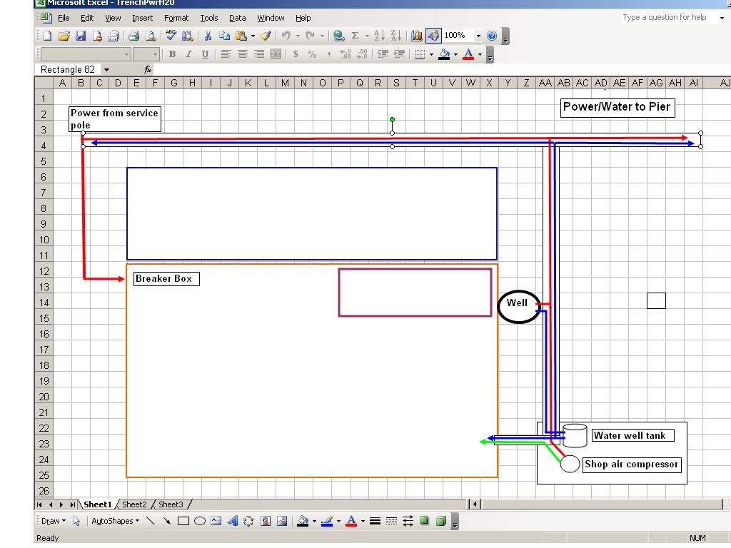

If city codes allow I plan on running my power and water lines in same 18" wide (width of B/H bucket) ~2.5-3' deep. Its common practice here at the plant to cover power lines with red dyed concrete to identify and protect the lines.
A quick check with a concrete calculator shows me using about 7 yards to obtain 5" layer of concrete for 300' of trench. Cutting a few concrete come alongs down to 16" width and a truck driver willing to work with you it does not seem like a difficult task.
Other than the hassle of dealing with the concrete if you ever had to dig the lines up is this a good idea???
Here is my plan:
Thanks for any feedback. Chuck.

Is the concrete a code requirement? Around here, the EL is just covered with a layer of sand (about 5") before back filling the trench.

Typically you are required to run the water below the power line. IMHO I wouldn't run both in the same trench. If you have problems with the water you need to disable the power to work on it. As far as concrete over the power only if code requires it.

hardly ever have to dig up electrical lines if correct conductor and conduit is chosen.
water lines different story.
i vote for not co-locating and not doing anything you don't have to for residential service.
some kind of marking tape laid in the trench above the line is a good idea and use the correct color conduit (grey for elec, white for water) is important.

I've been on alot of government jobs that required the duct bank to have concrete, but that was only high voltage, and even then, it was on 3." If it is low voltage, (under 480v) save your money. If you want to feel better about not cutting into the electric next time you dig, use some flagging tape in the backfill about a foot or so above the wires. (They do make actual trench tape, but flagging will be fine.)

I wouldn't bother. But I would use conduit and electrical marking tape - the steel kind that the detectors can find.
I wouldn't sweat the water and electrical in the same hole if you are understanding the compromise you are making, and that fixing the water down the road might be a pain. Even so I'd separate the 2 lines as much as possible in the trench - either side would give an 18" separation.
Take pictures of where you put in the trench... you'll find its hard to remember 6 months later. At least for me!
