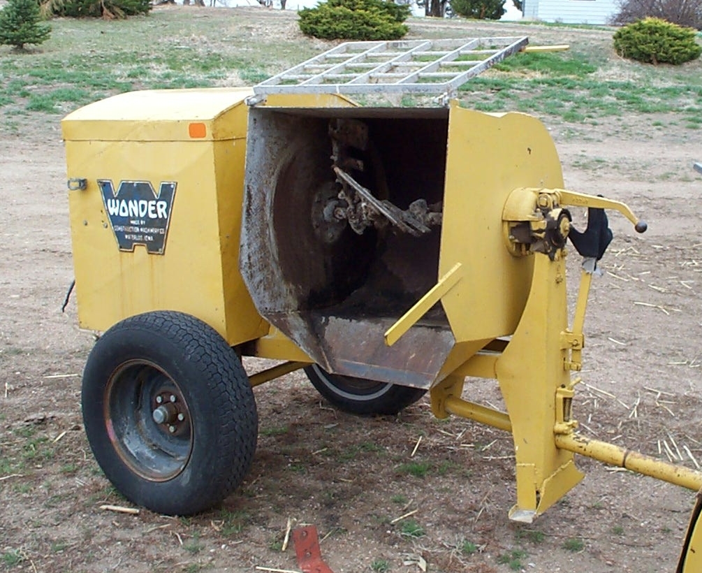

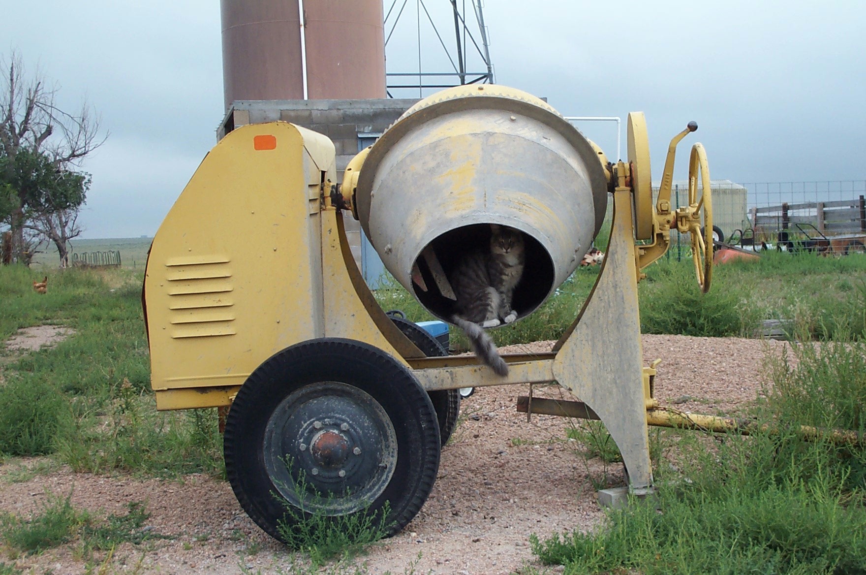

I have two different mixers, and since I am older and don't have the steam that I did 20 years ago, getting them loaded is getting to be a lot of work, and dealing with 100 pound bags of cement or mortar cement,
or even dealing with 80 pound pre mix,
years ago (basically pre redimix) many of the mixers had a hopper on them to load them, usually some type of winch system to lift the hopper,

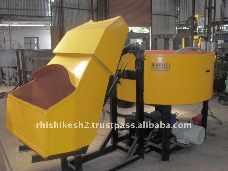

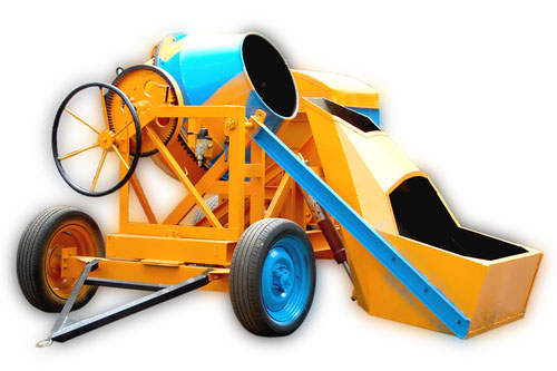

two of the pic are of my mixers, and two of them of a hopper loader,
now my idea is to build one hopper lift, that would work for both units, I see the new ones use hydraulic cylinder, for the lift,
one mixer is electric and one is gas, I would need a power pack, (could rig some type of pump on a lawn tractor and reservoir),
the other ideas that have crossed my mind is a lift and a bucket that would have slider bottom,
some thing like a ladder lift for putting shingles on the roof but a hopper and just the height of the mixer,
even a swing hoist, (picture)
on a ladder type hoist could consider a lawn tractor to pull a rope, for the lift if the dump was automatic,
how would you go about making a loading system that could handle a few hundred pounds, per load, and would work for both machines? and yes some what portable, either attach wheels or have it on wheels for towablity,
I could weld a tab or a few tabs that could be pined ot the mixer to keep things together, and not move apart,
I want some thing that would be easy and not take 10 mins, to dump or load each bucket/hopper load,
IDEAS, ANY ONE?
