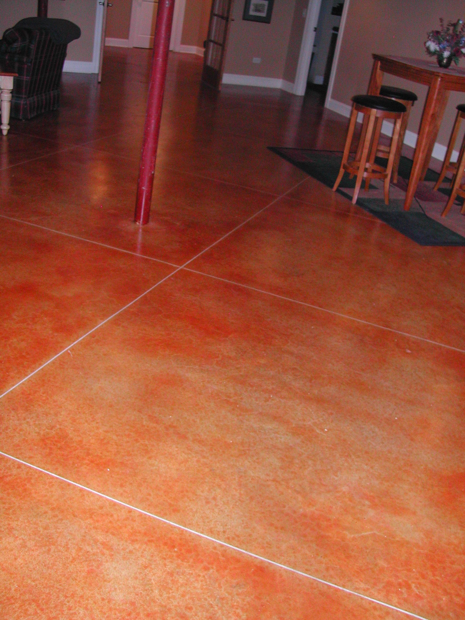

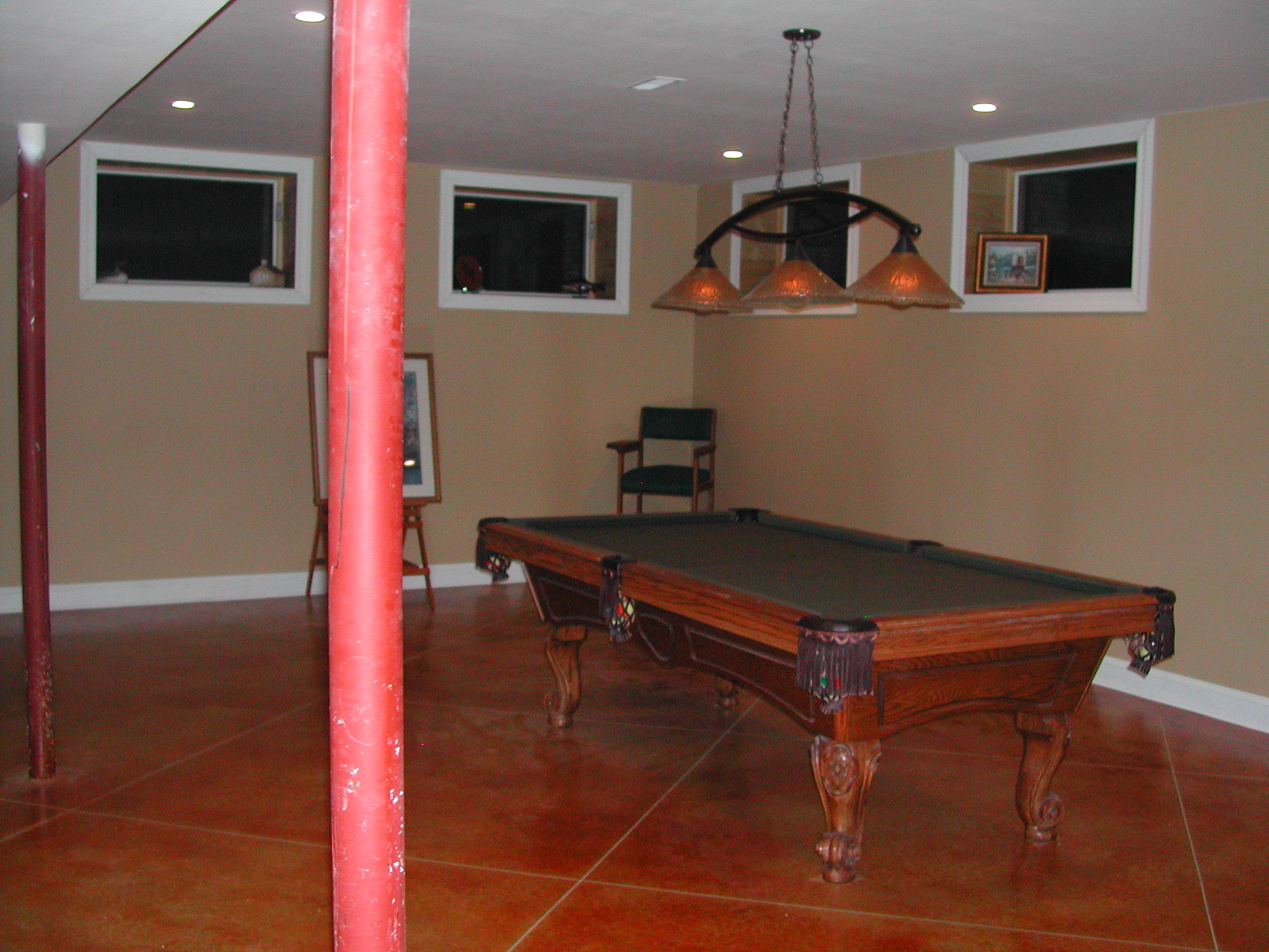

Unless I missed it you don't really say where you are doing it. I am no expert but I do have one experience with my basement floor that turned out nice. My view most of what is being talked about here is a topical coating to the contrete. What I did was an acid stain tot he concrete. First I masked out a tile pattern using 1/4" tape on the floor(used a laser to give me nice straight lines). I then diluted the lightest color stain 2 parts water to one part stain and sprayed it on the bare concrete (you can always go darker with a second coat). As I understand it the "acid" nature of stain now starts a chemical reaction with the "basic" nature of the concrete. Its not so much that you are color coating the top of the concrete but you have a chemical reactio that is changing the top 1/8th inch of the concrete. After several hours you wash it down with a mixture of baking soda and water that stops the chemical reaction. After it 48 hours to dry I put a poly sealer on. I did 1300 square feet for 3 or $400. Works in a basement but the poly part would not hold up in my garage. ConcreteDepot.net is were I got the stain/sealer (Have not seen it at HD or lowes) . Also check GarageJournal.com as they have a great flooing sction on that forum. It looks better now 5 years later as I have probably put 3 more coats of poly on it. For a basement it is almost indestrucable and we have hot water heat in the floors so it is comfortable.
