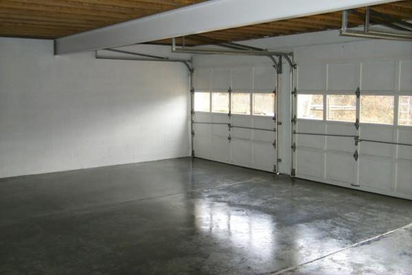

Dummy, Howdy neighbor! I had my 24'x32' (768 sq.ft.)Barn Basement all ready for pouring as you have stated and I ended up paying $400 to a fellow that I have used in the past. That price may be a bit high but the guy has good work ethics,
The finish came out super smooth ,I sealed it with the $100 for 5gal. stuff (polymer resin)from Chaney Enterprise...
As far as the apron goes 23'x30' that will cost about the same as a smooth finish.. If you weren't intimidated by the overall size and had some help I would do the exposed aggregate myself and $ave you need some formula S retarder (5gal $80) plastic to cover area and a stiff broom or two,garden sprayer ,hose etc..... WHEW I'm tired already /forums/images/graemlins/ooo.gif

<font color="blue"> If you weren't intimidated by the overall size and had some help I would do the exposed aggregate myself </font> Been there, done that as the saying goes. Every once in a great while (not too often), I am better off parting with dollars to get a pro. Larger projects like this are one of them. You only get one opportunity for success (without jackhammers /forums/images/graemlins/wink.gif). Your floor looks like it turned out very nice. I like dealing with Belair road supply and Carruth when possible. Chaney's getting a little too big for the average homeowner. Did you know they have a 7 yard minimum now?
BTW, I'm over in Rison from a picture you posted before and the Chaney "concrete store" fact, are you in the lower LaPlata / Faulkner area?
