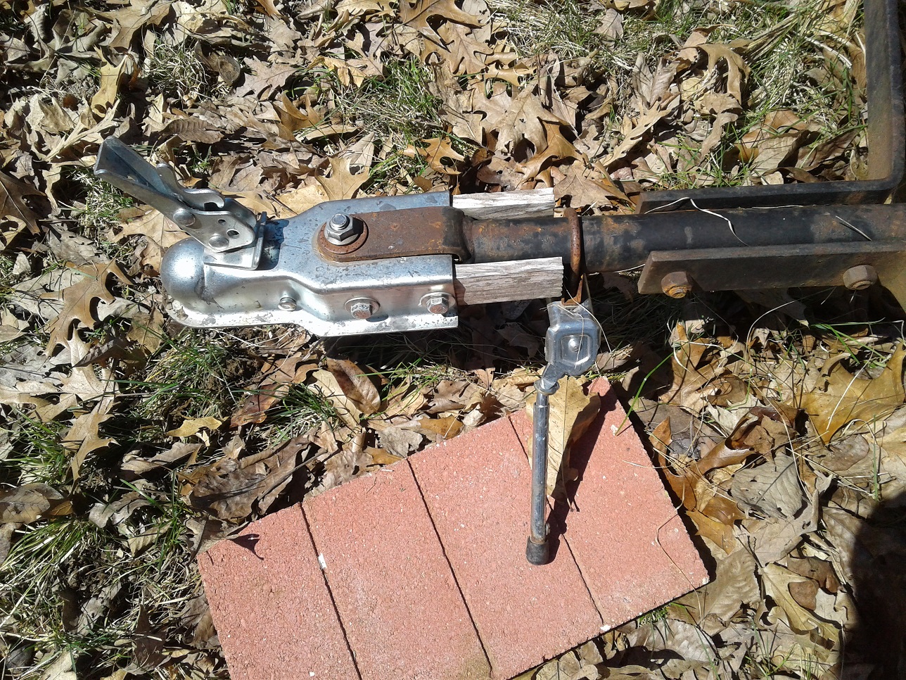

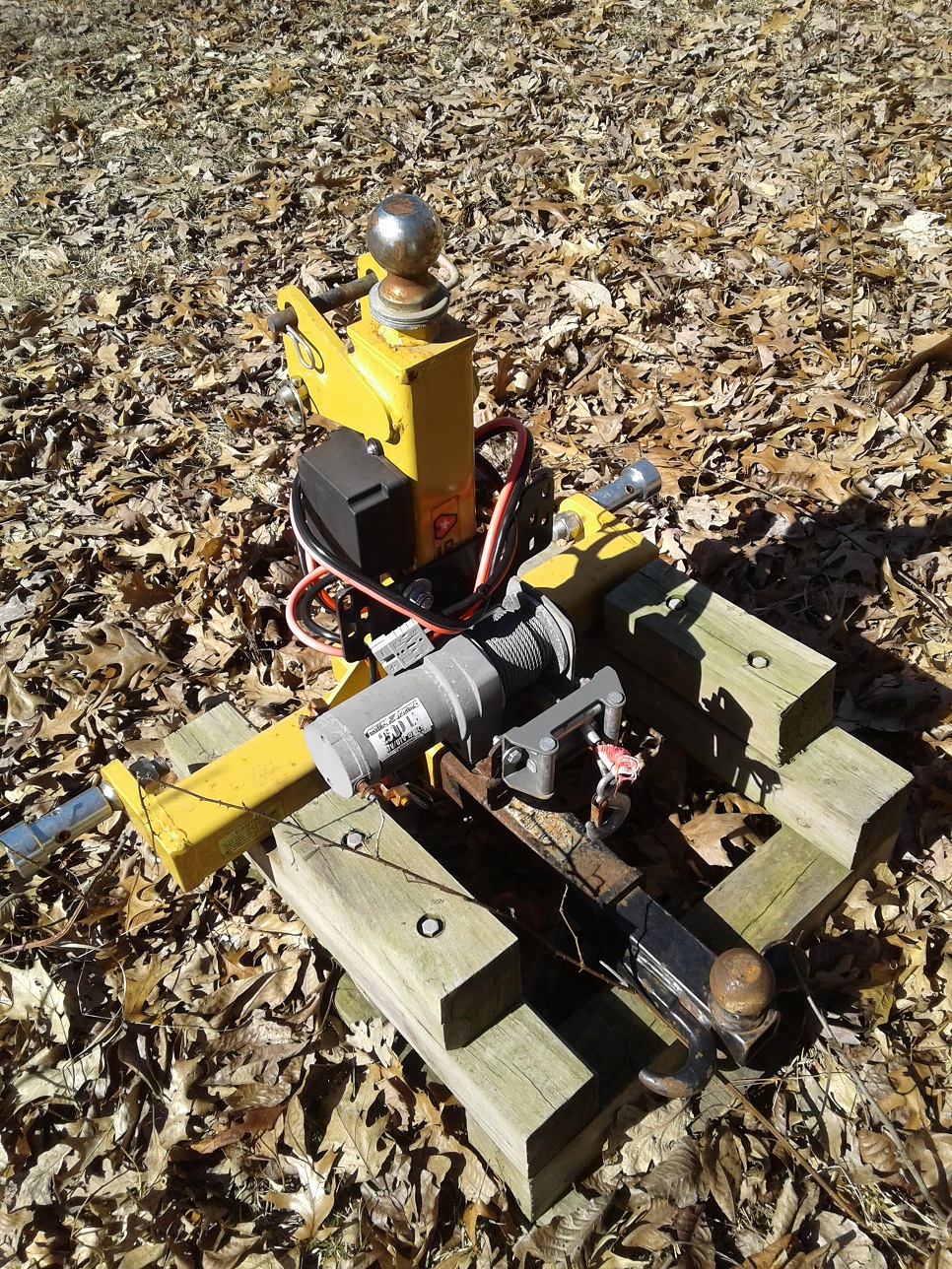

I bought a used 24" by 4' roller at auction cheap because the end plate leaked (rust holes). I set roller on end atop 3 or 4 cement blocks, used angle grinder to cut decent size fill hole. Filled with cement and allowed to cure a couple of days. This thing now weighs over 1 ton. I modified the hitch by attaching an automotive style trailer coupler and a bicycle kickstand. Place trailer ball om mower to back under it. I first used riding lawn mower to pull it. It takes 20+ HP to pull it, if tractor is too small (lightweight) it will push the rear end when you try to turn. After buying a BX2370 Kubota, I bought a 3pt trailer mover to connect to the beast, works great.
Things to consider - HP of your tractor, size of your roller and cement won't go down a 1" fill hole, It's trying to setup after mixing.
