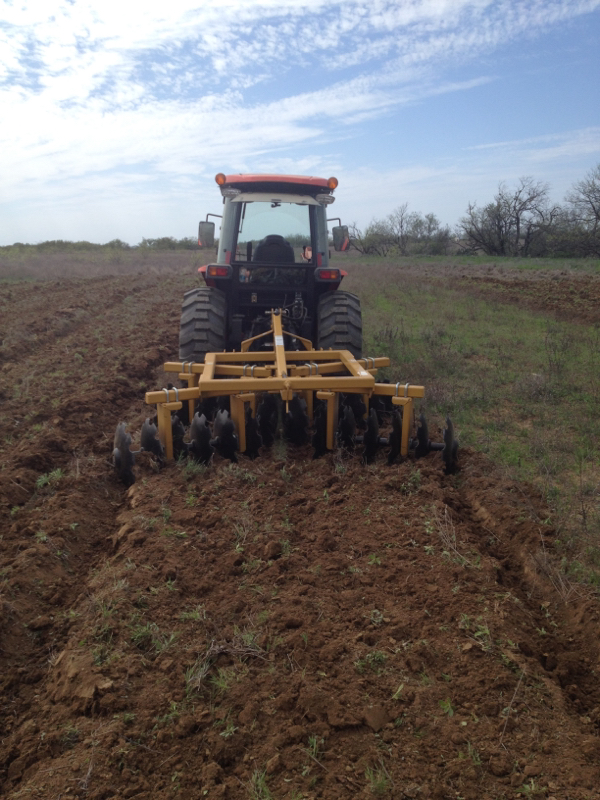

I have no concerns. We plow, disc, rip, etc. Does the tractor's HST whine? Sure. But it whines whenever I push snow or do other forceful work too and I just keep going. SUDT-2 takes a lot of the whine out, BTW, but not all of it. Nature of the beast but I don't allow the whining to stop me from doing whatever I need to do. It's a tractor. I bought it to do work and work it does. Don't over think it, I guess.
