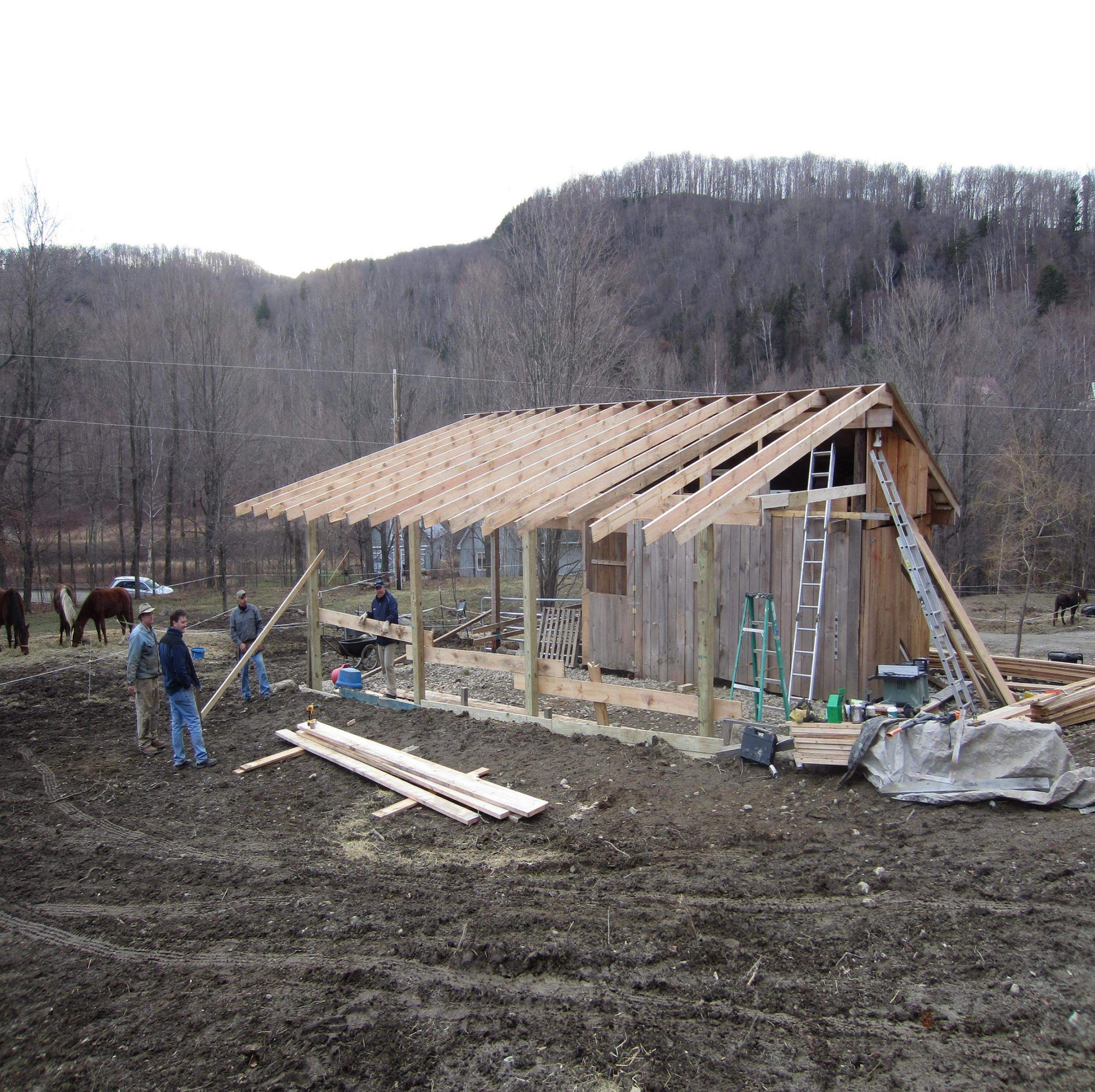

Pictures from last November adding roof to other side of our 12x40 horse barn. Had to cut into slope and add rocks on the uphill side; which only our 4720 Branson TLB made possible - sure couldn't have done it with a shovel! Had to use the backhoe for the post holes also, due to the rocks.
Rafters are 22 foot long 2x8 rough cut hemlock cut from our farm, secured with plywood gussets. Hauling those up and holding them in place while screwing them together was the only part I couldn't do by myself - THANKS Jeff, Pat, Steve, Brian, Warren and Rich!
After the pictures were taken I got the metal roofing screwed on (sheets of 22 foot tin all by myself, by the way), and before putting on the roof added 2x8 joists to increase the snow loads it could bear and give some loft space. and it weathered the relatively mild winter just fine. After the weather cools a bit this fall, intend to add more bracing. Sorry for just the single pic!

I've put up 17' sheets on a 4/12 pitch. 22' would be even harder. I had to wait for calm days, wind wanted to carry away the sheets. Hardest part is getting the first one right (Square) and holding it there to check before fastening it down.

22 footers were awfully fun to drag up there and screw down! Even a light breeze wanted to move it around, and I had to get body weight on it quick when that happened. Wore those heavy knee pads with a textured rubber face to them. They really worked to keep me from sliding around/off.
I was mighty lucky we had a late and mild winter. The last sheet of tin was screwed down in December! Around here we usually have a couple of feet of snow on the ground by Christmas.
Walls and a roof are powerful handy - even if it's salvaged from shipping crates. My tractor shed is built of scrap lumber and used tin. I'm lucky to have 40 acres of woods to use for lumber or I couldn't have built the barn - the new tin for the roof cost more than I wanted to pay, but I don't have a ready cheap source for that!
