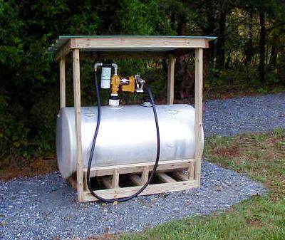

I finally finished setting up my re-fueling tank today. Nothing all that exciting but after finishing a tractor project I always feel compelled to post it! /forums/images/graemlins/wink.gif
It's made from a 150 Gallon tractor-trailer fuel tank. It's got a 12v Fill-Rite Fuel pump on it with a combination particle/water filter. I couldn't stand the thought of it getting all the weather so I built a small roof over it. I paid $155 for the pump which is a good price. If anyones interested in getting one I will post the information.

Looks great. Yes, I'd like info on where to get the pump and tank. How do you power the 12V pump?

I bought the pump on E-Bay but it hooked me up with a great supplier. The company is Neumayer Equipt. I forget where they're located but they have been supplying equipment for new construction of gas stations for 50 years. I know re-fueling a tractor is not exactly rocket science, but these guys are experts and can advise you on all the details as well as sell you everything you need. Filters, nozzles...whatever. They even sold me all the elbows and nipples needed to hook up the filter system at half of what I would pay locally. They also handle the warranty on Fill-rite products. The guys name is Sam Hanephin at Sam_Hanephin@neumayerequipment.com. The phone number is 1-800-843-4563. You can check for them on E-bay but I'd bet he sell you one for the same price as I paid.
Getting a tank is a local search mission. We have one of those free ad papers here and there are 275 gallon fuel oil tanks in there all the time for free. I really didn't want a tank that big so I held out. Through a friend of a friend I got this 150 Gallon tank that came off of a semi rig. It was dented on the bottom but free. It was just the right size and I like that it is aluminum.
As far as power I have an old deep cycle battery from one of my boats. I plan to put a solar trickle charger on it to keep it up to snuff. You can go here
to read a thread I started on those recently. Of course you can just clamp it to your tractor battery if it's convenient.

OK I'll bite.... how do you re-fill the 150 tank? Looks like a pretty permanent home for the tank.
I just use a 55gal HDPE drum and can load that into the back of my truck for the trip to the fuel stop. Then roll it off into my loader and then set it up high enough to feed the tractor.
How do you vent it to the outside to relieve the press?

Dont forget you need a ground rod and strap for your tank.
