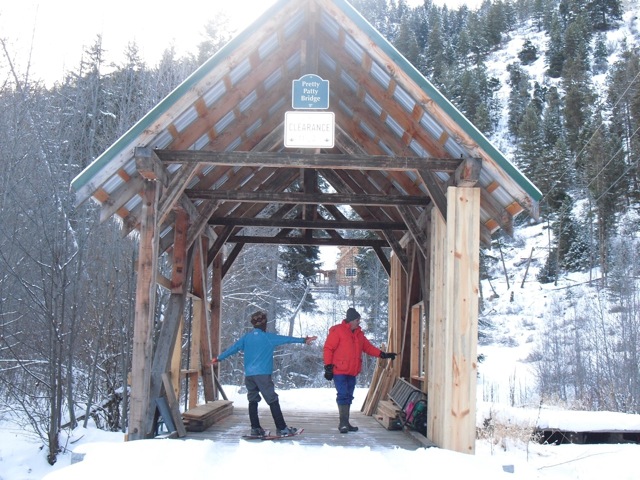

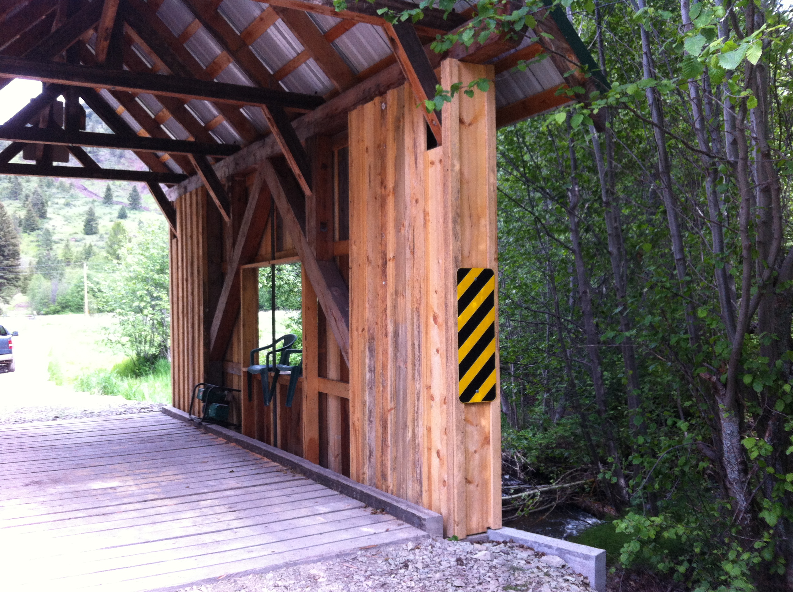

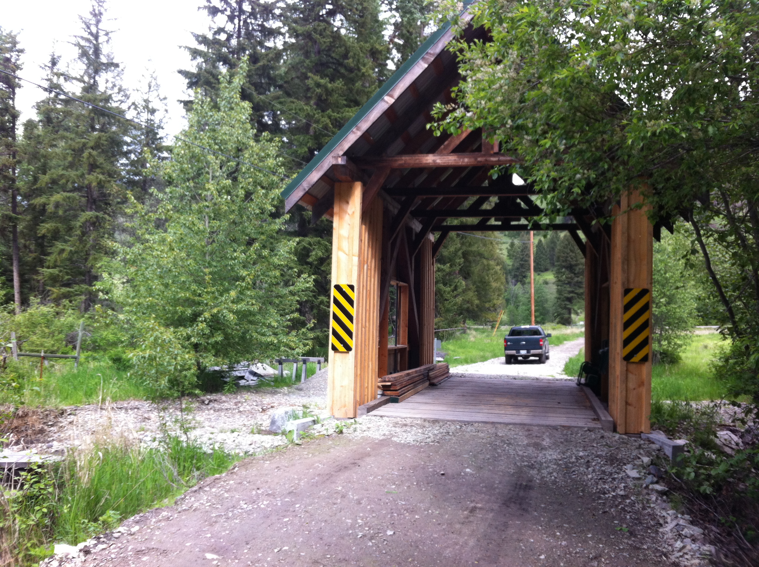

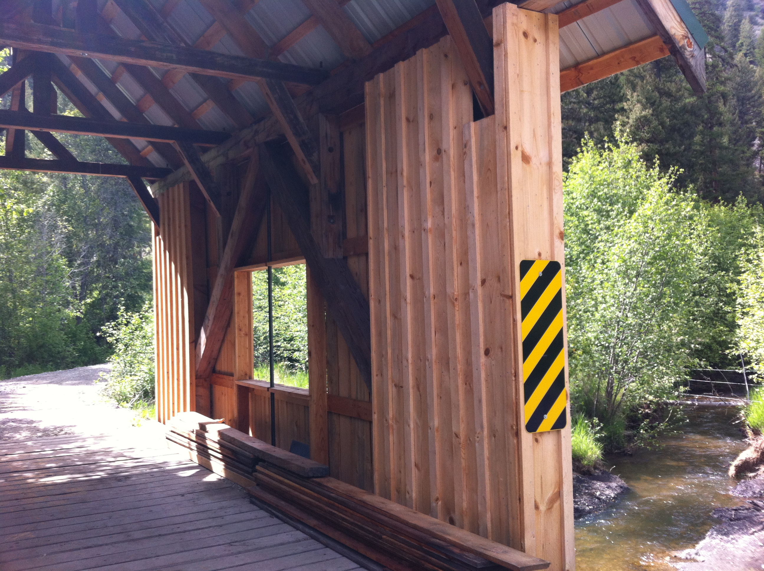

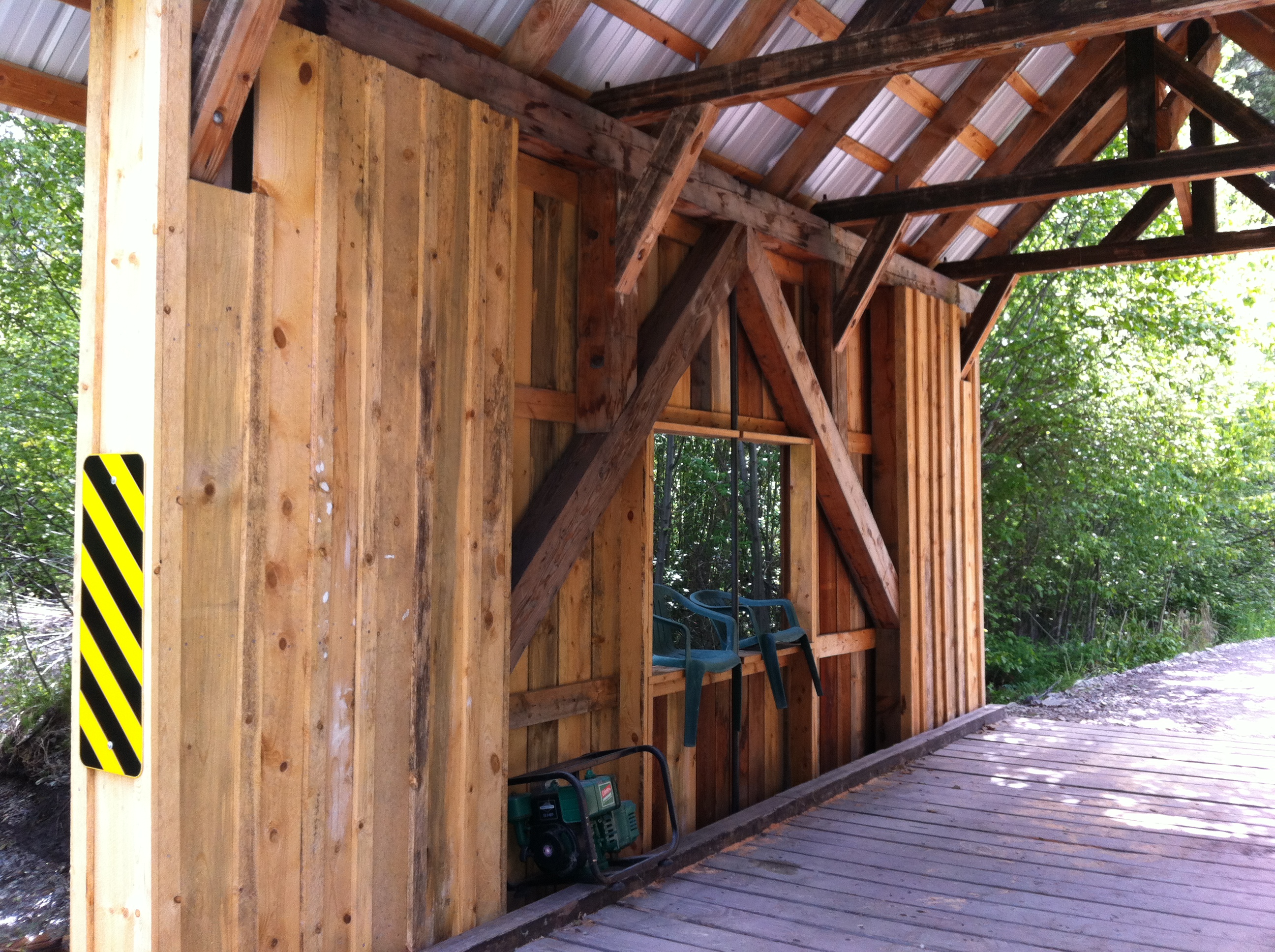

I've been a long time recipient of much useful information provided by TBN posters. Thank you all. For those amongst you interested in bridges here's one that I designed and built to access my log home which is situated on the other side of a year round creek. This bridge is a functional king truss construction, 30 feet in length, 12 feet wide. All of the timber for the trusses is reclaimed from a locally demolished theater. I had intended to use 6"X12" creosoted timbers for the road joists. Local fish and wildlife dissuaded me of this idea; bad for the brook trout. Eventually I settled on similarly dimensioned glue lams rescued from a nearby school that was upgrading some exterior walkways. The bridge deck itself is rough sawn 3"x9" fir and the bridge skin is composed of random width full 1" rough sawn tamarack (known around here as poor man's cedar).
I'm just a guy who has been building things most of my life, certainly not an engineer. I did do considerable research on covered bridges and in the construction of this I closely followed engineering drawings for two pre war wooden queen truss bridge plans that were commissioned by the state of Tennessee. These were intended for normal highway use, vehicles traveling at up to 50 mph and weighing 40 tons I believe. Anyway the bridge has been in use for a few years now and in spite of my posting signage limiting vehicle weight to 12 tons vehicles of much greater gross weight have crossed it. Incidentally the only agency interested in my project was fish and wildlife. The county authorities told me they had no authority regarding bridges on private land. Lucky me!
If any of you would like more information about this project, construction photos, my original drawings etc. let me know. You'll perhaps notice some bank erosion alongside one of the abutments. It turns out that creeks and their ways are very mercurial things. I've had to beef up both abutments over time. I'd like to think they're finished but last summer beavers took up habitat all along the creek. During the spring flood their dams caused the creek to carve out an alternative bed and the result was a massive washout along the drive leading to the bridge. This summer I repaired the damage and hardened the drive. I've learned I'm not going to win a fight against nature, the best I can do is accommodate it. Thanks for looking at my bridge project.

That is gorgeous. We cross a small creek with our driveway. I'm screwed if my wife sees this...
   / Completed Bridge Project #3
Nice looking bridge
Do you have pictures looking from either up or down stream
   / Completed Bridge Project #4
Welcome to TBN, CoveredBridgeBuilder. That is one fantastic project and it turned out beautiful. I've been up your way but at Republic I normally turn East and go over Sherman Pass to Kettle Falls and then 395 back down to Spokane. That's the extent my butt can tolerate on a one day trip on the motorcycle. Beautiful country up there.
   / Completed Bridge Project #5
WOW, really very nice! Bob
   / Completed Bridge Project #6
Very impressive. I love the joinery of the big beams!!!!
Please post more pics. It would be really fun to see how you built it from the beginning. What did you do on the banks to support the bridge?

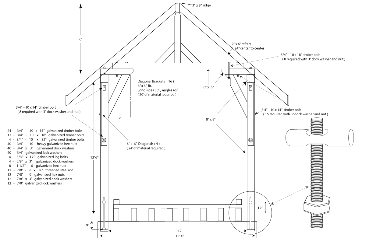

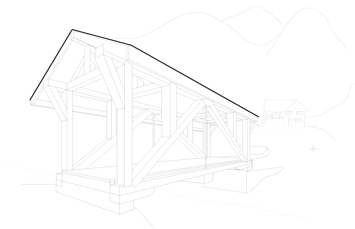

Thanks for the kind responses. As with any sizable project this one started with drawings. I've included two which show some of the anticipated construction details. You'll perhaps notice from the sketches my joinery technique. I didn't want to take the time to do true timber frame connections.

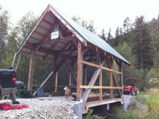

I realized I needed a tractor once I had the trusses up and the bridge deck in place. One of the approaches crosses over a large spring. I suspect I spent as much time moving dirt to build this causeway as I did building and installing the bridge. My Branson 3510 with a sturdy toothbar on the bucket really got a workout.
The bridge supports are made from reinforced concrete. The only requirement the local authorities imposed on my project were that the bridge not adversely affect the the environment of the stream. A helpful fish and wildlife employee assisted me in locating the 100 year flood plain of Toroda Creek. I located the abutment footings well beyond this point.

I appreciate all of your interest in this project. I'll hunt up some of the early construction photos and post them soon. By the way, the small person in the blue jacket is my wife. I may have built this bridge but all of you guys probably know who the real builder is. I named the bridge after her: "Pretty Patti Bridge". She accuses me of being corny but there you go.
