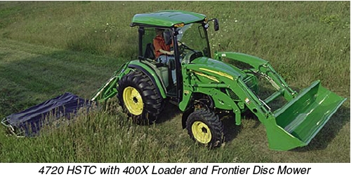

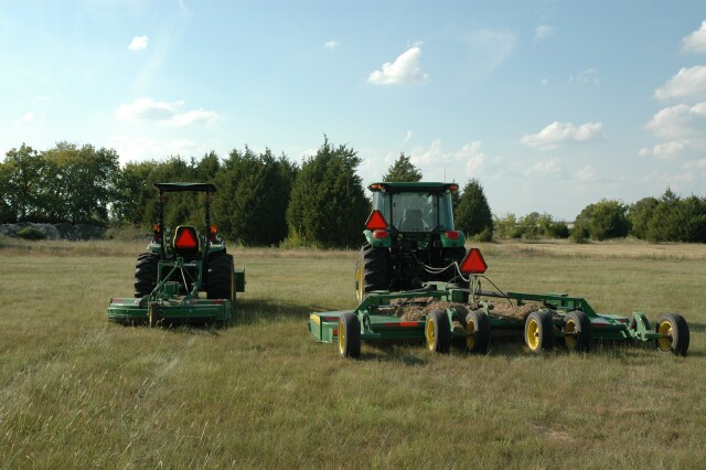

A comparison, first is me on a 4320 and then D.'s 4720 and 5525.
Added: 4720 with cab:
Man, D., that 5525 is a rather healthy tractor, and that HX-15 is one big mower. /forums/images/graemlins/grin.gif

Here is another pic that compares the rears of the 4720 with MX6 and the 5525 with HX15. I ran the MX6 on the 5525 for a week or so. It is nice to be able to move my implements from tractor to tractor. the 5525 with the MX6 will fit on my trailer in case I want to go elsewhere and mow in comfort.
D.
