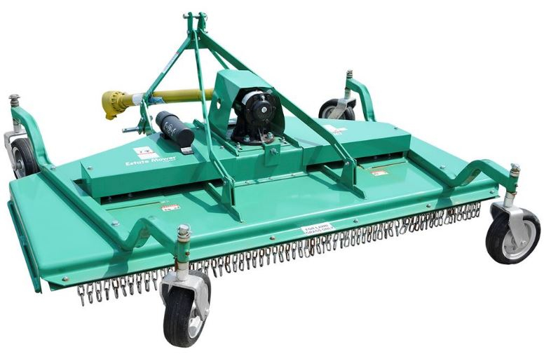

I have a Massey Ferguson 2706e and have been using a 5' finish mower behind it that my dad had sitting around for a while. I am looking to get something bigger/ more appropriate size for the machine so am looking at 7'-8'. I already have a 7' twin spindle rotary cutter i use for rougher uses but am looking for an actual finish mower for finer yard work. I'm not interested in a flail mower. There are several companies out there making a 7' finish mower with pretty much the same design although certainly different build qualities. Here is what I've been comparing and would like to hear others thoughts:

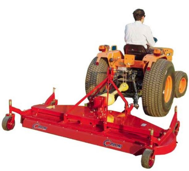

Caroni TC910- 93" cut, $2,900
https://www.agrisupply.com/caroni-estate-mower-rear-discharge-lift-type/p/29234/
This is the outlier to all the other options. It runs 5 blades instead of 3 which means more parts and spindles but parts are very easy to come by and very affordable when needed. Most info i have read on them, people have been very happy and gotten a quality cut and good service life from them.
Agmate 7'- 83" Cut, $3,050
https://www.agrisupply.com/finishing-mower/p/72506/
This is the 7' model Agrisupply carries. Before purchasing this, i would probably look a little harder into Woods, RhinoAg,... all the other locally repped brands since the 7' mowers all tend to be pretty much the same in design.

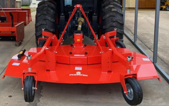

Phoenix M84S- 84" Cut, $3,369
https://www.(Temporarily blocked due to reports of company closure)/Farmtrac-Tractor-Finish-Mower-84-Rear-Discharge-p/far-mower-fin-84-ptorear-m84-s.htm
Again, another 7' mower with very similar design to all the others. People with the Phoenix, Sicma products seem to be very happy with them. I have looked around a bit and part availability does not appear to be very good, atleast from online sources. Any experiences there? I dont want to have to fight to find parts or pay an arm and leg for them when something breaks.

I have the twin to the 5 blade Caroni, and have been using it for about 8 years. It was used when I purchased and I have replaced the blades once and the belts once, and a bearing in one of the idler pulleys, otherwise trouble free. If your model has the nylon idler pulleys, duct tape the top of the pulley to keep the dirt out of the bearings. I have fairly smooth, level ground but I would caution you if you don't, it will scalp, due to the wheels being so far apart. Also, with the small hard wheels, rough ground is going to take a toll on the mower in bent wheel forks and support hangers. It does leave a large and a small windrow in heavier grass.
My neighbor had the Phoenix 84" with the larger hard tires on it. He pulled it behind a TC33D with no problems as far as horsepower. His yard was much less than smooth and if you notice how the wheels are supported from the deck, can you imagine the beating those deck supports took and they eventually bent from the torque from the beating. He took it to a welding shop and they reinforced the deck supports. Otherwise I am not aware of any other issues.

I had the Caroni 92" I think it was. I cut 7 acres for years with it. Bought it new for $1200 and sold it for $500 when I got my Frontier 2120 FM. That Caroni cut really well. It was 5 blade, 2 belt. The only issue I ever had with it was scalping because of the width if you got in the wrong position. Of course I cut really low, propably 1.5". I can't speak to their quality now but the one I had was a good mower. It was just as good when I sold it. The guy still uses it.
I've had the same 84" mower for the past 18+ years with a different name (First Choice, same mower as the Phoenix, made by Sicma)
I had the same issue, the deck supports ( where the wheel arms bolt to the deck) cracked and bent after a few hundred hours.
I welded 1/2" plating on all 4 mount points (never going to bend again)
Overall I like the mower.
Never had any problem getting parts. Parts are easy to get.

I had the 93" Coroni and never had an issue with it. It cut great and did everything I expected of it. I think I put 1set of belts on it and would replace the blades every other year. I ran that thing for 10 years or so. Bought it for $1295 and sold it for $500. Replaced it with a 20' Frontier to cut down on mow time. BTW, the Coroni had built in float which I liked a lot.
