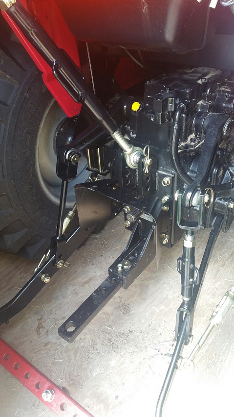

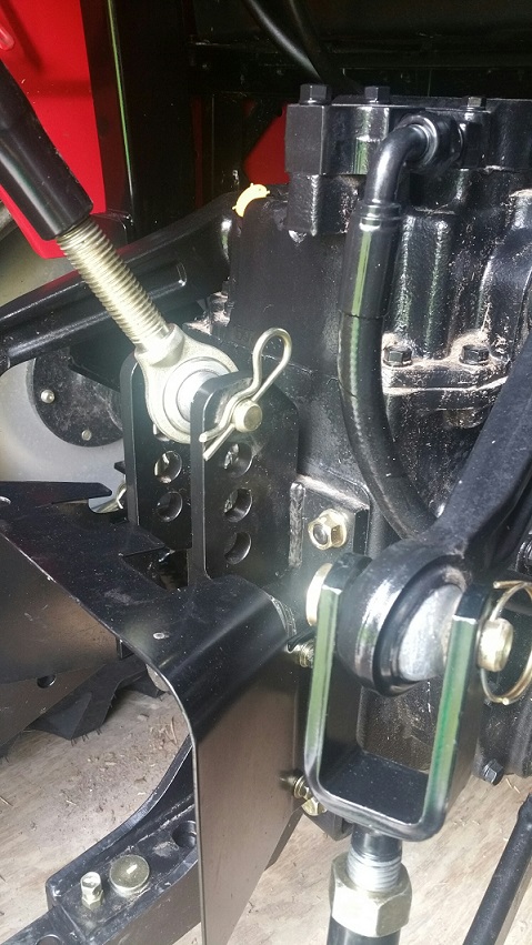

Look at the 3pt hitch on the 2538 and be sure that it will work for you. IT IS NOT what it seems.
   / Comparing 1538 to 2538 is there any reason to choose the 1538? #7
Help me understand what that comment means. I think it's exactly what it seems to be, and functions just same way as the 3pt on my prior Max 25. Is there something specific you are unhappy with? What is it that you feel is missing? Thanks!
I do not have a 2538, but have looked at them extensively and should have one in my yard in the next week or two for proto typing. The top link is only able to be used in the top pin location and have full range of motion. If you do not need full range of motion with an implement, then maybe some of the other locations will work for you, such as a post hole digger.
A lot, if not most people do not use all the different locations, but if you are a person that understands what the pin location differences provide and make use of that, then you are in trouble with the 2538.
Makes no difference to me, just stating a fact that most people including the dealers are not aware of.

Thanks for the feedback. I guess I am not sure how that works. Are you talking about possibly rubbing on the PTO shield if using some weird implement with an extremely low top link connection? That is a minor deal and I highly doubt that would be an issue for me. Sure I have only used a cutter and a box blade, so my experience is limited, but I think I can also use the Landscape rake and Stump grinder I am planning on getting as well. (Even in the lower positions to angle things forward if need be... Now if I had some weird implement with very low top link mount, I suppose it might bump the PTO shroud a bit when using the lowest setting, (because that shroud is huge), but I can't imagine that scenario for my uses. Top links will always go up higher for my uses. And also note that the PTO shroud is notched to allow for use of that lower pin setting.
I THINK I understand the Post Hole Digger comment in that you need the link and PTO shaft to follow the auger down into the dirt. Could that not be a scenario where you use a middle or top hole on the 2538? Or worst case scenario, perhaps this is a money making opportunity for you and you can make a very simple bracket that 2538 owners could buy from you in order to use a one off implement that needed more height for the top pin location? (PM for for address to send royalty checks...) :p
Here are a couple pics. Still not sure why you believe the 2538 is disadvantaged here as it still appears to be exactly what it seems to me at least, but I am willing to learn if you can point me to a few good examples where it might fall short. Thanks!

All I can say is to actually install the top link in each hole and see what it does. The unit that I tried this in was a problem for all but the top pin location. Maybe they have since changed that, I don't know and I doubt it.
   / Comparing 1538 to 2538 is there any reason to choose the 1538? #12
From studying the pictures, it DOES appear that the top link bracket is much lower (relative to the PTO) than other tractors I've looked at. I can see how it might be an issue by being close to rubbing an implement PTO shaft but I can also attest from personal experience that a top link bracket that it too high or low can cause issues as the implement is raised or lowered. I have a 3 point fork carrier and with the top link being very high, the tips of the forks will be pointing up when the carrier is lowered to the ground and the tips point down when the carrier is raised fully.
