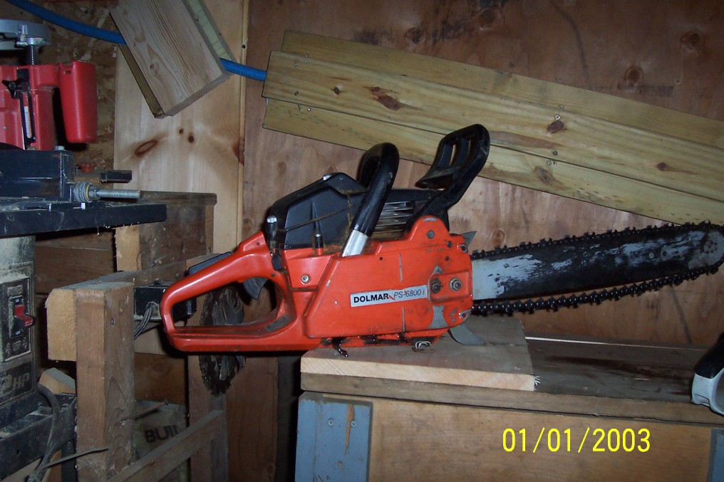

yep i know the chains loose:)sitting next to my 028 similar weight 3 times the power

Yep, looks identical in everyway to the 120si.
I was actually going to as if it was a 6800i. Cause I dont think the made just a 6800.
The I stands for injection carb. Meaning it doesnt have a choke butterfly. Rather the 1/2 twist knob opens a enrichening jet on the carb to directly dump a little more fuel. Kinda like some of the motorcycles of the 80's.
That is the easiest way to tell a regular 120 and 120super appart from a 120si.

oops Yes mine does have an i. Is the one in the middle a 6800 it has a flatter cover and looks like mine.Are the two on the left HUSKYS?

No the one in the middle is the 120si. Which is the same as the 6800i, but the 120si is the older model # designation.
And no the two saws on the left are both dolmar 7900's. The two on the right are husky's though. A 266se and a 136.
