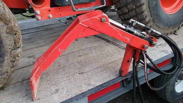

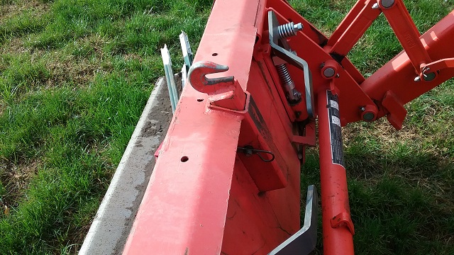

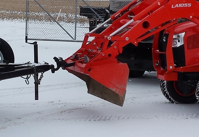

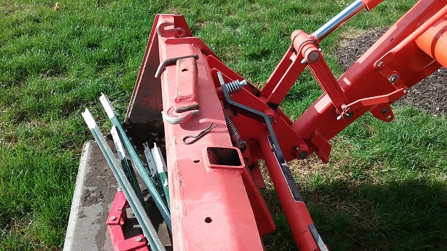

Hi all. This spring i made some modifications to a kubota tractor bucket that turned out to work pretty well. The grapple was just scrap steel and cylinders that were sitting around because i didnt want to spend any money on it. Im probably going to build an expanded metal spill guard for snow removal and ive got a few other style hooks and rings laying around. The bucket i used was originally off a L3540 that i extended the cutting edge on but when we traded up to an L6060 i kept it. i just figured i'd share the idea.

We need one more photo in the series.. The one showing how far can the grapple arm open.
   / compact tractor bucket with removable grapple and other accessories
I'll try to take one monday. It opens about 90 degrees.

Turns out i had one.

Agreed, very good idea using a receiver hitch.
