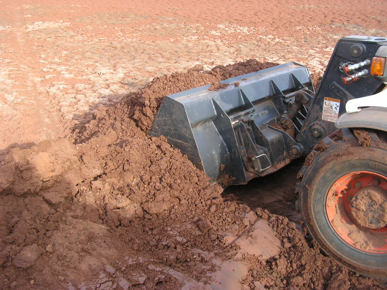

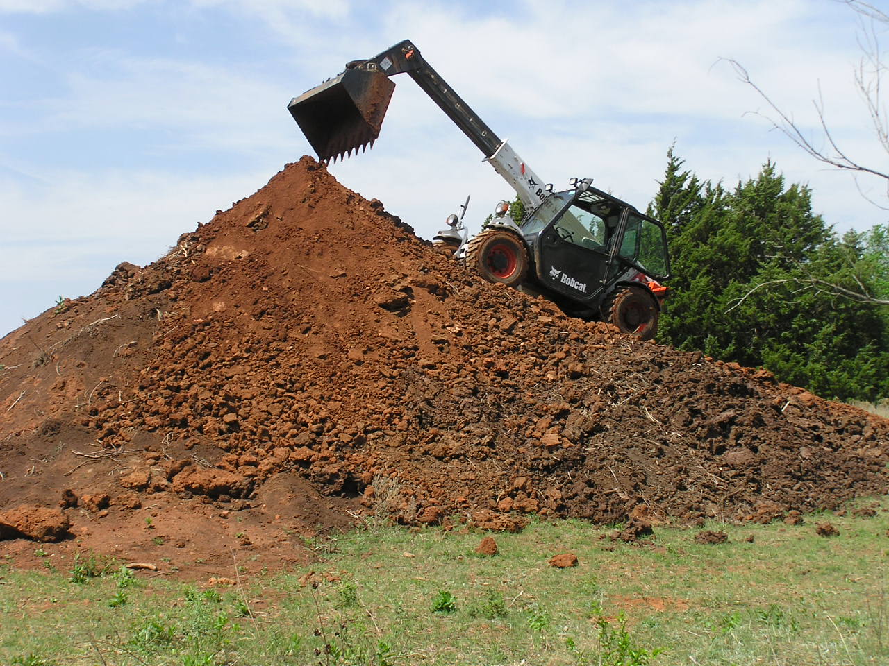

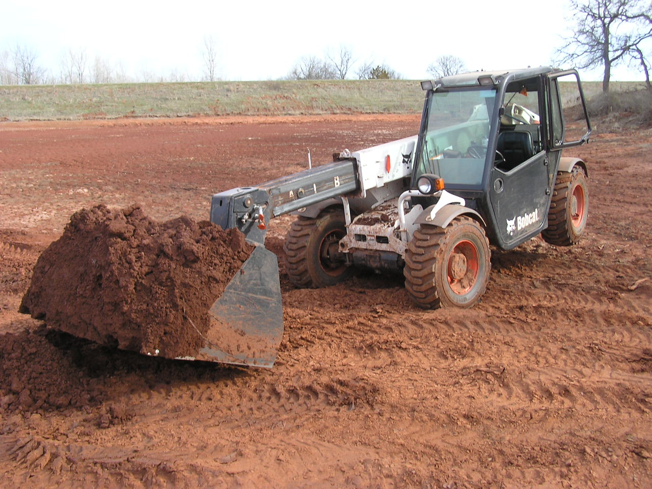

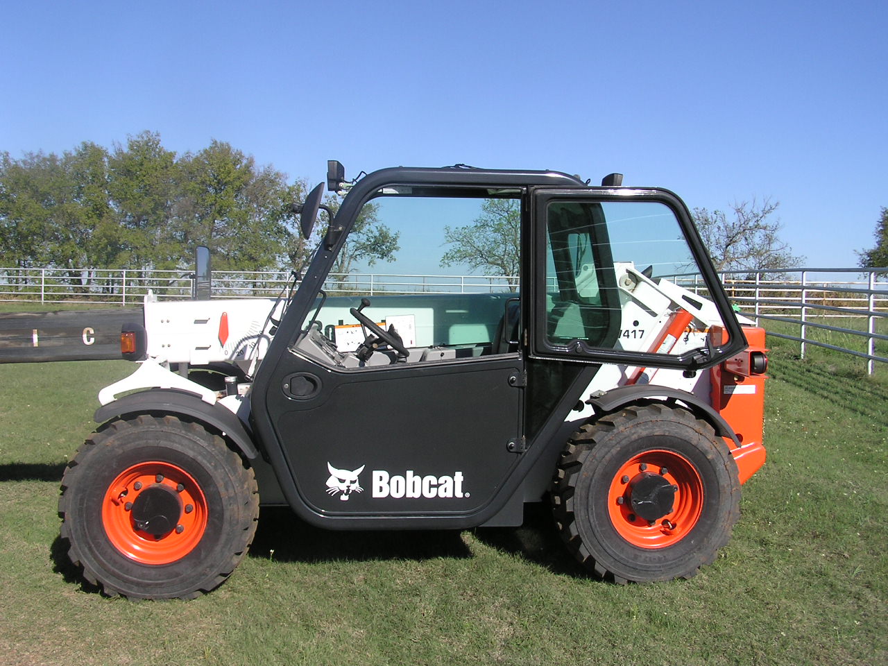

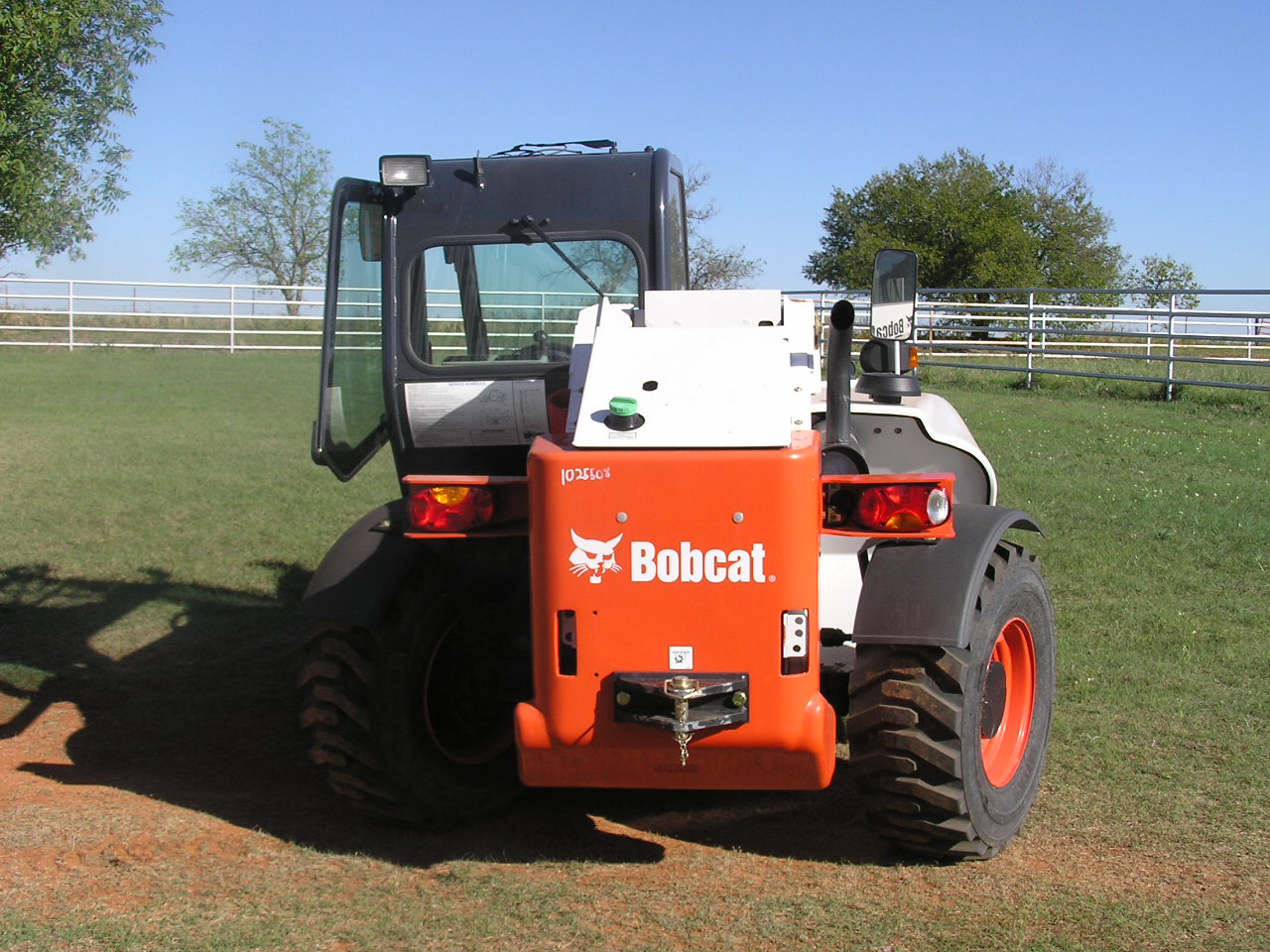

There is one other machine you should consider, a Compact Telehandler.

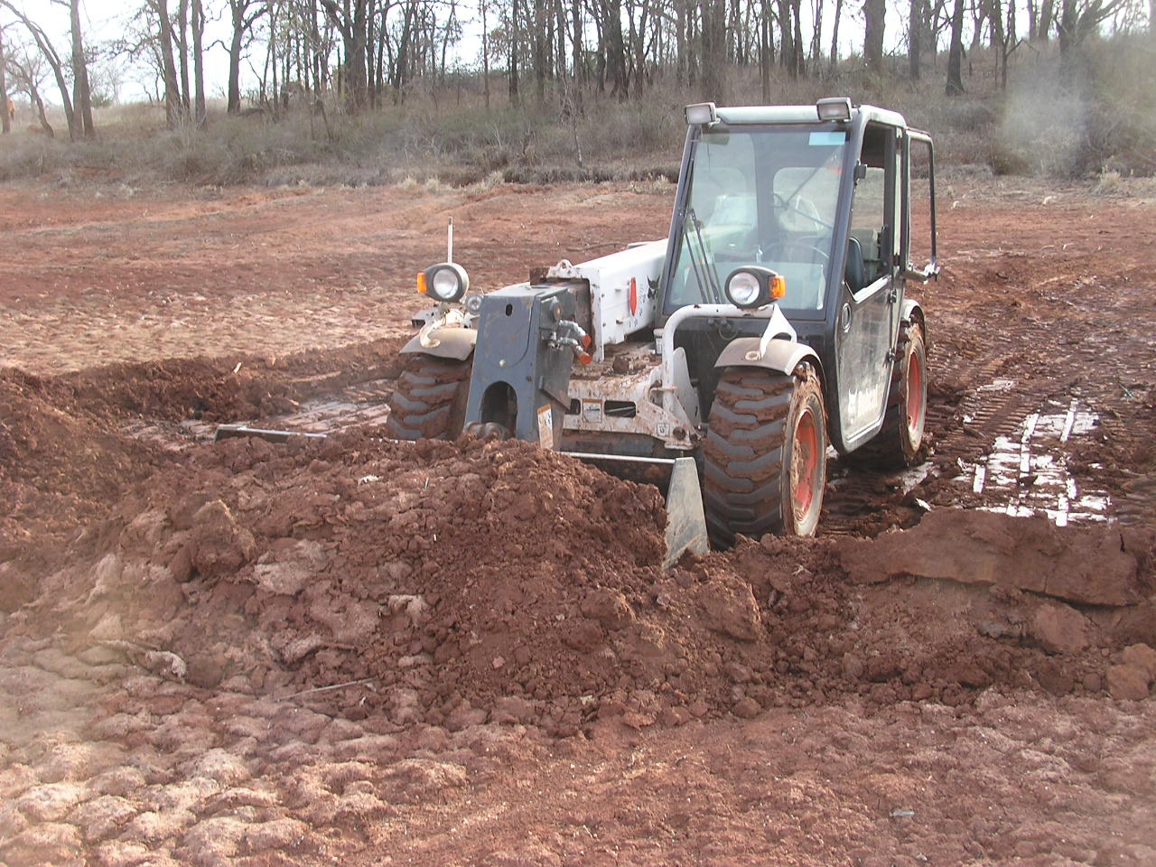

You mentioned moving dirt, it excels at that with the 6' wide 1 cubic yard bucket.

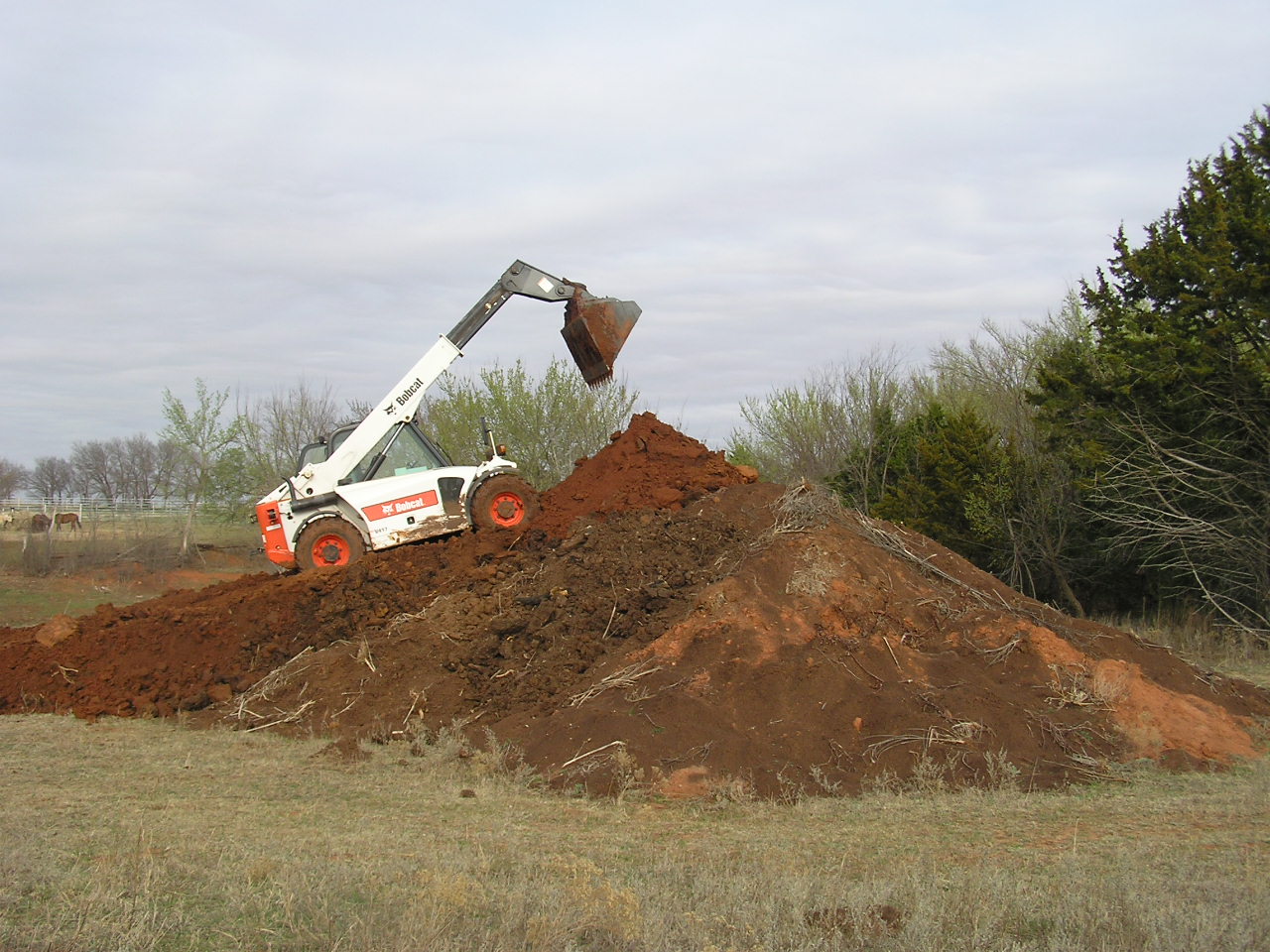

I compared it directly with a rubber tracked Bobcat T300, with this bucket in shale and hard red clay. The T300 struggled to fill the bucket, spinning the tracks, while the V417 filled it easily in the same pit.

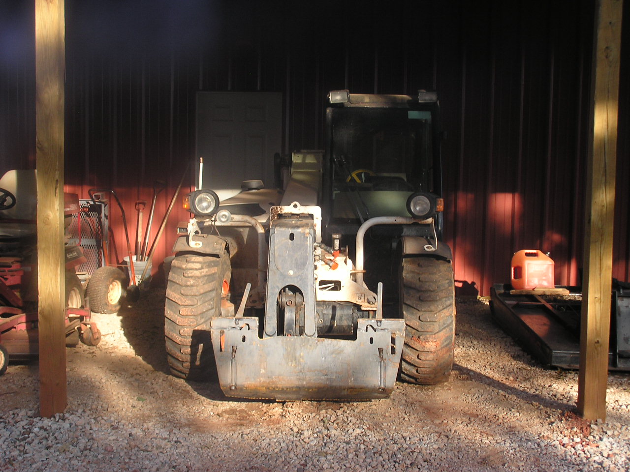

It is 6' wide, 6.5' high and 13' long. Tire size is 14x17.5. Top speed is 15.5 mph, drawbar pull is 7,000 pounds and it will lift over 5,000 pounds! Has a standard SSQA plate and aux hydraulics on the boom.

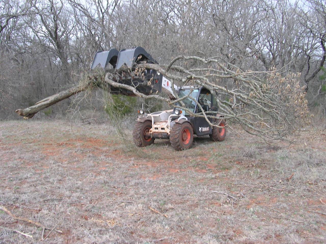

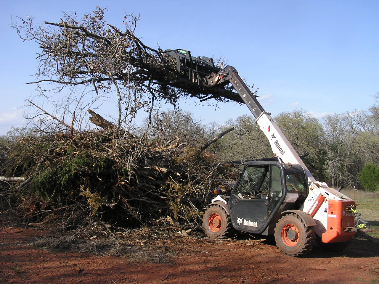

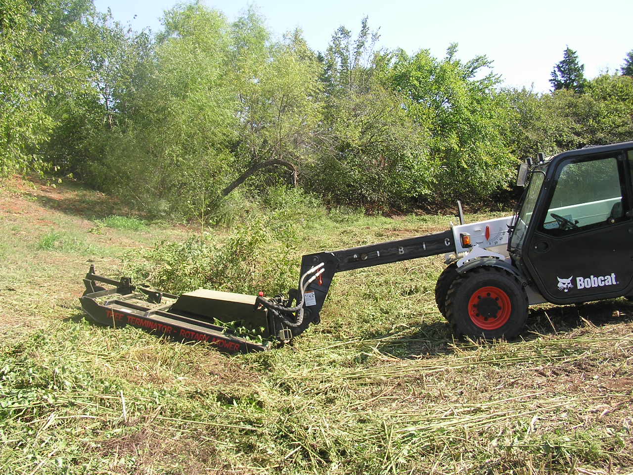

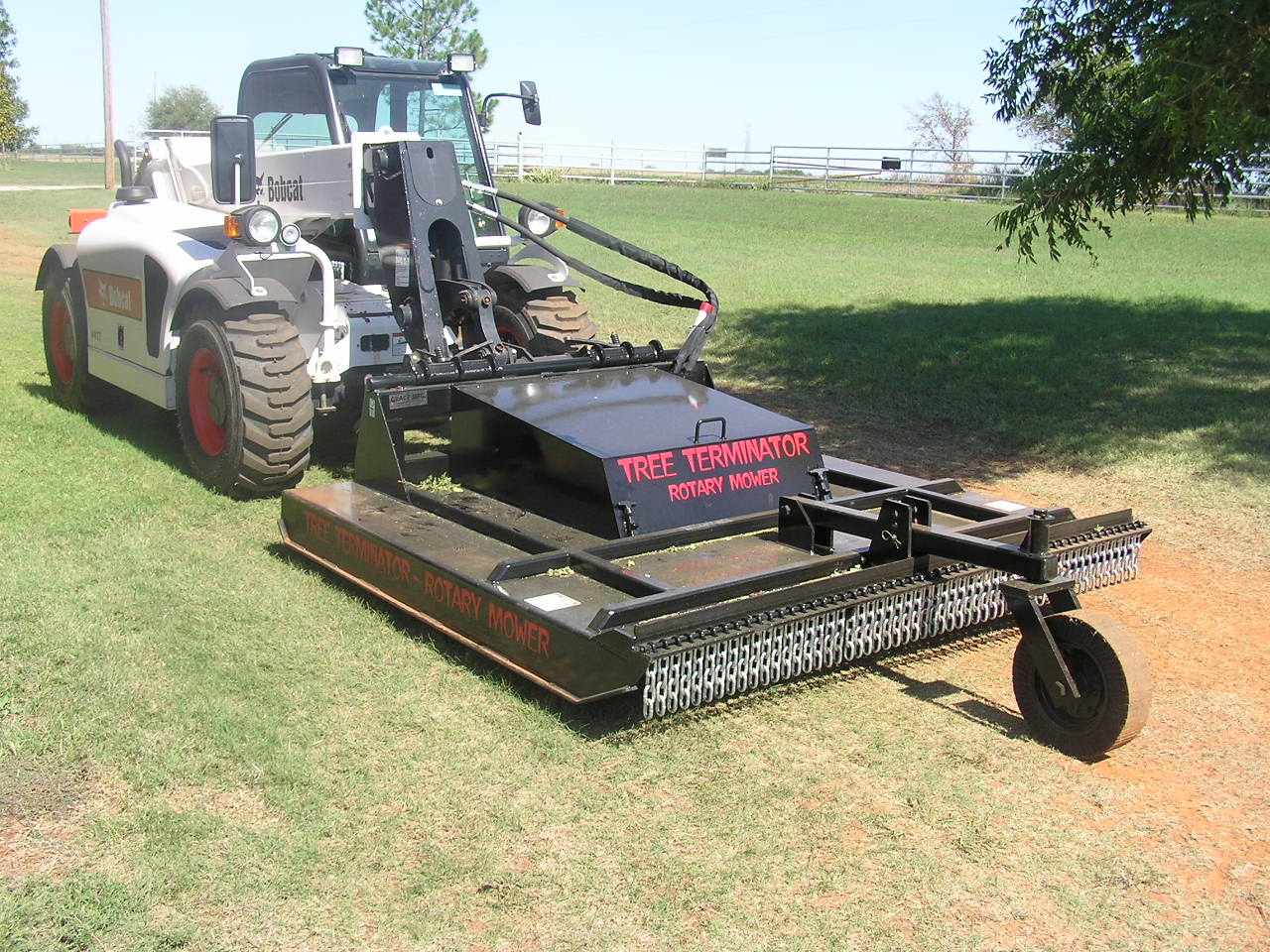

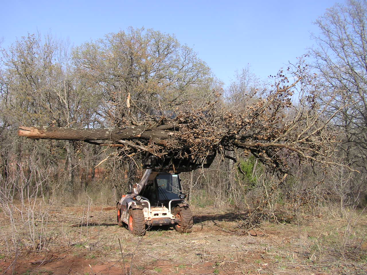

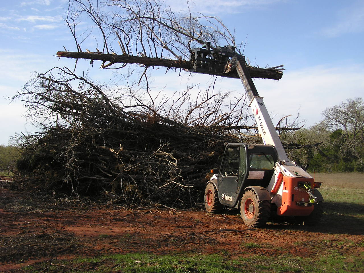

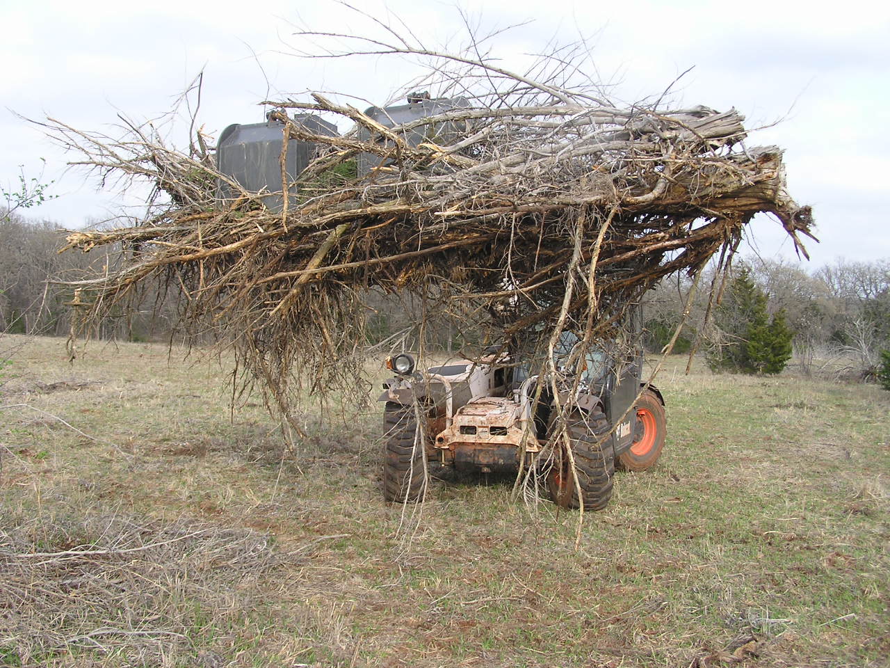

It also excels at moving brush and making big brush piles.
If you get a compact telehandler, you will probably sell your tractor, that is what I did. :thumbsup:
