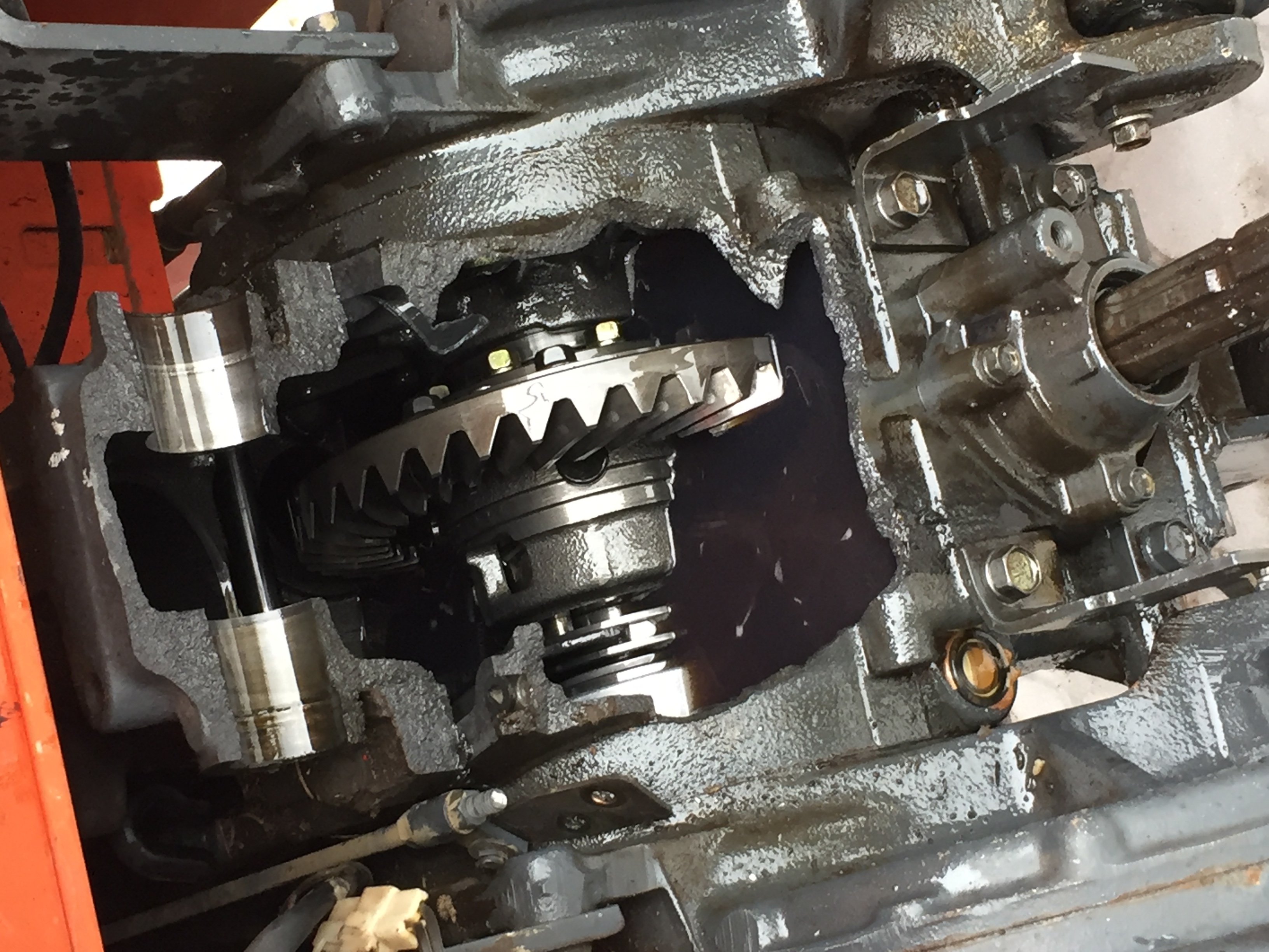

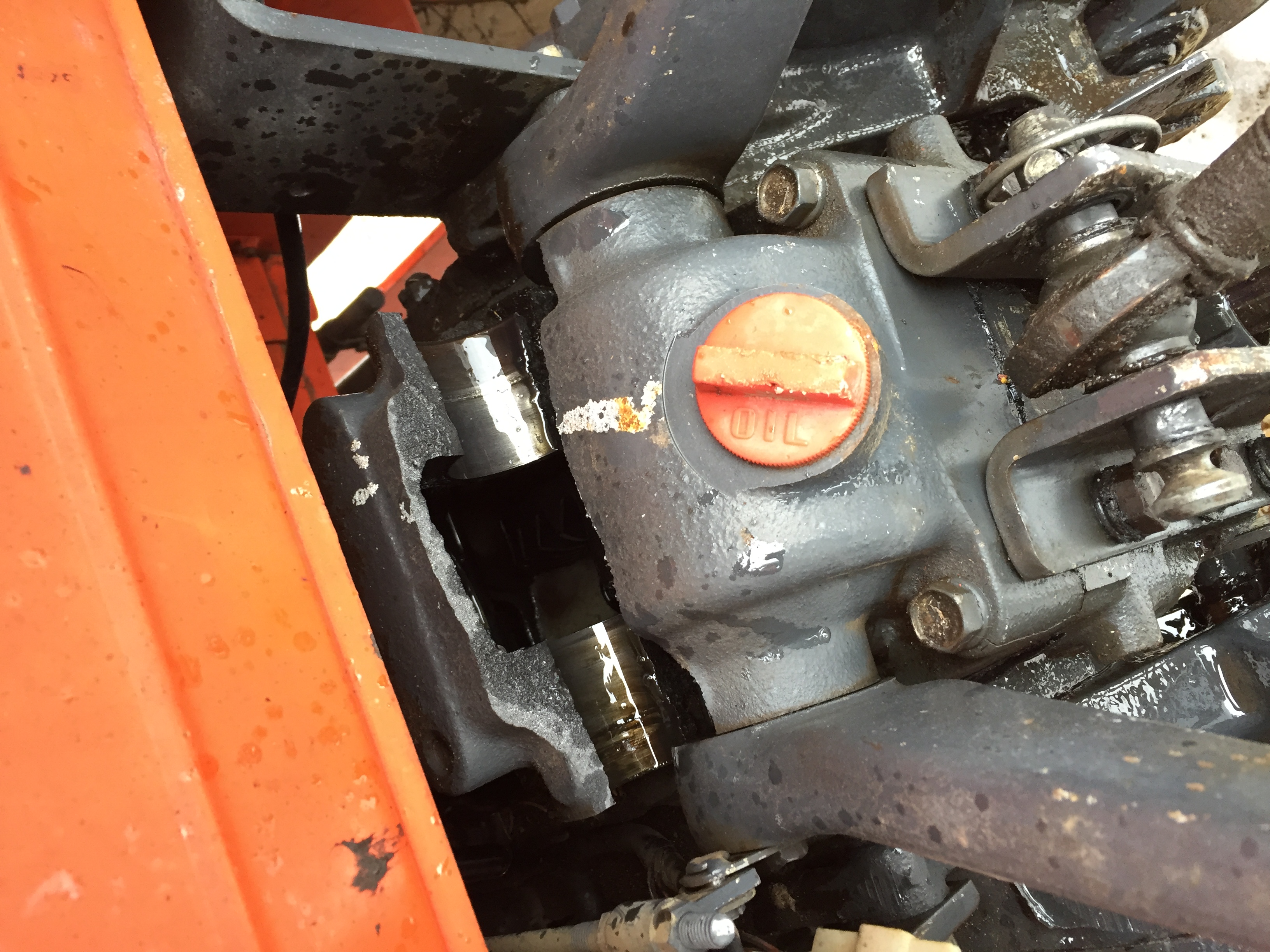

I'm hoping that those of you with much more tractor knowledge than me can steer me in the right direction.
I currently have an older Kubota L4310HST that recently had a catastrophic failure (see pics and http://www.tractorbynet.com/forums/parts-repairs/353439-l4310hst-air-cooled-transmission.html).
So, I am undecided on what to do.
1. Buy a new top plate and have the bottom piece welded.
2. Buy all new parts and have a dealer replace them.
3. Trade it in as-is and buy a new tractor.
I'm leaning towards option 3 mainly due to it being the option that will make my life easiest.

I would guess around 24 man-hours to repair plus expensive parts. Might want to consider parting it out and apply that to a new or used replacement.
As Messicks stated not worth much if anything as a trade-in.
Repair it yourself would be cost effective and take a weekend of work if you have a service manual.
Could try and locate a wrecked one and get the trans from there.

There is no doubt in my mind that my father-in-law could weld that up for you, unfortunately he's dead. You need to find a crazy old mechanic/welder who works cheap and fixes up incredibly broken machinery really well.
I think part of the key to making the welded parts strong enough not to break again, will be to reinforce the welded seams with steel plates and some form of structure that will reduce stress on the welds and transfer that stress to something that is still solid on the tractor. That is what I did with a broken bell housing on my tractor, the only reason it hasn't broken again in the same place is because of the steel plates and threaded rods that I installed on it to hold the whole thing together better than original.
You have at least 2 separate castings broken there, you are going to need to separate those castings and facilitate the welding repairs to each casting independent of the other. On the up side, you can weld the smaller easier to remove part first and then examine your welding results to determine if it is going to work or fail when you do the larger one. Try some Nickel rod, that is the only thing that worked on mine.
Best luck to you on the repairs

Am I the only one that is curious to know "HOW" did that happen?
No, you're not. That's part of the reason I'm considering parting ways with this tractor.
I can find the upper piece used for about $300, new is just over $700. The lower piece I can only find used for $1237. The issue for me is that I don't have the time to replace these parts and the labor to have someone else do it will be at least as much as the cost of the parts. I thought about trying to get just the lower part welded since it doesn't really see any load (I don't think?) and replace the upper part with the used piece, but...I still don't know what caused it and therefore can't say it won't happen again.
