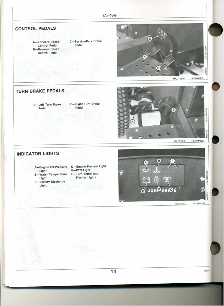

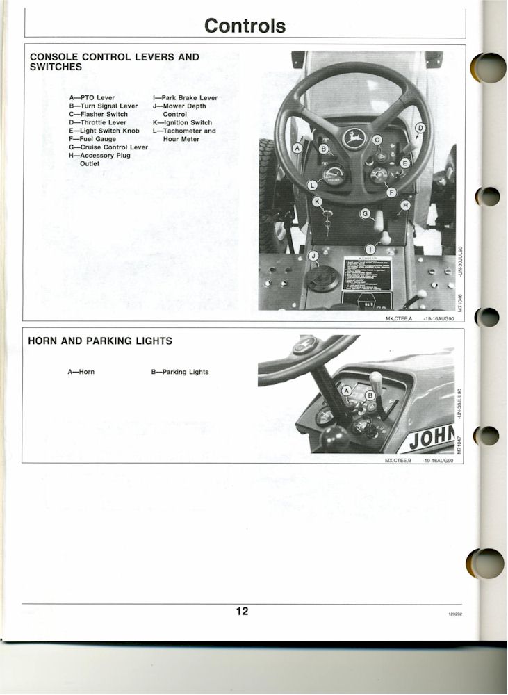

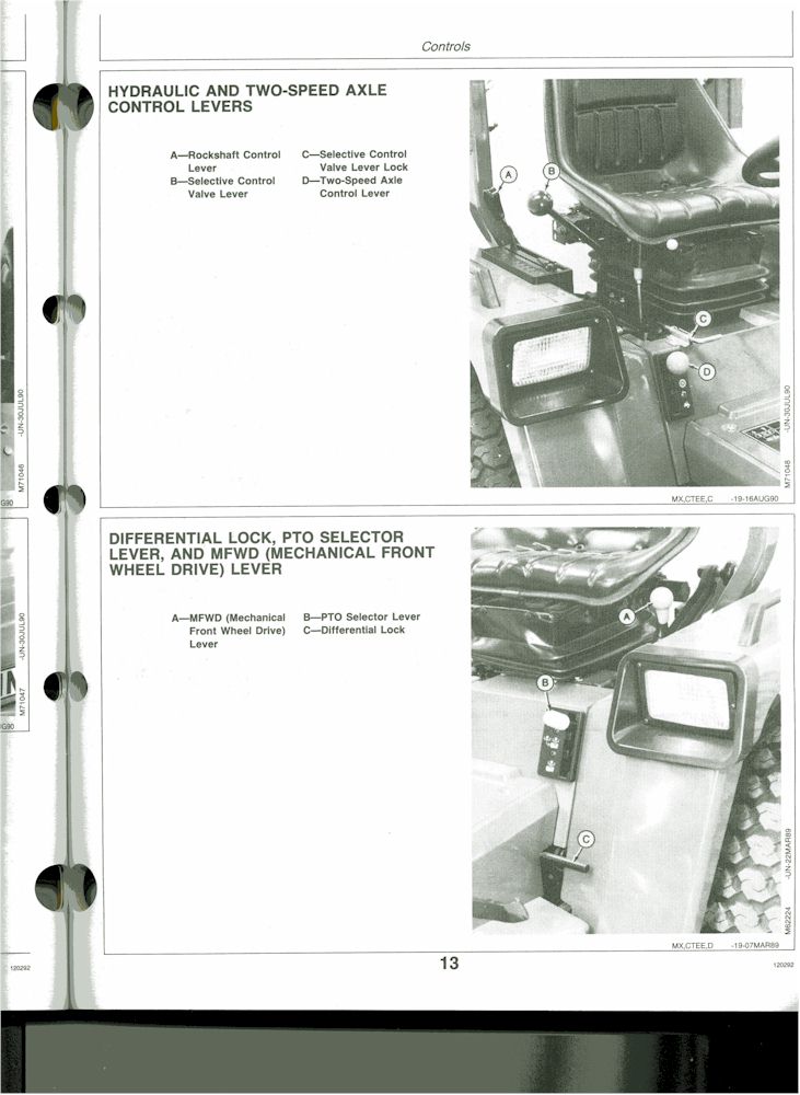

My first post on what looks like a great site.I'm in the uk have aquired a jd 855 compact about 1998...have no idea what all the levers etc do!!! Has any one an operators manual they could scan a couple of pages to me mainly of the controls.I have a new copy of the shop manual which is no use to me (I'm no mechanic) which I would willingly swop for a copy of the operators manual.Any help would be appreciated.

Here are three pages from the manual for the European version of the 855 to get you started. USA owners will notice several differences from their tractors such as the horn, lights, and seat.
Welcome to TBN and enjoy your tractor!

thanks for the welcome Henri88 and what a star jd755 many many thanks
