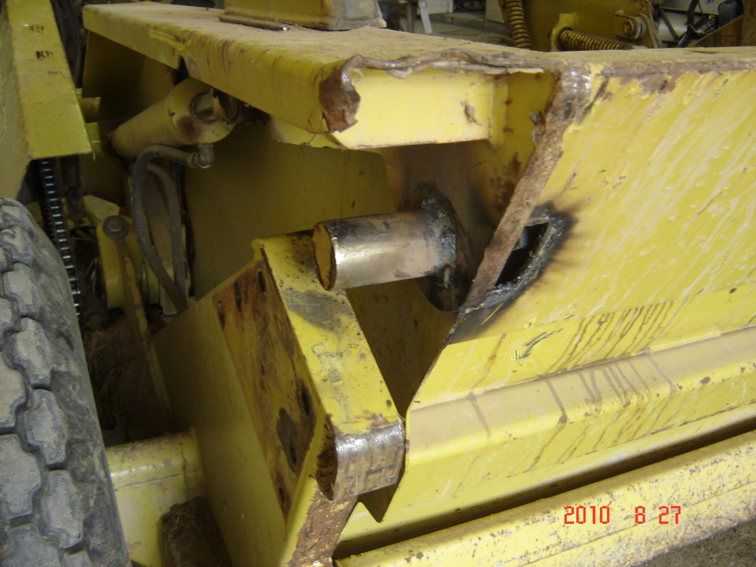

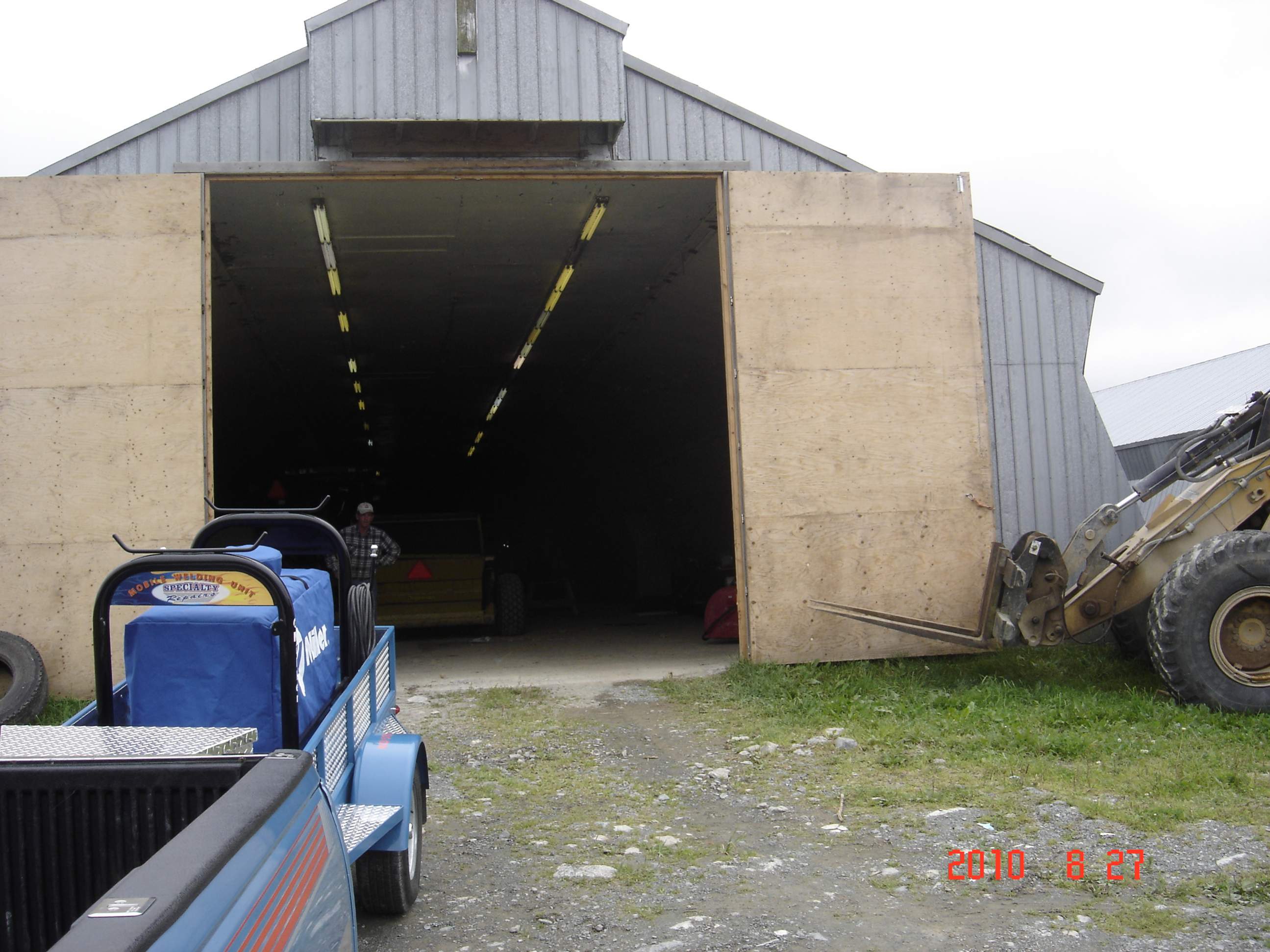

We got to head out to the farm and weld a pin on a rock picker. I'll even let you look out the window on the way. Never mind the boys there. They get a little camera shy :laughing: There's 12 pics so please be patient :D

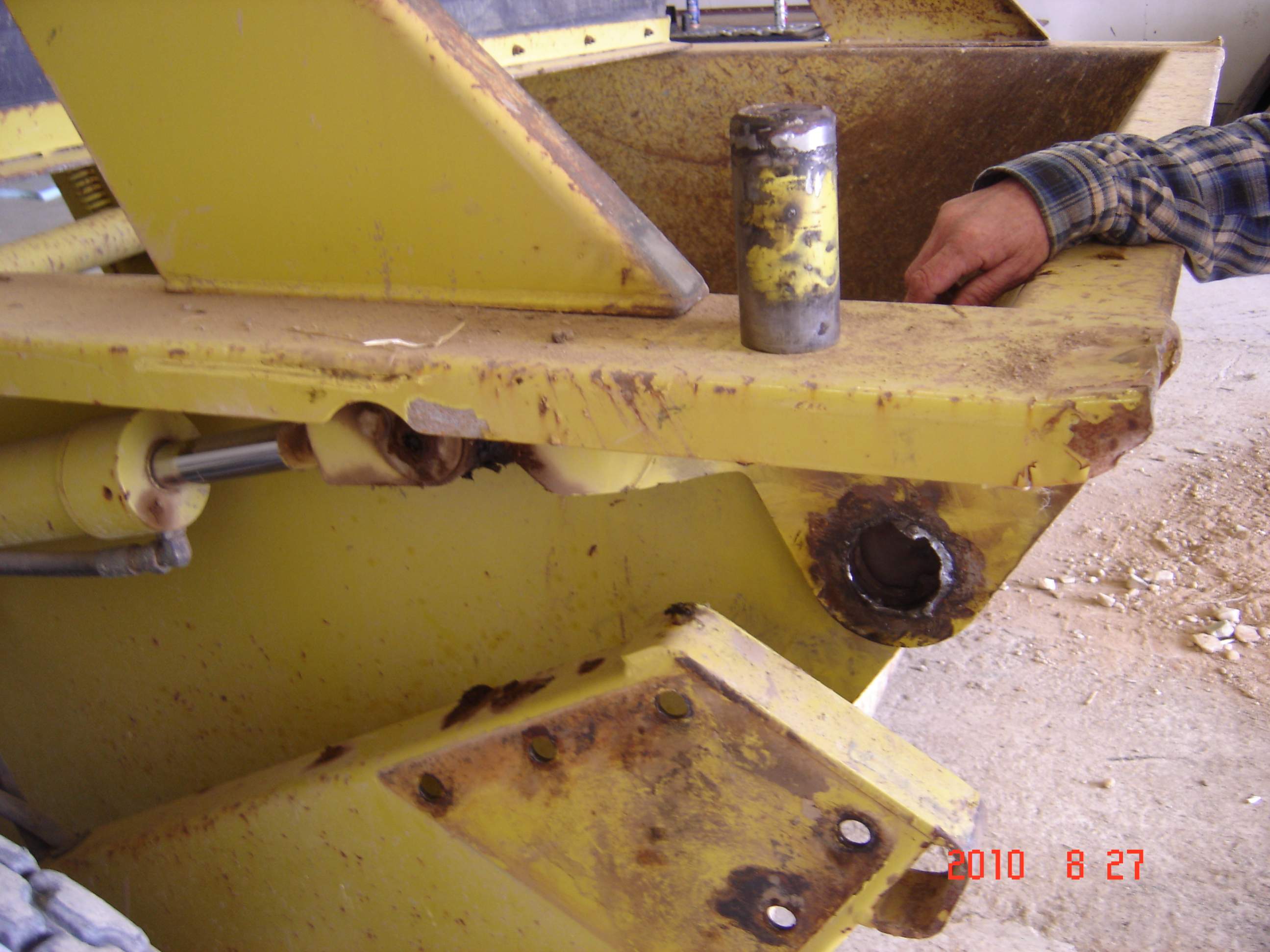

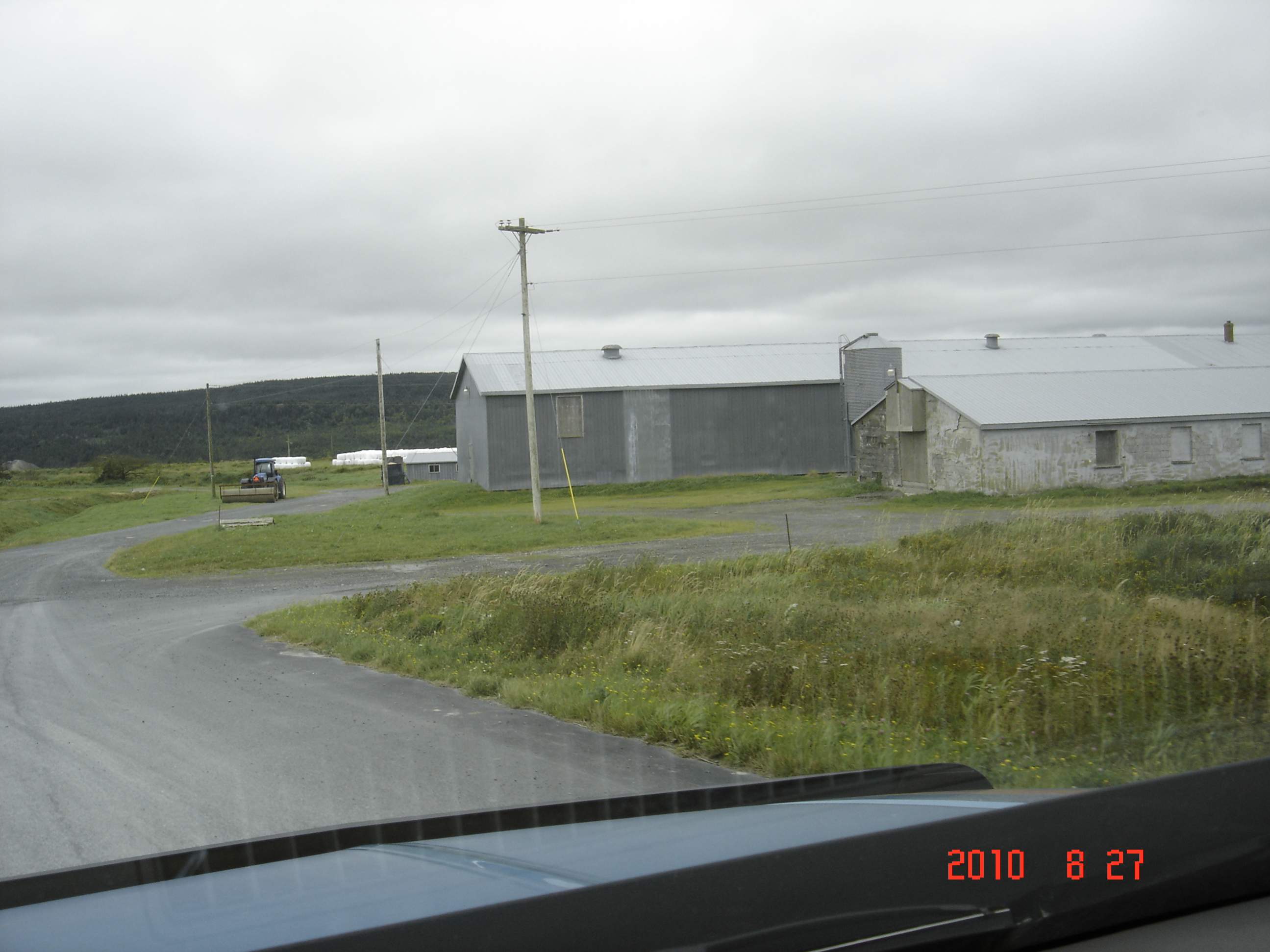

Ok we're there so let get'er done and head back to the shop. :)

4shorts:
In the last picture did you have to cut out the rectangular hole to access and weld the pin from the backside?
If so, did the pin get welded all the way around through the hole or was there open access to the other side?
Don't see how you could weld all around through that opening (but then, you do wonders).

4shorts:
. Yes I had to cut out that area to gain access to the rear portion of the pin. I did manage to weld all around it and I used the long portion of the welding rod to get at the far most portion of the pin and when the rod got shorter I used it on the closest side of the pin. Hey what ever works hey  thanks for your comments guys.
