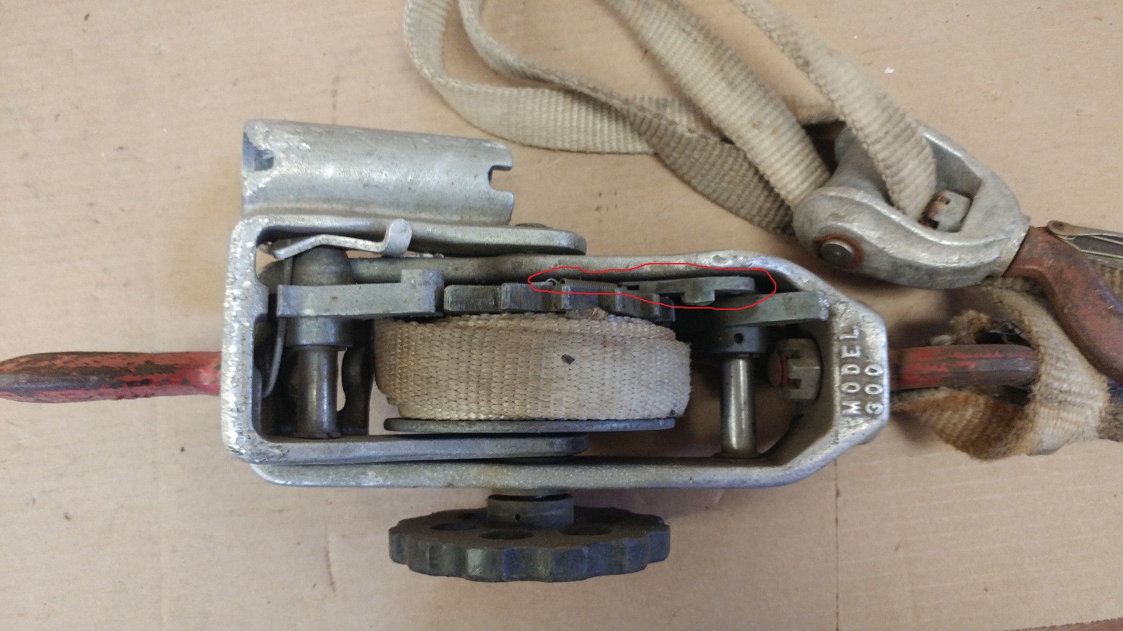

Need some help here. The C clip came off the lower pawl shaft of my aluminum bodied come-a-long. And now I can't get it working again. There is one spring still there and I think another is lost. Anybody have some close up photos of thiers? For the life of me I can't remember what the configuration looks like. The lower pawl holds the load when getting another stroke and also is the auto release when lowering a load. I have looked everywhere online with no luck. Mine is a Cadillac 4000 pound model. Looks similar to Little Mule 250A 1/2 Ton x 9 ft Lineman's Strap Hoist - #04190W but mine is cable and I can't see enough detail. Thanks

Found a photo that I can almost see, The item circled in RED is what I am missing.
That would be "PAWL ASSY. 20G REPLACES 20, 220, AND 320", from the parts link.
Maybe Little Mule bought out Cadillac.

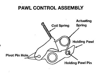

Parts ordered and found a manual with the following illustration/ instructions.
/ Come-a-long repair
Got all the parts assembled and it works great! I also ordered a new cable from ziplinegear.com
