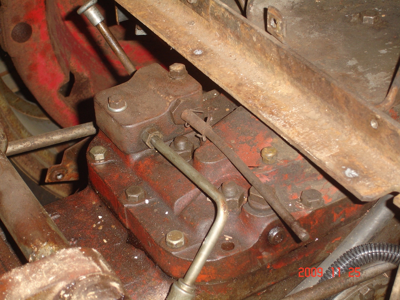

On my 180, the combining valve, combines the output of both the main and aux. pump. to one of the aux. control outlets. I've been wondering what this was on mine this week also. Found some info on another Massey site, so passing it on...
I've included a copy of a Massey Aux hyd's manual ( please excuse the pictures, they aren't very plain.) You will need Adobe Reader to see the book. Scroll to page 19, and it gives a description and purpose of the valve.
I've also included a picture of the combining valve on my 180, I have torn down in my shop at the moment.
The part # for the valve on my 180 is 513246M91, according to the AGCO Partsbook. And it only shows it on the Western Model, on page 272, of the 180 parts list.
Here is also the link to the AGCO Partsbook, if you don't happen to have it.
AGCO Parts Books
You'll have to look up your particular model, and search for the valve. Mine was listed under the "differential cover and combining valve (Western)"

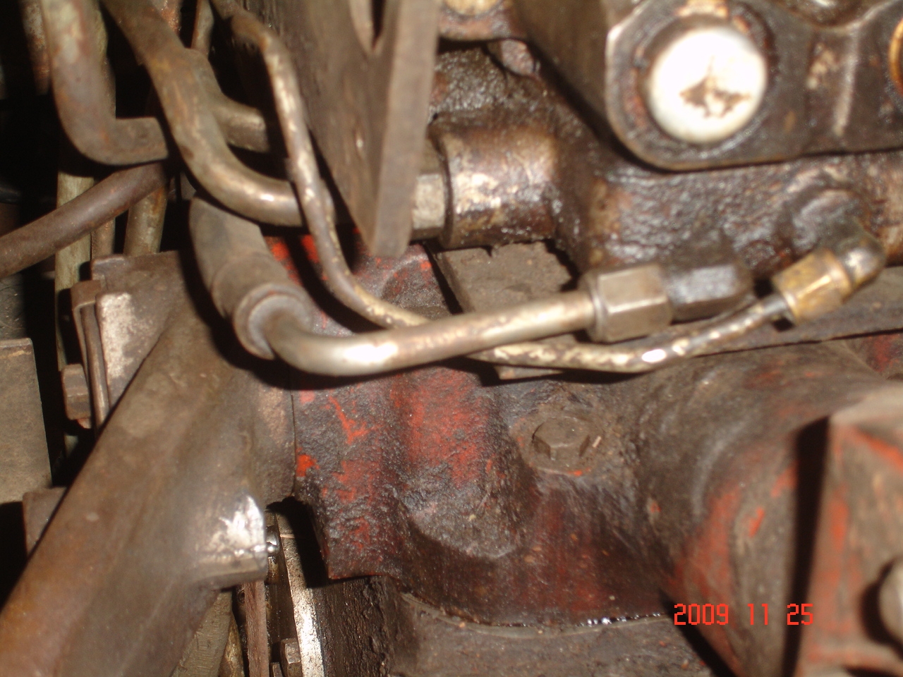

thanks for the info DJ54, can you tell me where all the pipes coming into that block are coming from?

I'm attaching a picture of where that line coming out of the block runs to on my 180. It would be the bottom line on the left. That would be the bottom portion of the 2 spool aux. control valves.
I took the liberty of looking up the 35x, and the plate on the left side where my 180 supply line from the Aux. pump comes through, Is where your PTO lever is. And I'm not even sure yours has a pressure port like my 180. The 35x pump does show some sort of valve there. It would take someone with a lot more knowledge of these tractors than I do. This is my first Massey... I'm more familiar with older IH tractors, so this is a learning experience for me too.
It may be more feasible for you to consider maybe a front mount pump, to supply a higher volume to your remotes. But that is only my opinion...
Of course you may want to study various MF tractors with multi-power on the AGCO partbook site, and compare.
