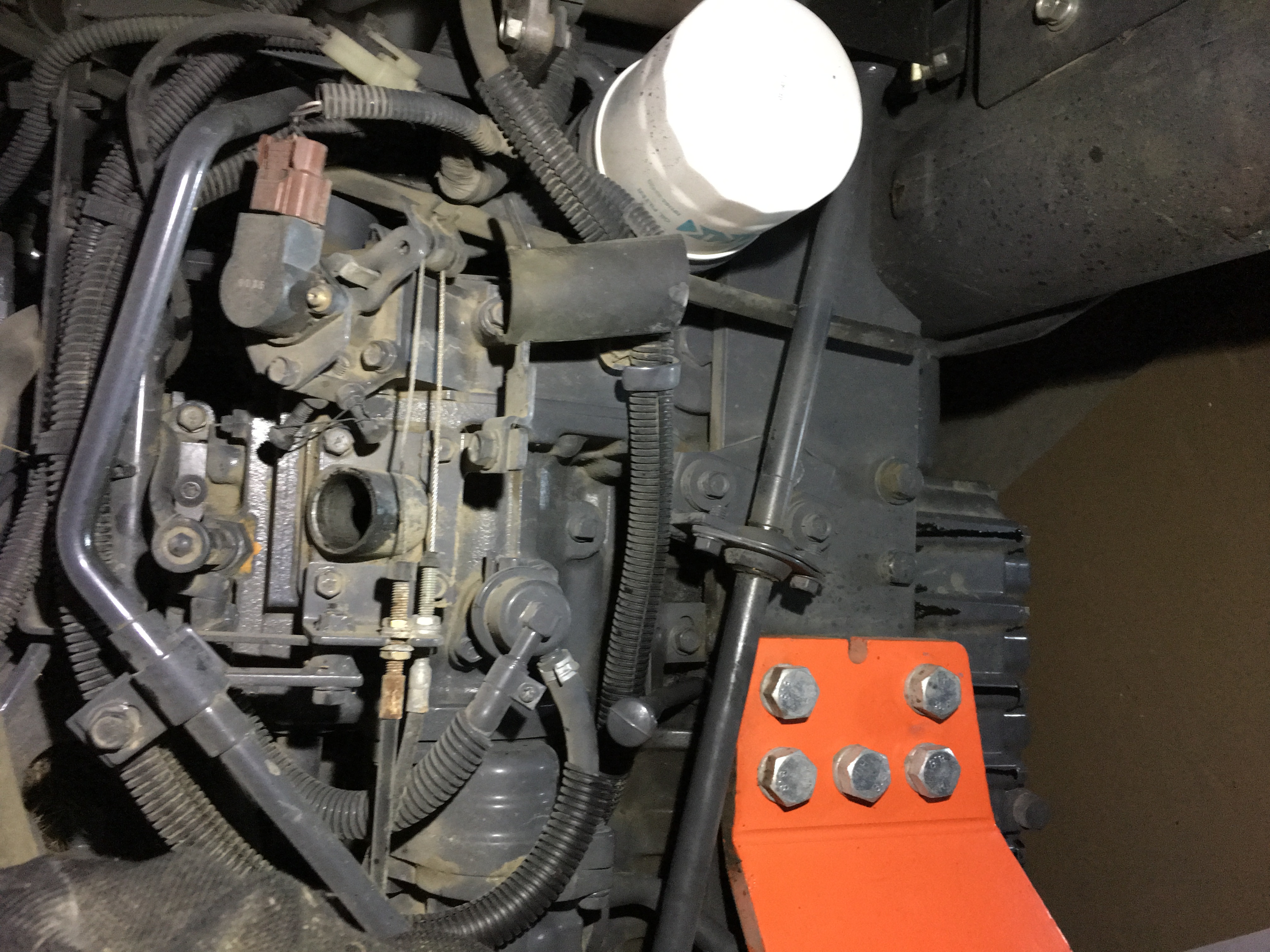

Thank you guys so much for the help, I should have joined this a long time ago. I’ll see if I can post a picture here of my oil fill hole, before I found the fill cap and put it back in. Is the PVC valve body in this pic?
   / Cold weather tractor problem
As far as the amount of oil coming out of the exhaust, I think a small amount. When I noticed oil leaking under the tractor, there was no oil on the exhaust tip, or below it. It wasn’t until after I went back into the barn a while later, that I noticed maybe 10 to 15 trips worth had come out, while the engine was off.

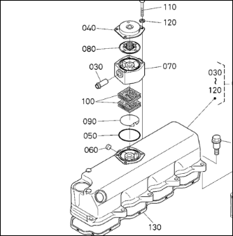

   / Cold weather tractor problem #9
Jesse
Engine crankcase breather is located on the top of valve cover.
   / Cold weather tractor problem #10
Jesse
Thanks for posting the picture, Jim. That should be it. Jesse, do you have part that on your motor?
BTW, in my parts manual the hose connection part 030 is listed as a "pipe, water return" which was either a case of amazing prescience on the part of the illustrator or more likely a (deliberate?) mistake.
The tube carries vapor, not water, and connects to the intake side of the turbo where it is designed to scavange oil and water vapor via the PCV valve (note to self: PCV; not PVC !!) and reburn those vapors in the engine. Thus complying with one part of the interim tier IV emissions requirements while either missing or ignoring the point of the regulations in the first place.
The PCV system is not mentioned by name in the parts manual; although you can find that picture that Jim posted on the page for the "head cover" i.e. the valve cover. Where the PCV valve assembly should be called out in the parts below the illustration is an oddity: an unusual blank entry. Nor is there any mention of the PCV breather assembly in the otherwise very complete engine section of the work shop manual.
So I think we are on our own here. Luckily the illustration does show a very nice exploded view of all the parts and that valve looks easy enough to take apart, clean, and/or modify.
There are enough of those interim Tier IV motors out there that we ought to just go ahead fix the problem. Any ideas? One way would be to get a slight amount of heat to the PCV valve. There's a handy hot exhaust pipe nearby.
