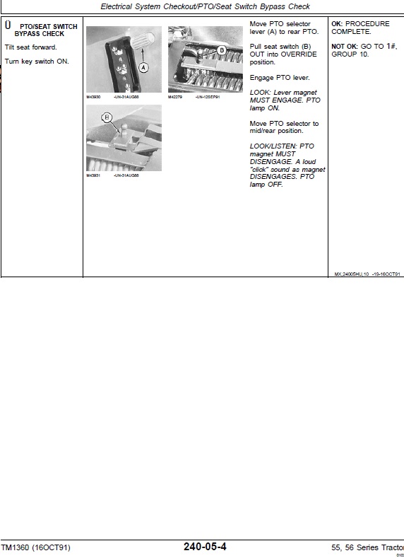

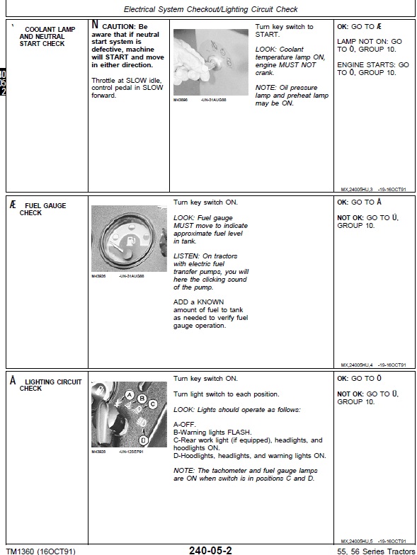

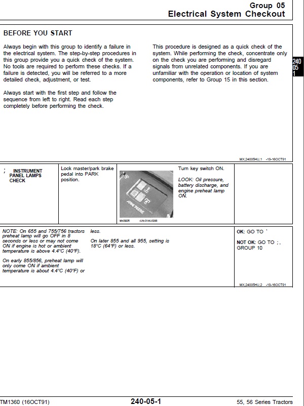

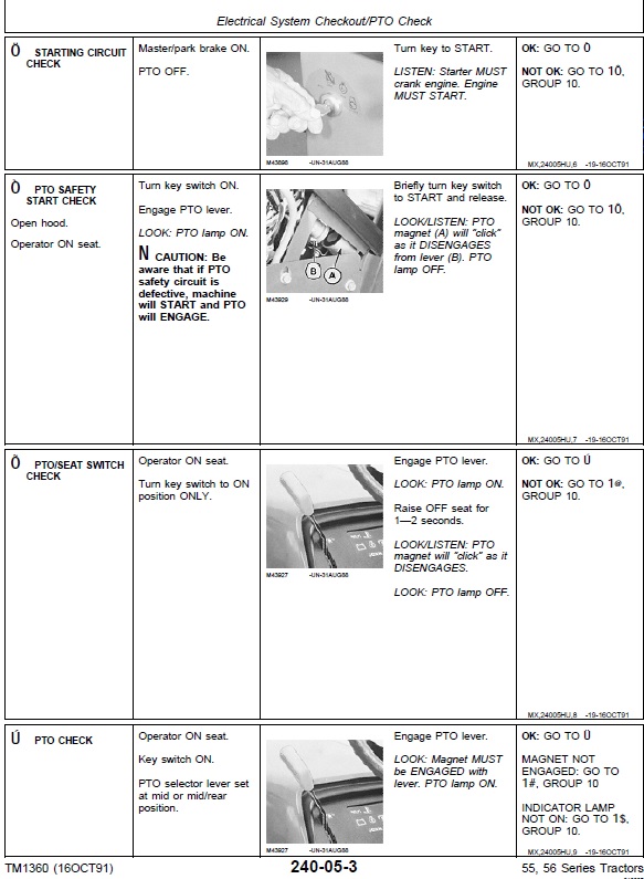

Electrical problem.. Maybe checking out some things in the service tech manual will help.
